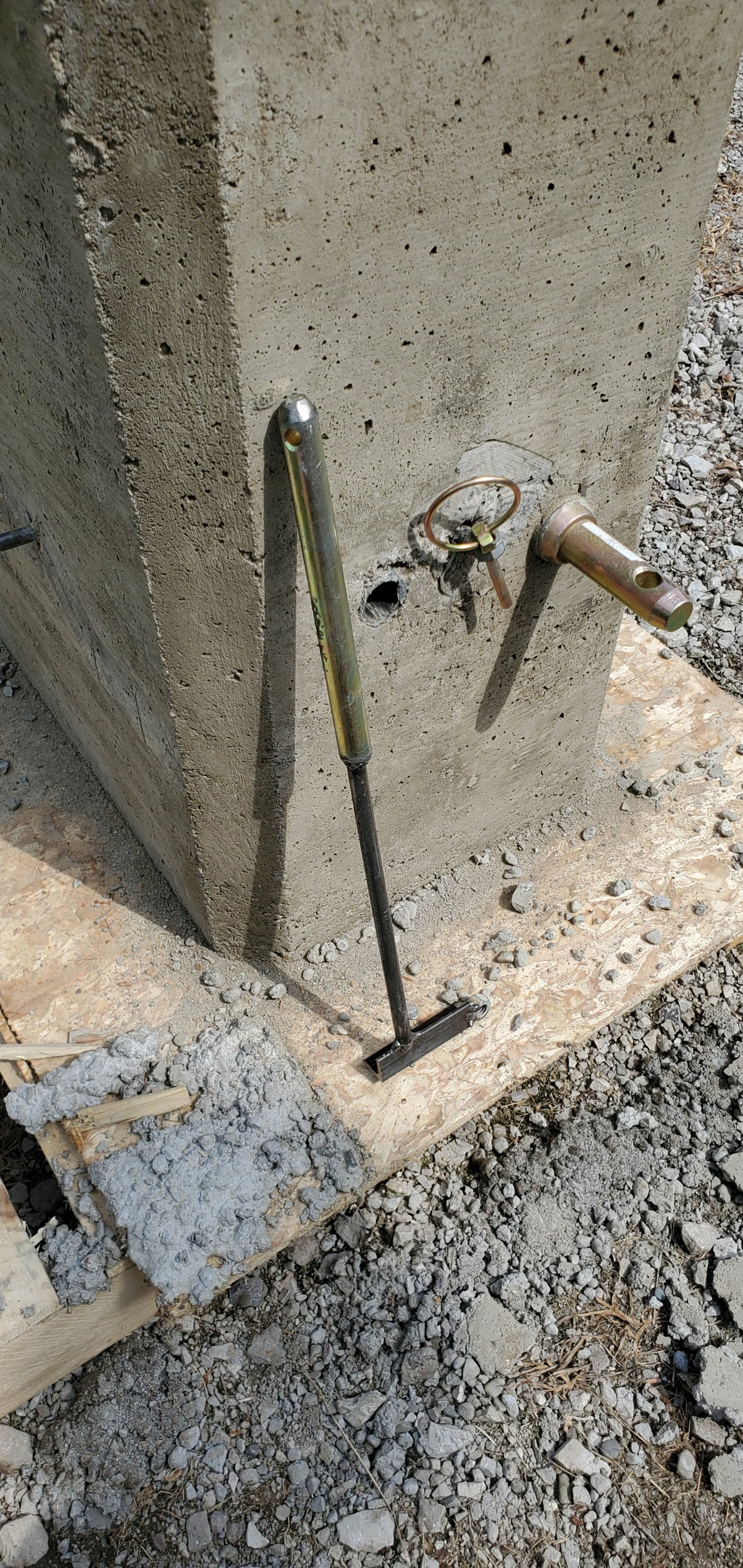

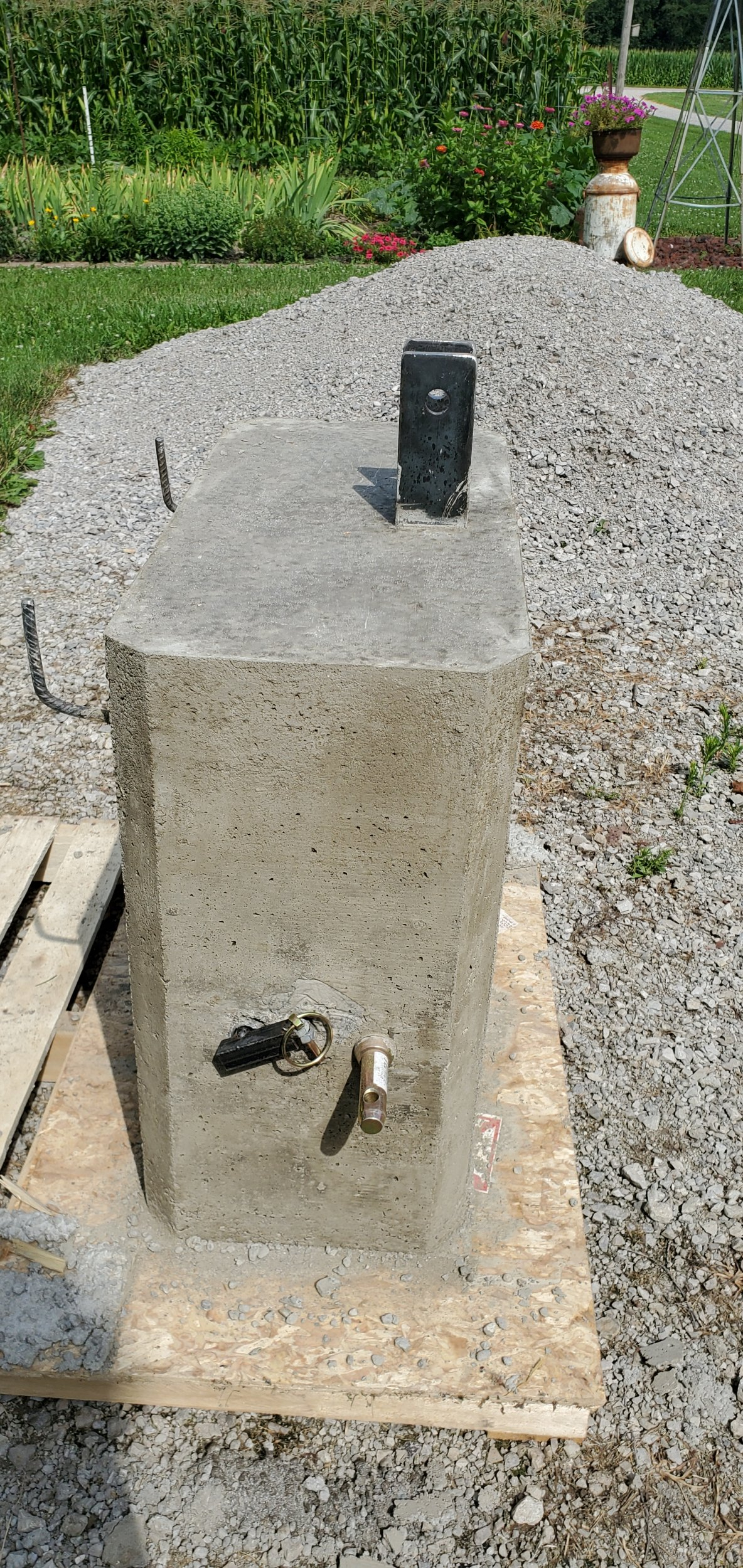

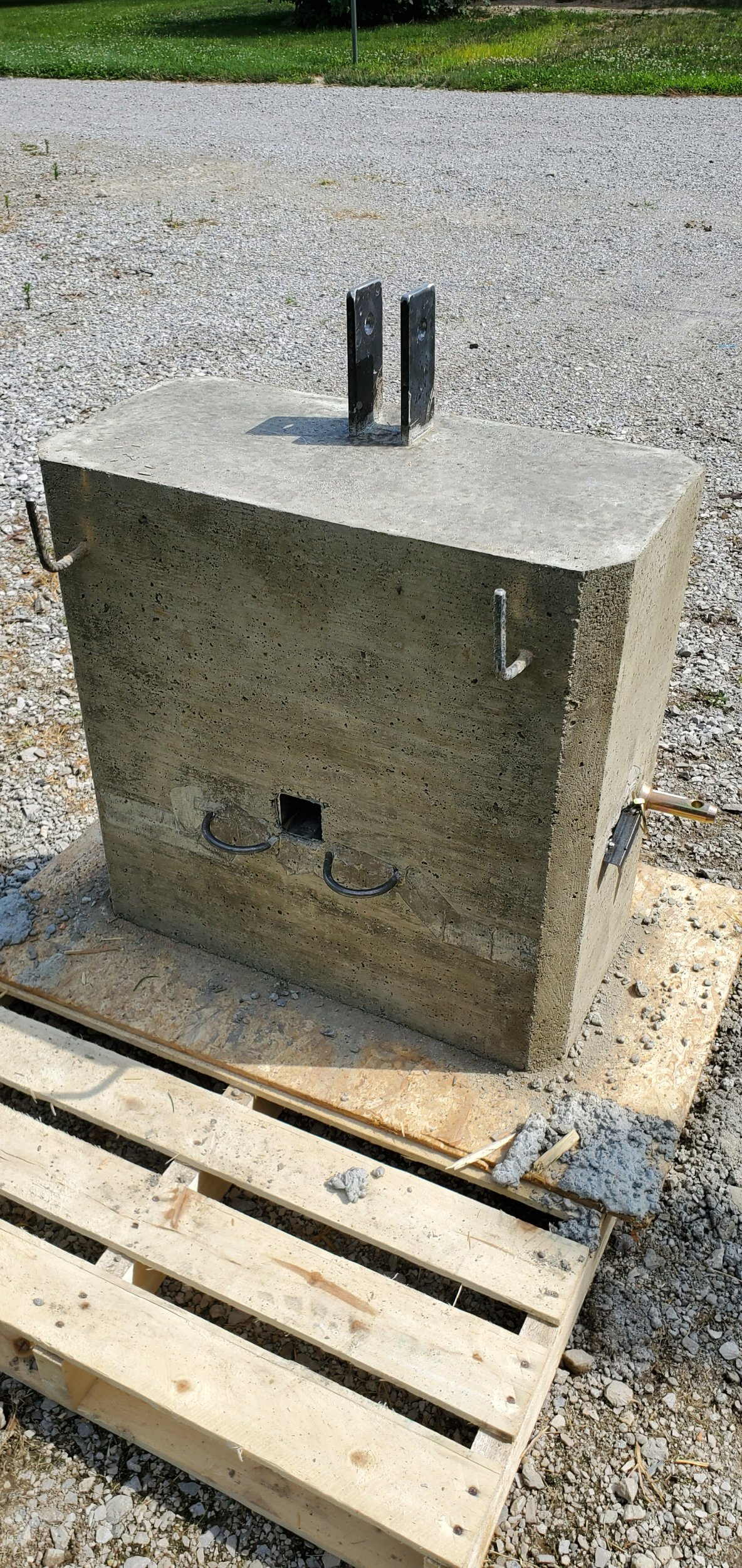

Finally got the weight poured yesterday. Will wait another day or so to try it out, then paint the metal parts (should a done that first). Weighs in right at 600 lbs. Center of gravity is about 2 inches behind the pins. I've got a 2" receiver embedded in the concrete also. Fabricated an extended pin in order to be able to lock the hitch in place. 20220726_160815.jpg20220726_160835.jpg

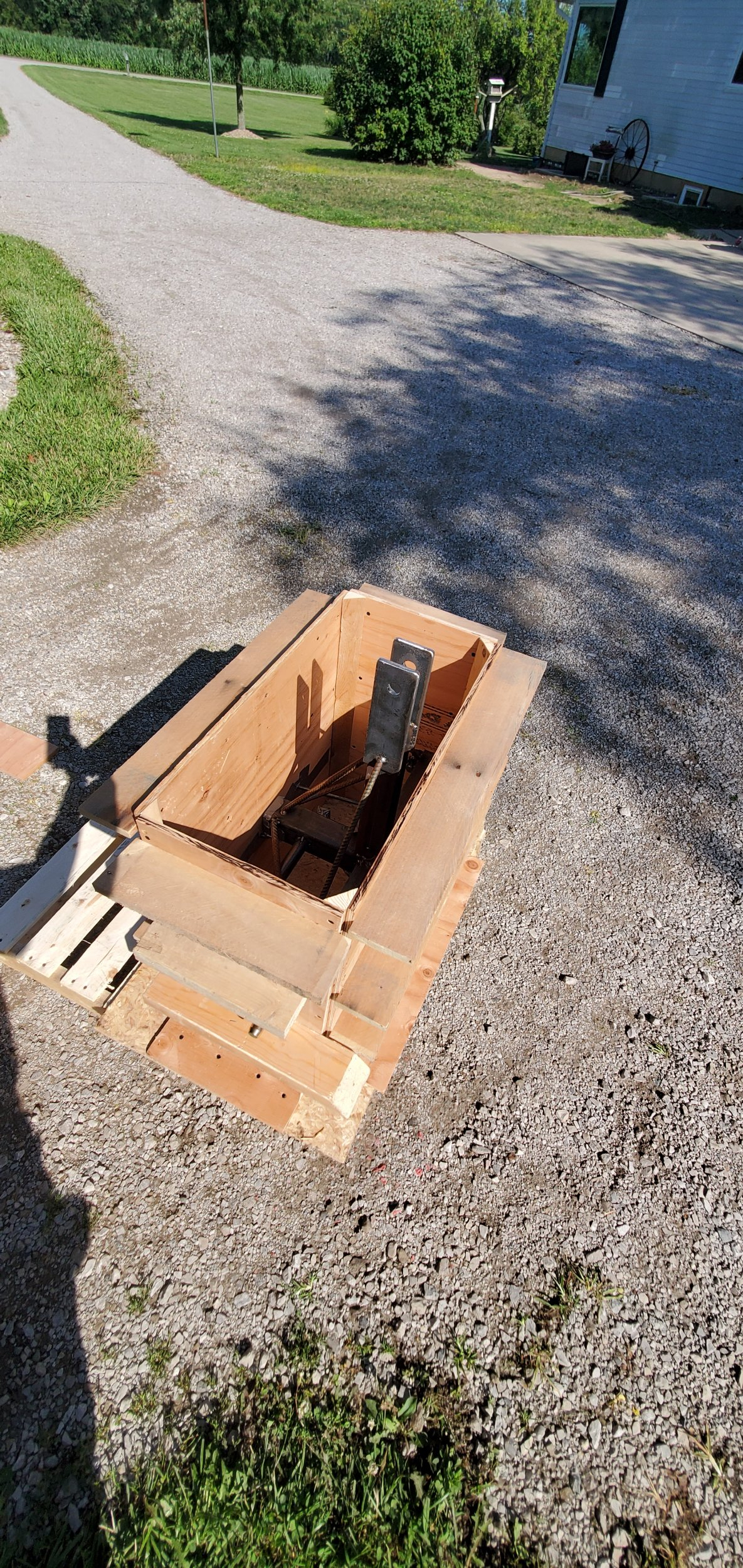

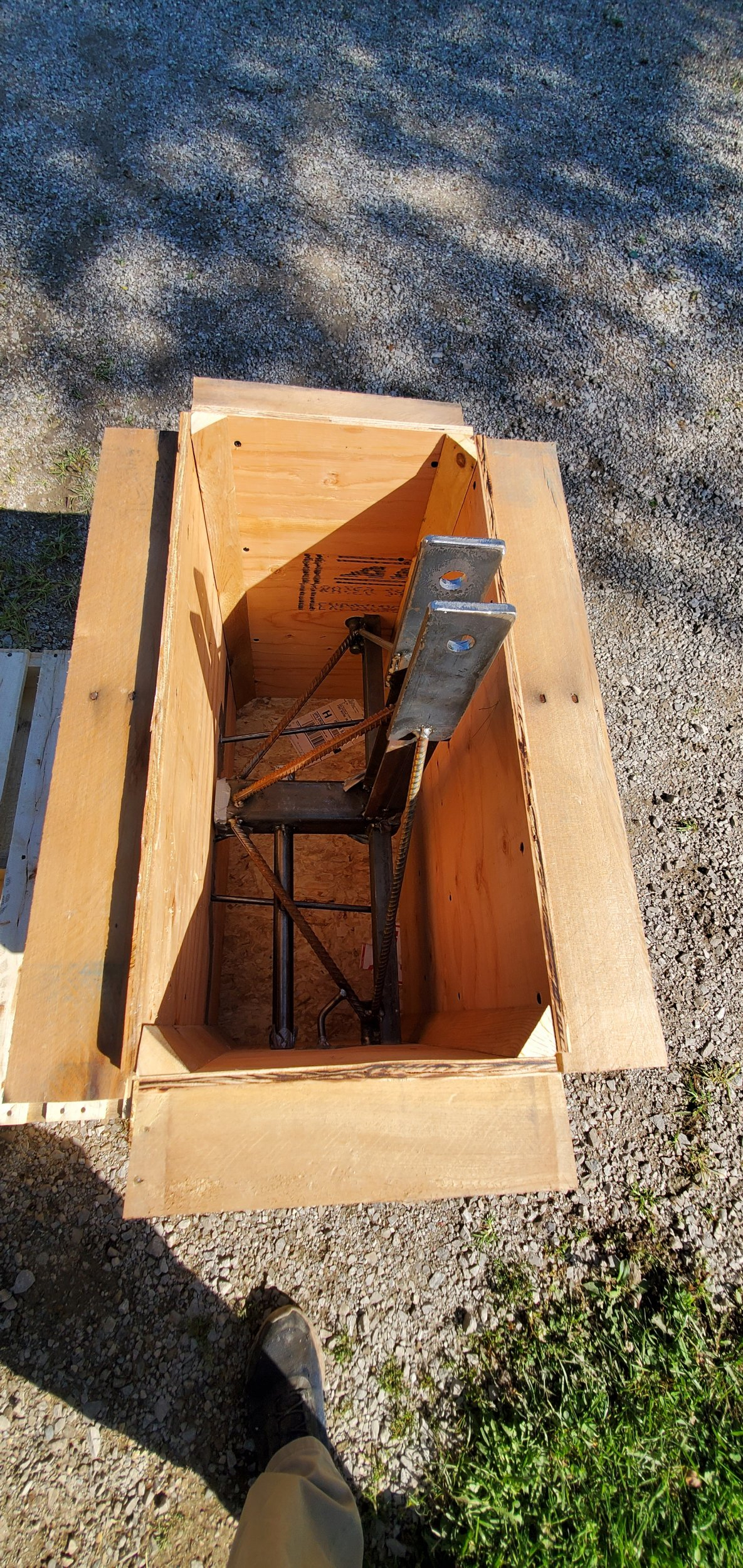

Sorry, these didn't get uploaded the first try. All the metal parts are welded together except for the top chain hooks. Planning to build a plywood box on top yet to hold chains, gas can, oil can etc.

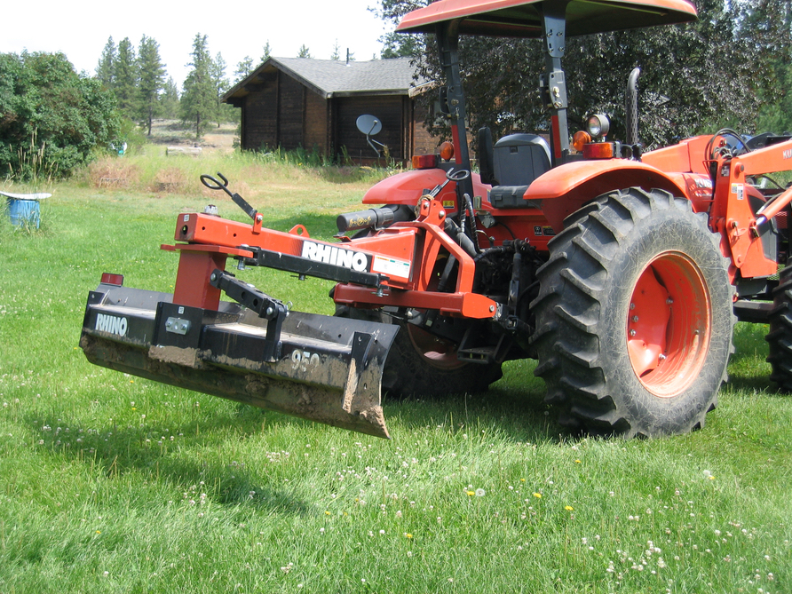

When I was deciding on an upgraded tractor - I considered a weight box on the 3-point. But a weight box DOES nothing. Instead I went with Rimguard filled rear tires ( 1550# ) and a 1000#+ rear blade.
These two upgrades successfully handle the total lift capacity of my FEL and grapple. I can lift and move 3000#+ with the FEL and grapple.
I have 80 acres and a mile long gravel driveway. I'm not limited by confined spaces.

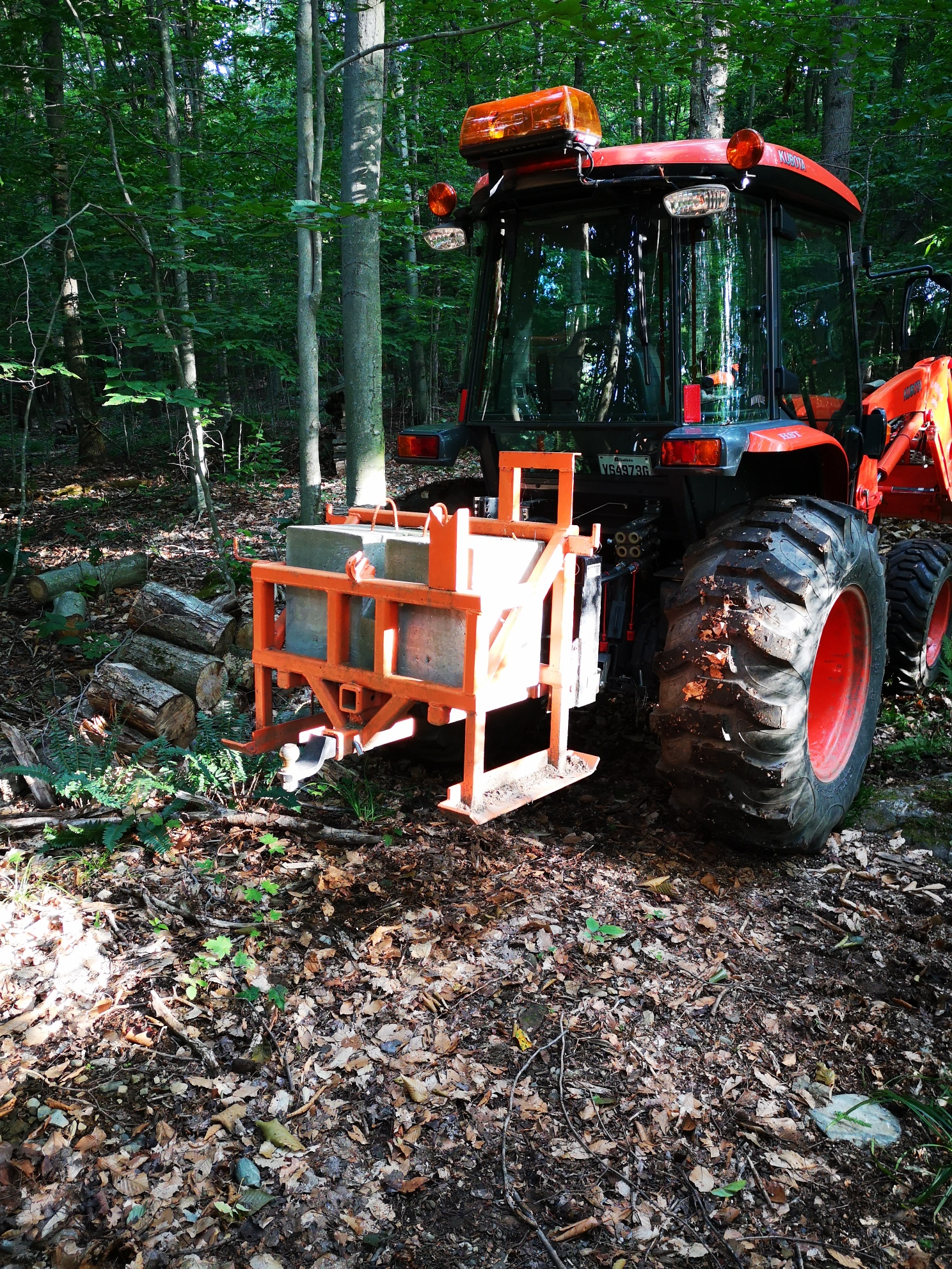

Most of my heavy lifting will be done in tight areas. I built this ballast box for around $100 bucks. I'm not buying a box blade until prices come down or i find a used one. Also, this way when cutting firewood i can hook the trailer on behind and still have the weight for extra traction after I unhook. It certainly has limited usefulness, but it's also cheap to build, takes little space, and won't wear out very quickly!

As is obvious - in tight areas I would simply get all tangled. You have an answer for $100. My answer was $3800.
