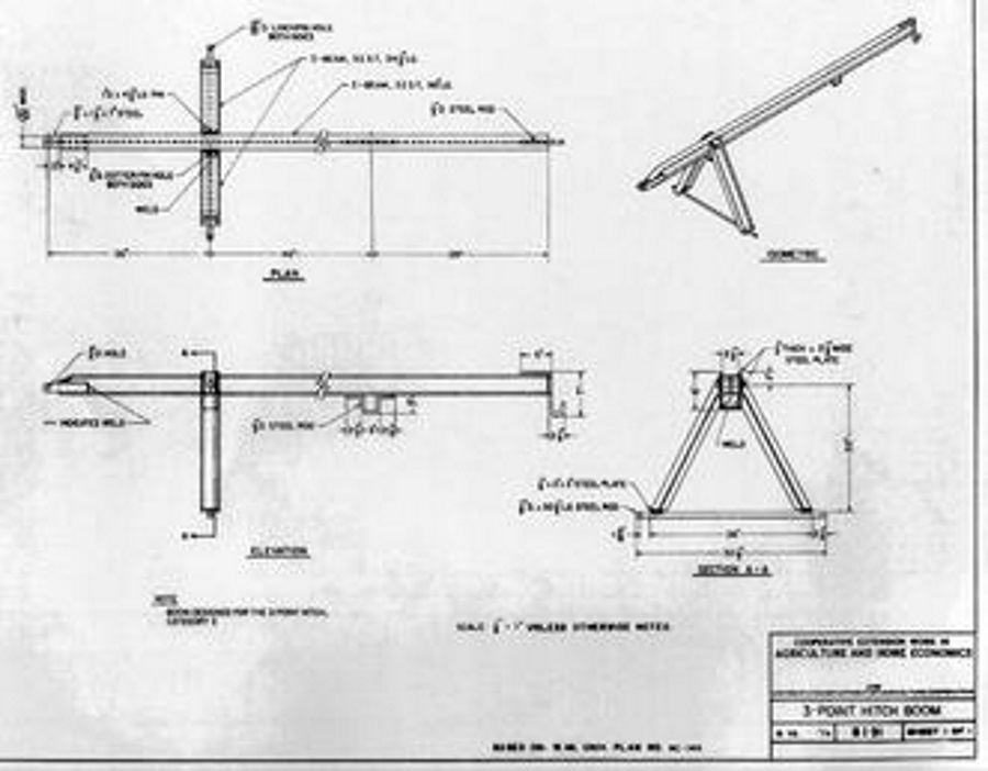

3pt boom pole plans
   / 3pt boom pole plans #21
!8 for conventional 3 point, 15 for quick hitch.
That's why most modern compliant implements have 2 top holes.
Bruce
Adn with either, if his spacing on the tractor side is indeed 20", he is gonna have issues no matter what
   / 3pt boom pole plans #22
Has anyone built or have this style?
It is made like a post hole digger frame, doesn't use a toplink:
   / 3pt boom pole plans #23
I haven't built one like that, but have seen them.
Of equal lenght as a standard boom, those offer more lift height at a reduced capacity
#24
IMAG0038.jpg here's a sketch of the lift measurements in the down position. Maybe you can make since out of it I'm no artist or draftsman. Hope this attachment works right.
#25
Lift cap. is 1400 or 1500lbs ,not sure at which point though forgot to ask .
   / 3pt boom pole plans #26
Your vertical distance on the tractor side is either 30.5-16.25 or the 27.5-16.25.
Makes a whole lot more sense than the 20" you were talking about earlier.
#27
I apologize for any confusion, I misunderstood what points of measurements you was asking for.
