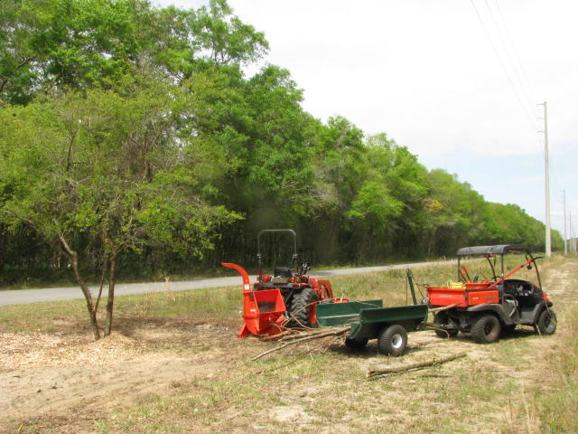

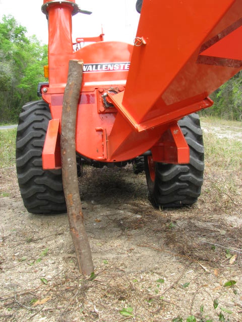

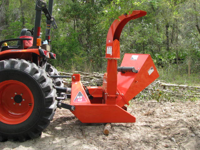

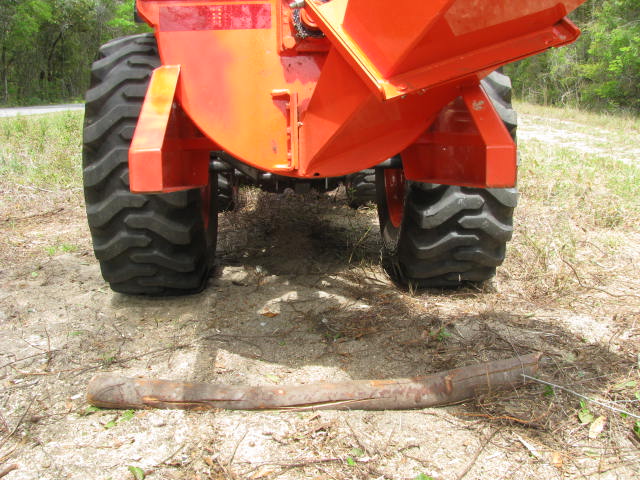

First, lock tractor brakes "on" and lower FEL all the way to the ground, then put a 4" - 5" diameter ROUND branch under the support stand, in middle or slightly biased to the rear, and chip away. I have been carrying around my "favorite" 5" chunk of branch since the Wallenstein was new.
This morning used the Wallenstein BX42 to mulch a Flatwoods Plum along the Nature Coast State Trail.
Note my "favorite" branch under the chipper base. It is nothing fancy.

I think you just need to buy a shorter toplink at tractor supply. The chipper has a long base that extends pretty far out from the lift arms.
