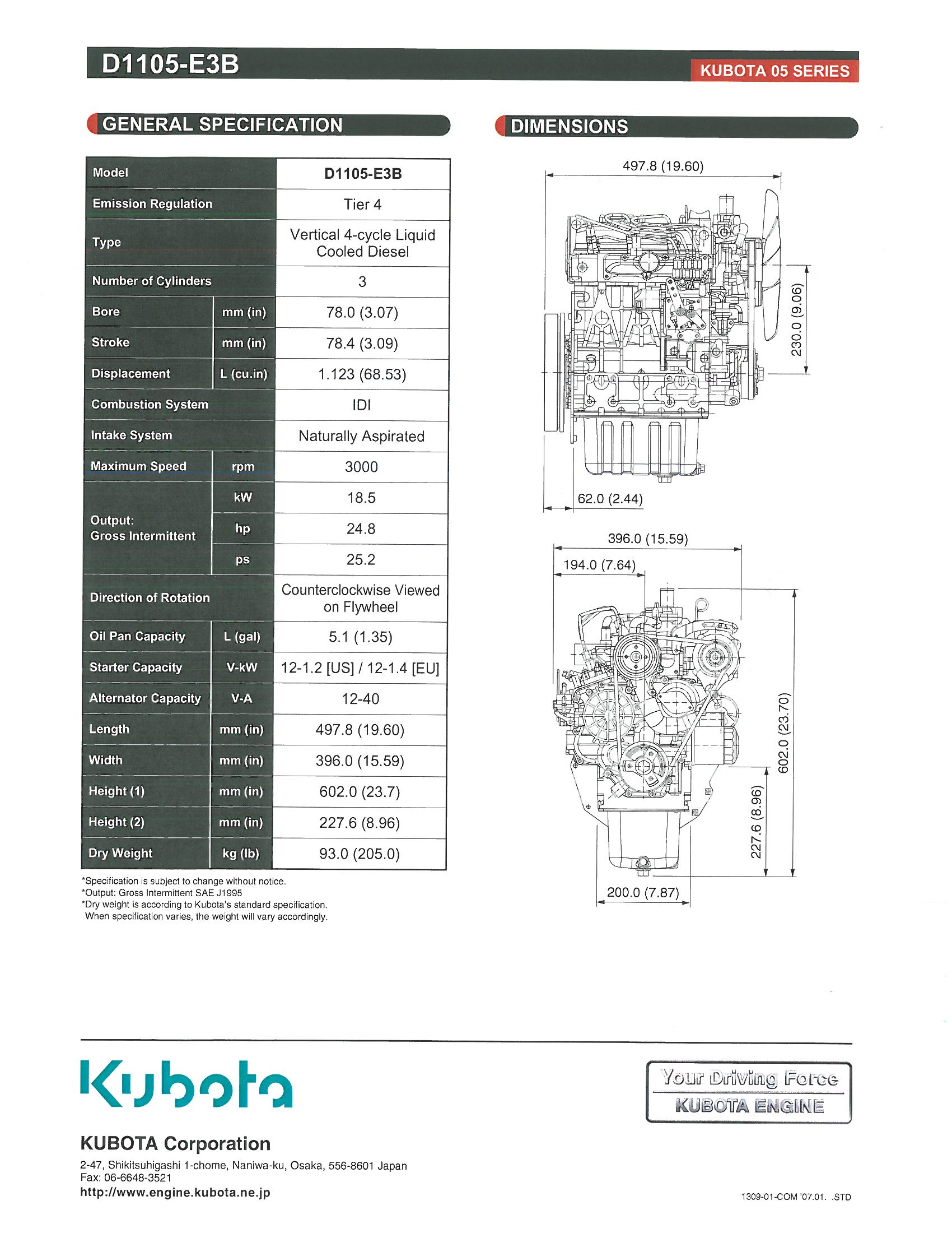

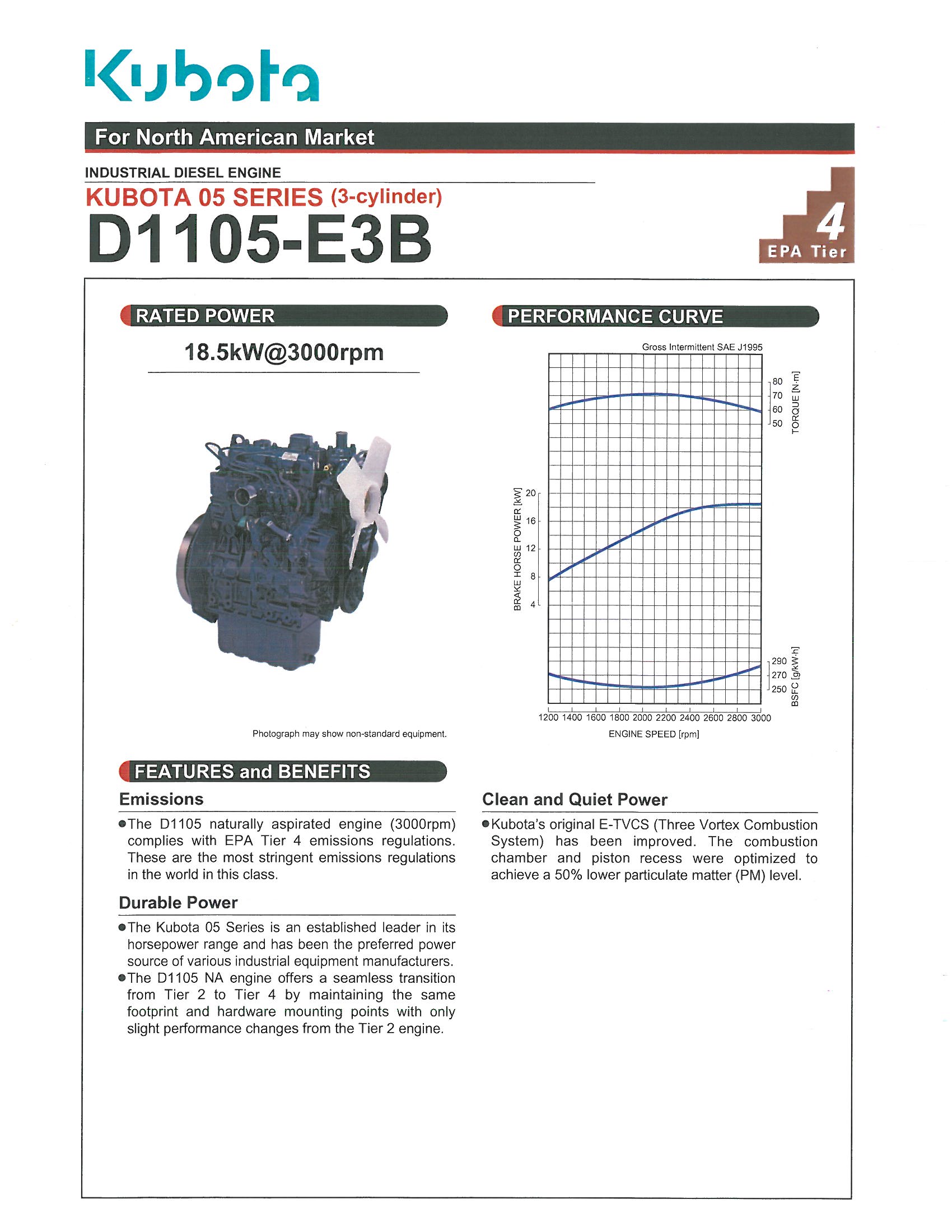

I have a B2320,
I just looked at some engine data sheet and your right im not saving that much... and in reality your right I keep up on my maint. so what am I even worring about... I also do not need the gen. all the time so the tractor will not be run that much either.
   / 3PT Generator Question #19
I have a B2320,
Are these the same engine data sheets you found? You still need to know engine rpm at your two 540 pto output speeds to use the curves. Philip.
