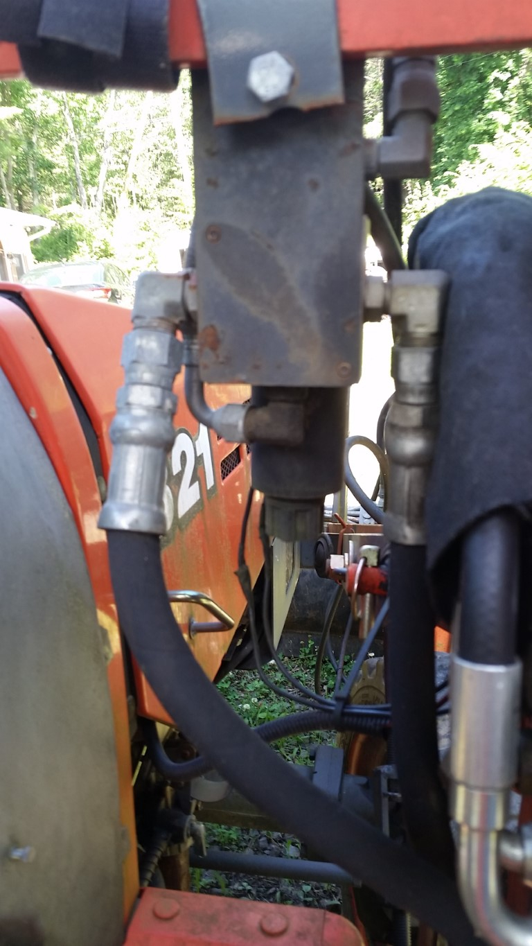

This is the existing third function valve, solenoid operated, on/off/on

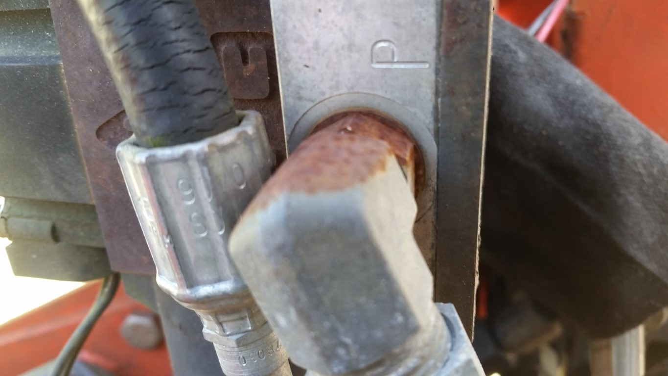

This is the Bucket valve. The hose with RA fitting coming out back goes to the P port on the 3rd function valve.

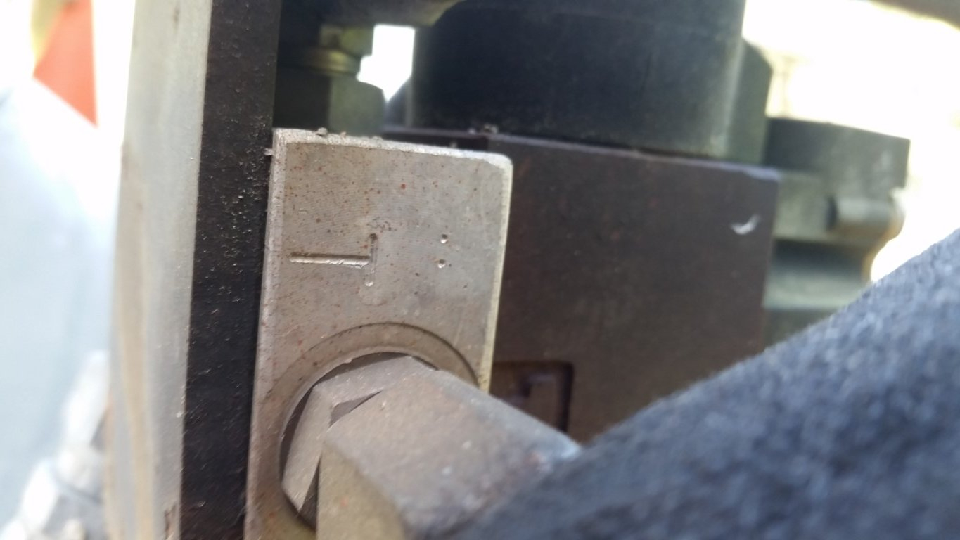

Back of existing 3rd function valve. Port on right is marked L and goes back to tank (I think) looks like it came out of the bucket valve originally.
Port on left is marked P, hose comes out back of bucket valve.

Also attached are pictured of the ports on the solenoid valve. Seems I could just put a double (or triple) spool valve "in series" either before or after the solenoid valve, the removing the P hose, feed it to the spool valve "high" side and the "low/tank" side going to the solenoid P side. Or, feed the solenoid L side into spool valve assembly "high" side and the "return" from its "low/tank" side to the return to tank hose. I may have mangled the terms but hopefully it is clear enough.
All I really need to do is figure out where to mount stuff, make up any brackets and hoses needed and, play pen time.

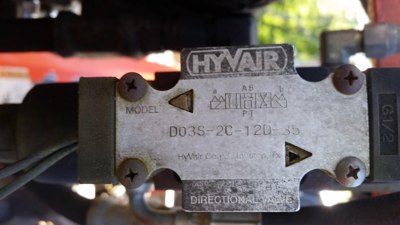

There are 7 hoses in that assembly. 4 go to/from loader, two metal lines at the bottom, one looks like it comes from the pump the other goes to the rear to the backhoe/3pt hitch stuff, looks like.
The one coming out the back goes to the 3rd function valve (the jaw/grapple of the 4 in 1). That looks like the PB (power beyond) port.
The existing 3rd function valve is HyVair D03s-2C-12D-35. Specs below.
   / 3pt hitch Hydraulic top link and control #20
That is weird. The three non-work ports should be Pressure, PB and tank. What do you think the rearward going hose do? Any chance you have any documentation on the tractor?
