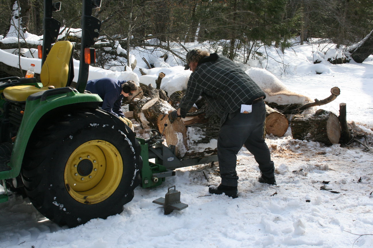

Been thinking of buying a 3pt. hitch hydraulic woodsplitter. I split 1 quad axle log truck load of wood a year.
I looked at Wallenstein and am considering them. Only real must is that it will work vertical. I'm not lifting all that wood up onto a horizontal splitter!
I want a good one to last me for years to come.
Anyone have a 3pt. hitch hydraulic splittler or experience with one?
I am not normally one to go the inexpensive and simple route, but I went with the Wallenstein 310 which is about as basic as it gets. It could use a folding kickstand (in the works) and did not direct connect to my Imatch, but it is SO simple and works so well. with really no maintenance. I haven't encountered anything that it would not split except when using the 4 way wedge. The 4 way is nice and simple too just lift it off and it is out of the way.
When my horizontal splitter was at the wrong place, I rented a vertical one. Never again will I use a vertical splitter. It's **** on your back since you are always bent over moving the rounds and the split pieces.
YMMV
I never had a vertical one, but I can see what a pain it would be. MORE bending than loading a horizontal unit. If lifting were a concern try a skid steer "lift over" type and just roll the logs into poistion, set the splitter over and go.
A nice thing about my 3 PT splitter is the abality to move it up and down. All the way from the ground, up to a comfortable working height. I also can adjust he height so it clears the back of my utility trailer and I slplit right into the trailer.
Mine will lay just about flat on the ground and if I were to adjust the 3PH lift links a tad lower it would lay flat. I also just added a hydraulic top link.
We load the big stuff by rolling on and then lift to a convenient height for working.
One thing to watch in all of this (my opinion) is to push with a flat and split on teh end so the wood keeps moving rearward and out of the way to load etc. Just keep inching the tractor fwd to extend the pile. I see a lot of splitters that have the wedge on the ram. That just looks like a mis engineered toe smasher and trip hazzard to me.
Pic below is a buddy running mine. Strong as an ox (and built like it too) but not quite sharp enough to grasp the lower, load, lift, split concept so he just worked at a stoop.
