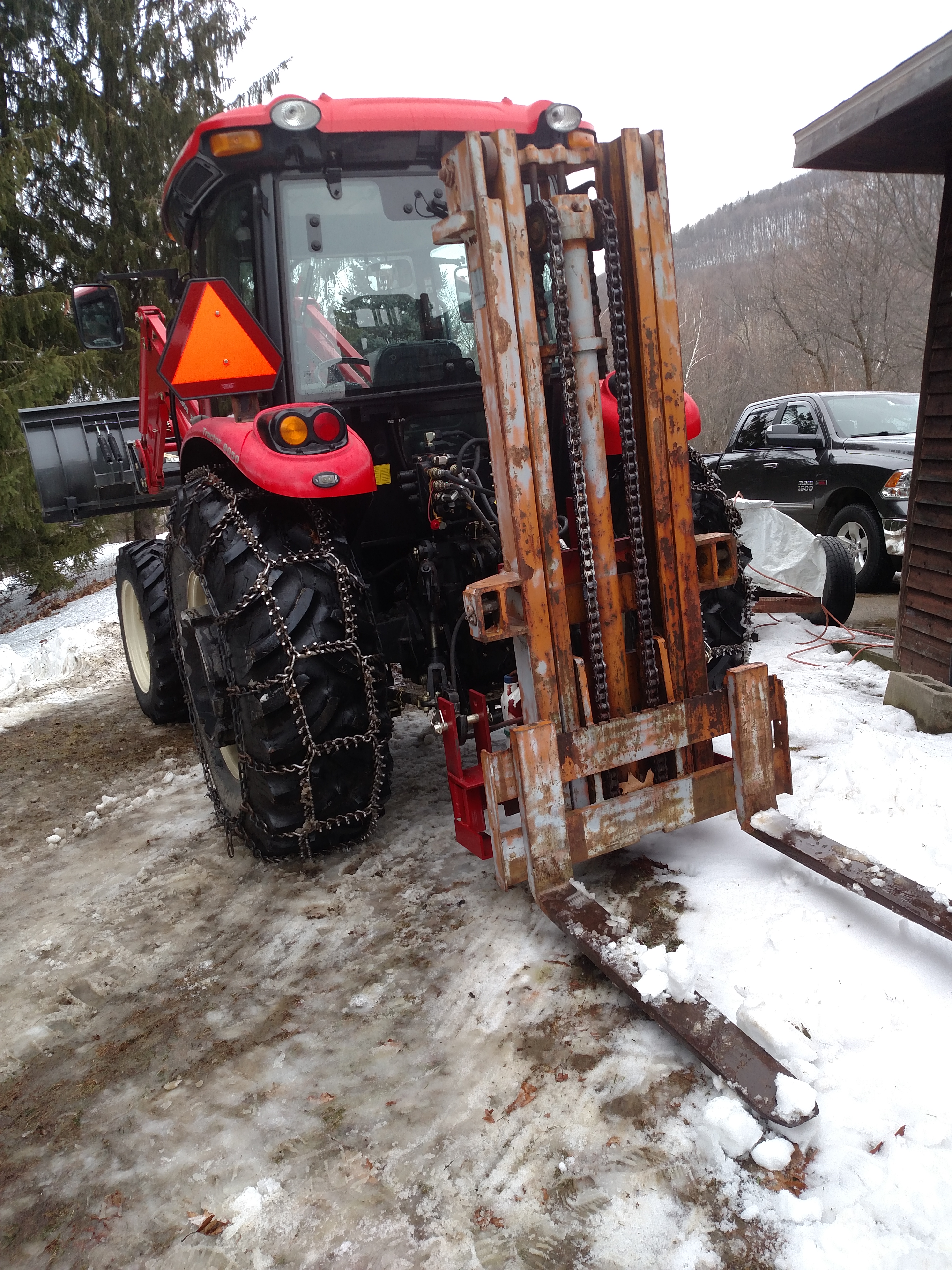

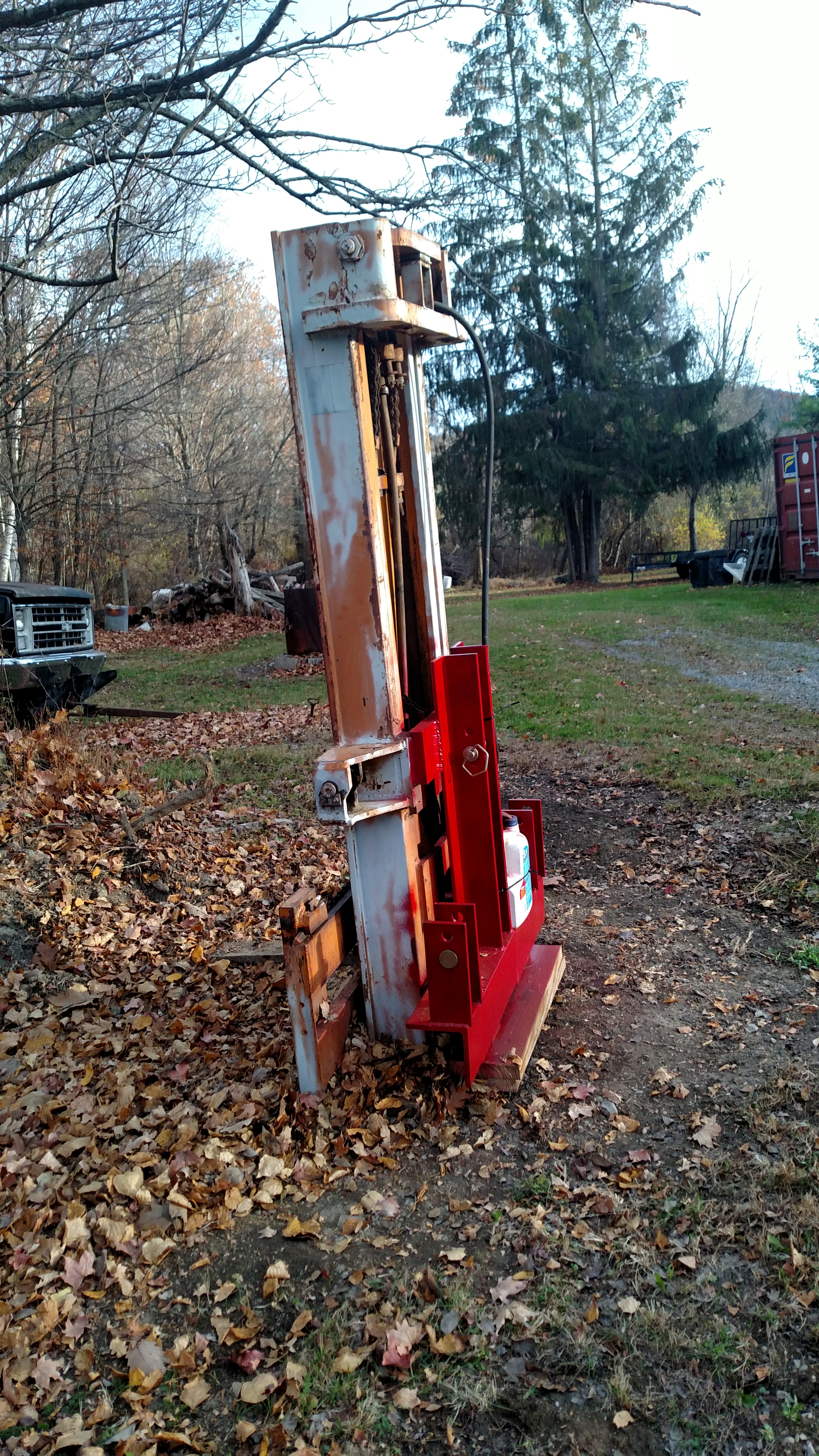

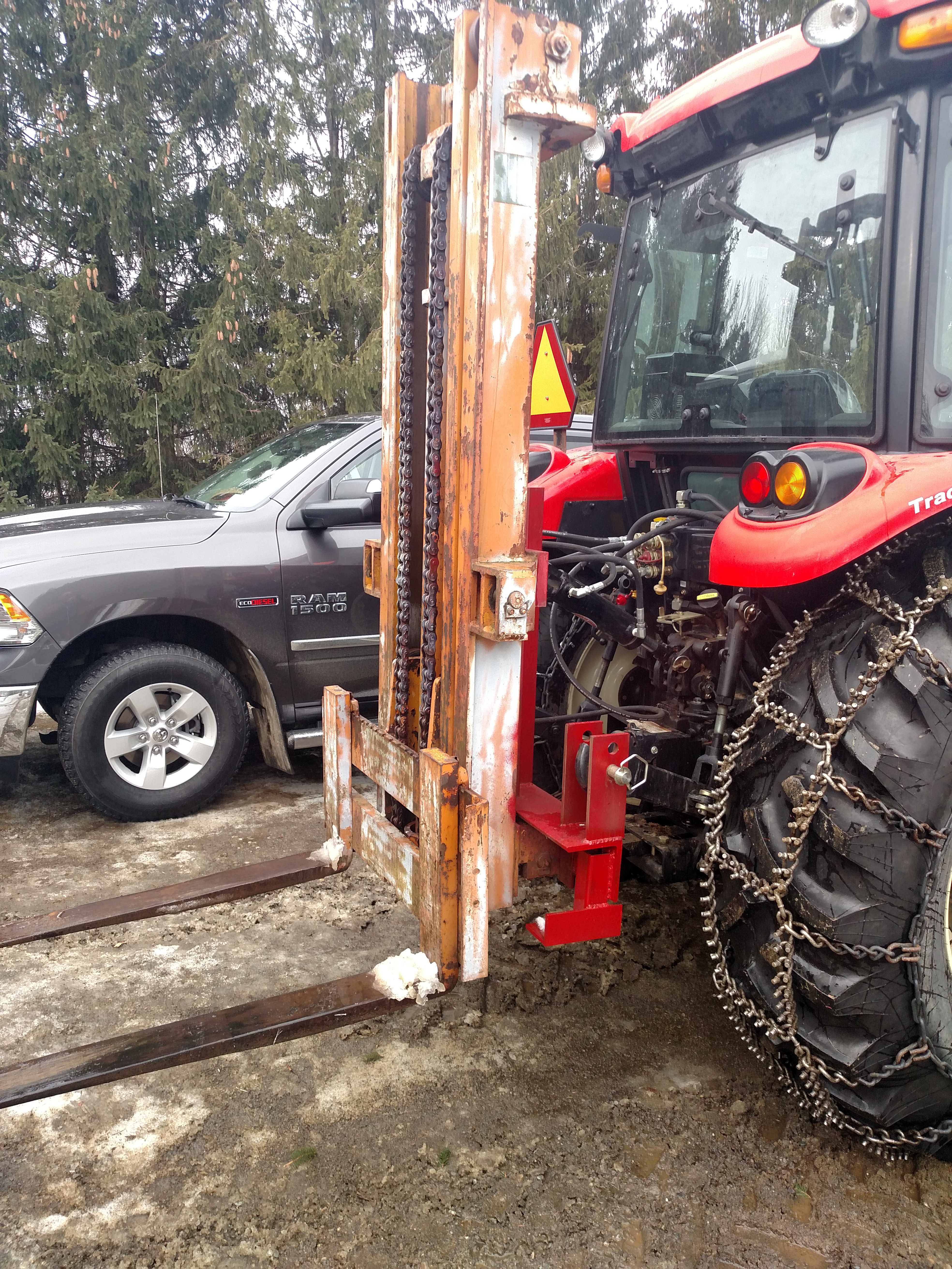

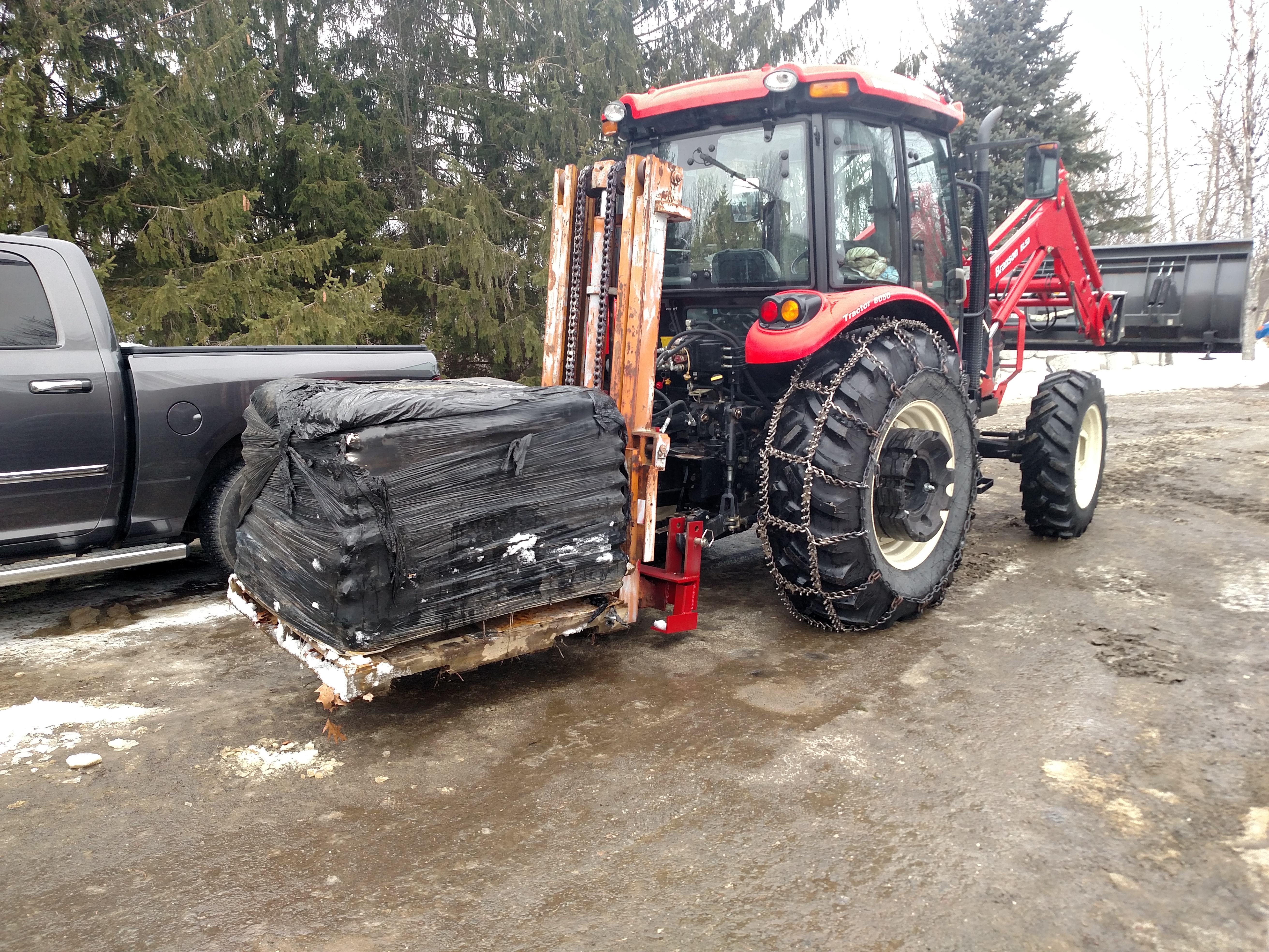

A normal 3 pt. set of forks will not have much lift height, you can find commercial 3 pt forks with a mast or make up your own, I used the mast off a 5000# capacity forklift and made a 3 pt mount.
I also use a hydraulic top link to be able to tilt.
IMG_20151107_153314277.jpg View attachment IMG_20180111_111858348.jpg View attachment IMG_20180111_112610294.jpg View attachment IMG_20180111_113547661.jpg
That load is a full pallet of coal 1 ton, 2000#
