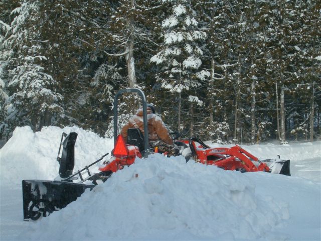

I don't know about the Blizzard blower but I have a 60" Meteor Blower. I operate it with a CK-20 and it does an excellent job. My CK20 is 22 h.p hydro so it's probably 18 h.p.at the PTO.
