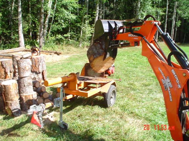

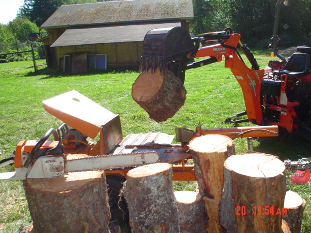

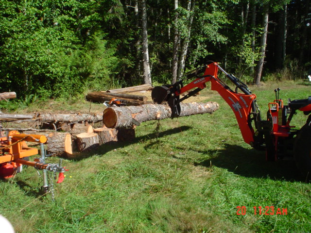

I like having my gas powered splitter, got it before the tractor. Still would get the stand alone, for me using a PTO splitter would make it very difficult to use the backhoe to lift those big heavy rounds. :)
