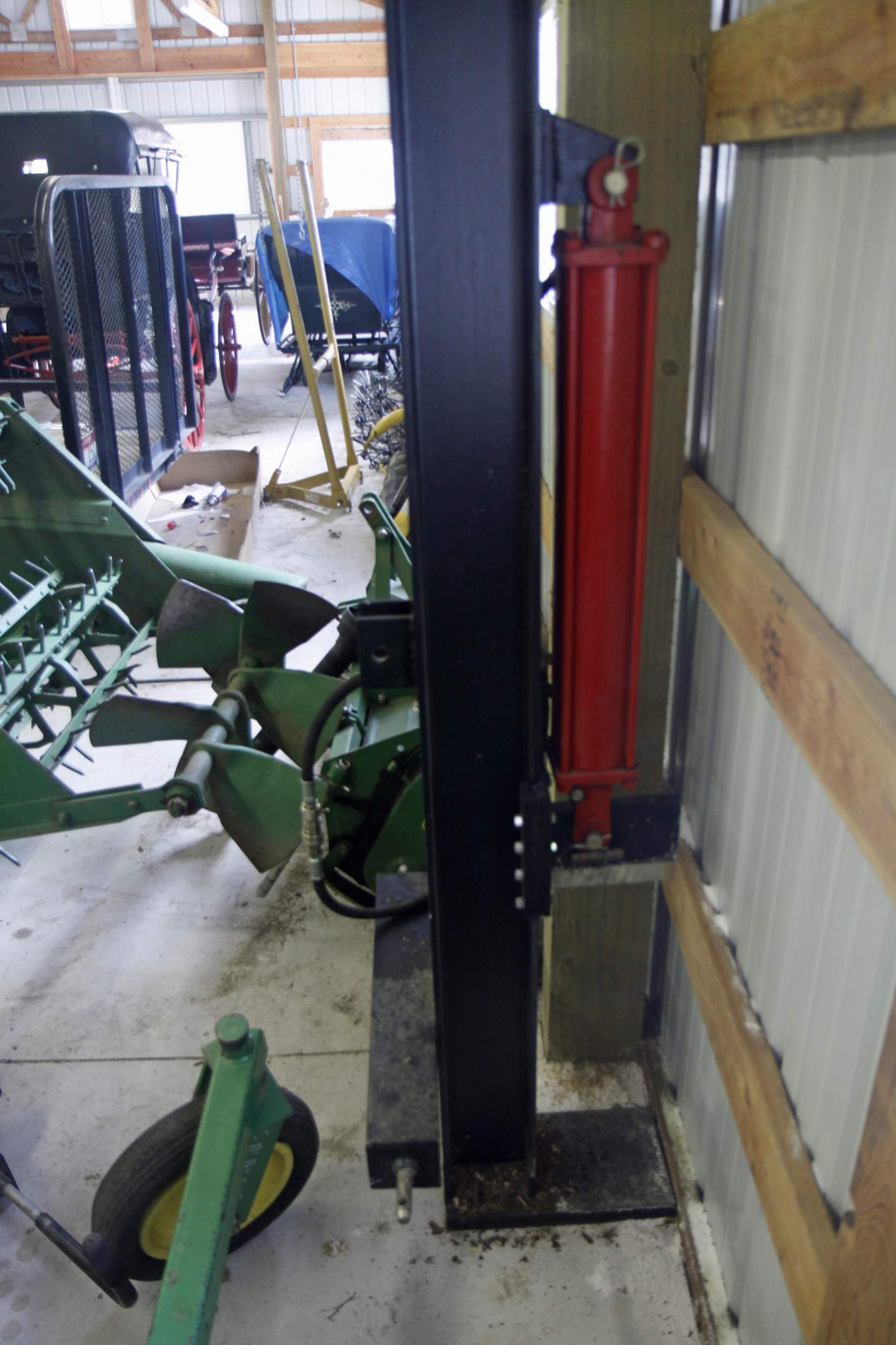

you got that right...mine stands upright. I only split maybe 2-3 cords a year, as my house is super well insulated, and doesnt take much heating. Now if i had to split 20 cords, id go for an engine operated unit no doubt.
