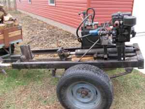

I'll throw a plug in for the 3pt splitter. I only do 2 to 3 cords a year. Just enough to clean up the dead fall in the woods and burn in the livingroom fireplace. I just built this one pictured this year for about $300. It has a 4 inch cylinder and a prince lsr 3060 valve. Cycle time is about 11 sec max to run a full split on a piece of oak. I only have to down shift the valve to get the initial purchace in the wood and then with this valve you just shift it forward to double the speed.
Like others I don't really worry about the extra 2-4 hours a year I put on my tractor for splitting.....that is why I have it.
The two main reasons I own a 3pt is that I can easily take it into the woods and split the tree in place instead of carring all the logs out. I live on some hilly terrain and getting logs out can be tricky. The other and most important reason I like the 3 pt is no one can borrow it unless they have a tractor already set up to handle it. Everyone I know that owns a stand alone model has it constantly borrowed out to everyone.

LD, I built one that somewhat resembles that, except the cylinder is 4x24, the old lawnmower engine is electric start and 18 hp and the pump is a Barnes 28gpm 2 stage. It's got a 7 second cycle time. It's got a catch table and torsion axles. My wheels are back like you describe for a reason. I wanted them out of the work area. Didn't like the way the wood bounced off the plastic fenders of the speeco I had been borrowing. Yep, it's tongue heavy, but that's why there's a trailer hitch on the end of it. :)

Well, if thats your preference, so be it.
Our splitter doesnt have fenders to worry about. And there is a lot of time we move it around or spin it around a little in the barn where it would be impossible to hitch to. I like the balance. Not to mention, having the vertical capability requires the axle to be more centered as well.
But most of the ones I refer to on c-list dont even have a jack:confused2: Just kinda looks like a crappy splitter when the wedge/beam is on a downhill angle and on the ground.:confused2:
The following picture is an example of kinda what I am talking about. Allthough it is a little more balanced than some I have seen. But the price is the biggest thing. The guy is asking $1150:confused2: 8HP briggs, horizontal only, and looks to only be a 3.5" or 4" cylinder. No offense if this is someone on heres. But for the price???? Good luck and I hope he gets it, But when you can buy a factory built one for less, have the warrenty, vertical, etc, I have to ask, why would someone buy this for $1150???? I would love to be able to cobble something like that together and get that kind of price. But personally, I dont see more than ~$500 TOPS there.
