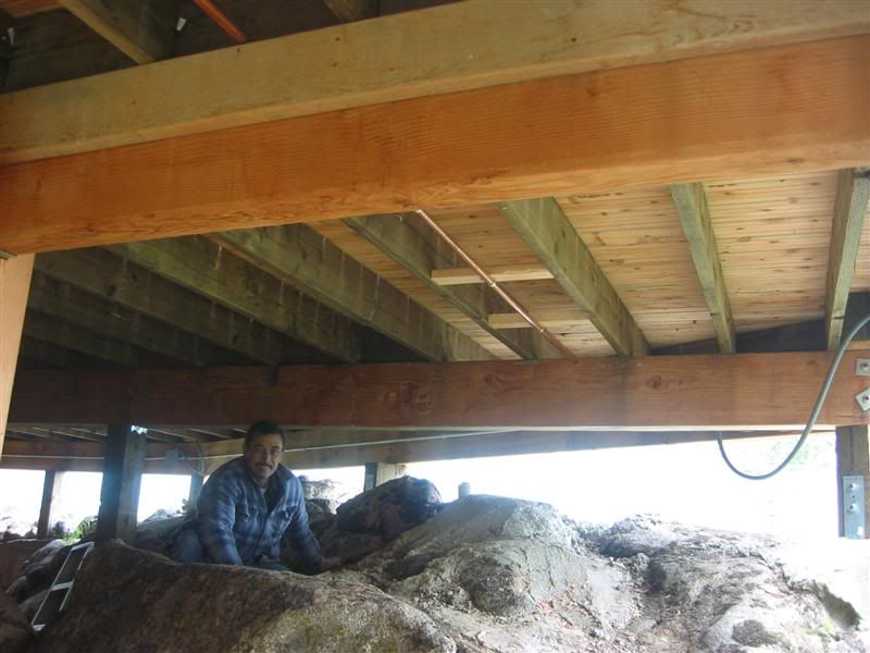

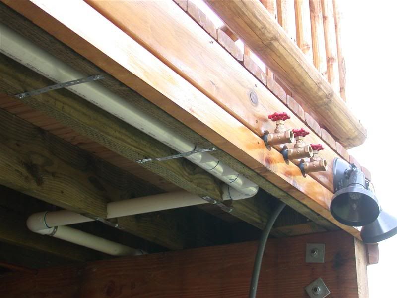

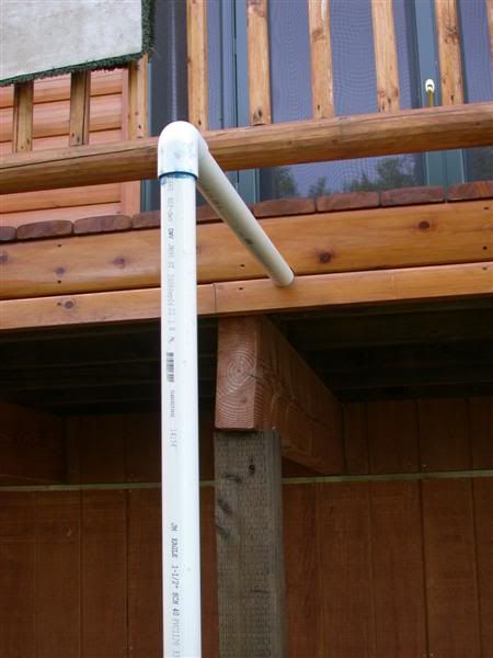

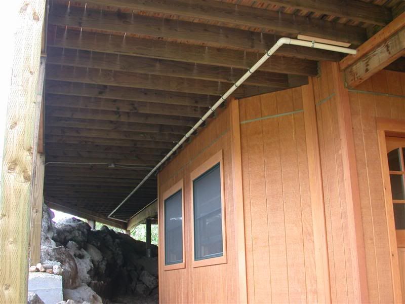

Earlier in the thread I mentioned we were going to run irrigation down the back hillside to keep it green year round.
We ran a lot of 1-1/2" sch 40 pvc under the elevated deck. Our plan is to have 3 manual stations for now, each station has 3 valves to control large Rainbird sprinklers down the hill. The manual valves come through the wood exterior where we can turn them on and adjust the sprinklers from the deck so we can see what they are doing. Running the pipe under the deck and over the huge rock pile was tricky, but it was a lot easier than using a 12' tall ladder to hang it on the taller decks. We still have to run the pvc down to the ground and then poly pipe from there to the sprinklers.
So there is still a lot of work to do on that hillside.
Rob-
   / 3R Home and Barn Project #1,158
Hi Rob, you two sure stay busy. In your first photo it looks as if that pipe will be exposed to the sun. PVC tends to deteriorate from UV exposer and will become brittle with time. Grab a can of spray paint and give it a coat. It will buy you a few more years of service based on my experience.
MarkV
