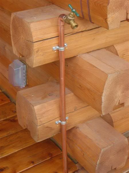

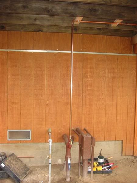

While working on the irrigation for the hillside, we also installed a 3/4" copper line hose spigot up on the deck.
This will come in handy for washing that area down plus a lot easier to refill Coco's water tray. We feed and water Coco up on those decks just outside the dining room.

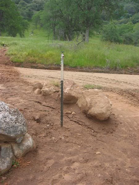

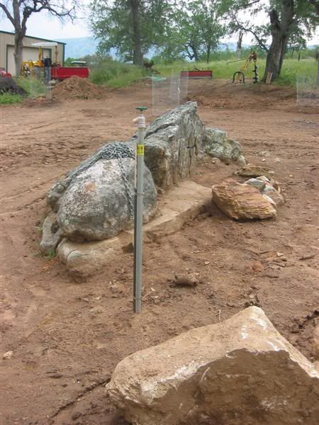

Loretta's garden area also needed a hose spigot sow we trenched and installed one near the rock pile. That way she can hand water or wash stuff off out there. All little improvements but it still takes time to do. Especially trenching with the backhoe through the road and field for that garden spigot.
I'm not sure what we will do about insulating the pipes. The builder told us none was necessary for our climate but we know different. One year we had a bad freeze that busted our water lines.

How about installing one of these:
Frost Free Yard Hydrants | Water Pumps | Northern Tool + Equipment . I have them all over my place ( 5 to be exact). They are sturdy and you don't have to worry about them freezing. I have bought them at Lowes, Tractor Supply, and Southern States (local cooperative), along with other building supply stores. Pretty much everybody around here uses them. I would go with the 2' or 3' bury depth in the area you live in.

We live in a no freeze zone as well and had two pipes rupture this winter (house unattended).
Love the frost free pipes. They are very simple to install, you just remove your stand pipe and nozzle. The units we have are the top nozzle with the stand pipe. When the nozzle turns off the water drains out the bottom of the stand pipe. keeps the upright form containing any water at all.

Rob -- I live in a guaranteed freeze zone :eek::eek:. I would go with a method to drain the pipes and blow them out with a compressor -- no water -- no damage:p.I use the frost free hydrants as well (I need 5 foot ones to be safe) but for lawn sprinkling and garden irrigation I just shut it down and drain in the non- growing season.

Thanks for the tips on the non freezing lines guys, I'll look into that for sure.
Right now the big non pressurized irrigation lines can be drained by shutting the valve at the water tank. The one in the garden area is buried and the one under the deck is sort of insulated since it's close to the house.

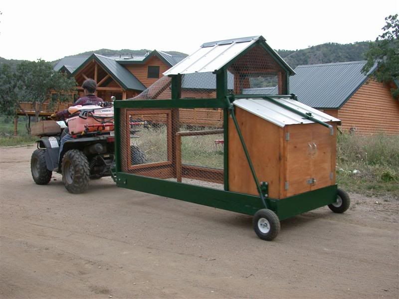

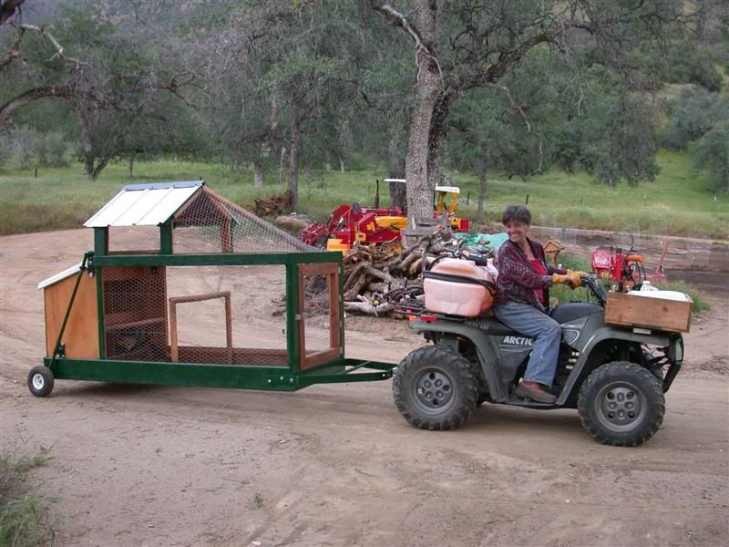

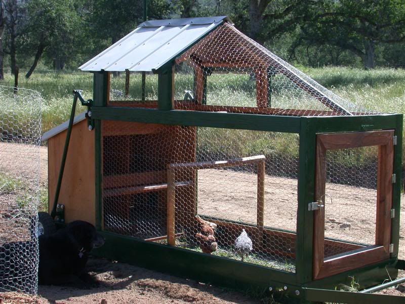

Loretta's chicks were getting too big for the box she kept them in.
So we took a break from the gardening and plumbing to make a chicken coop last week. We took into consideration all the tips to make a comfortable coop with lots of roosting bars. It's screened all around and on the bottom too. It's a 2 story coop and it's also portable. Loretta tows it behind the ATV. We made it very easy to hook up and take off with it.
