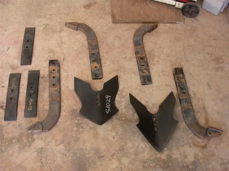

We've only done a little more clearing where the pond is. Last week I cut down about 6 Oaks which would be underwater or smack in the middle of the dam. After reading that pond manual Eddie posted, it suggested to cut them off at ground level instead of uprooting them. So that's what I did. Then moved all the trunks up out of the way where I can buck the trees for firewood and such at a later date.

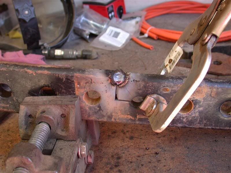

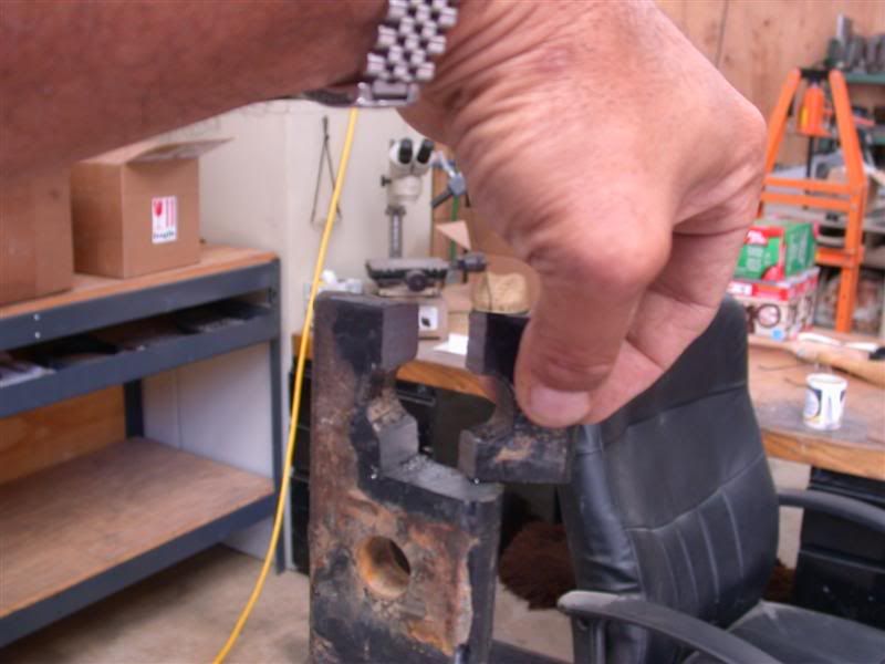

In the mean time, I told you we were going to put our lawn sprinkler system in ... finally get rid of all those hoses and poly pipe. Well, instead of digging the trenches with my backhoe, I decided to rip trenches about 12" deep so as to have as little damage to our precious little grass lawn. Of course that meant I had to make a sub-soiler first.

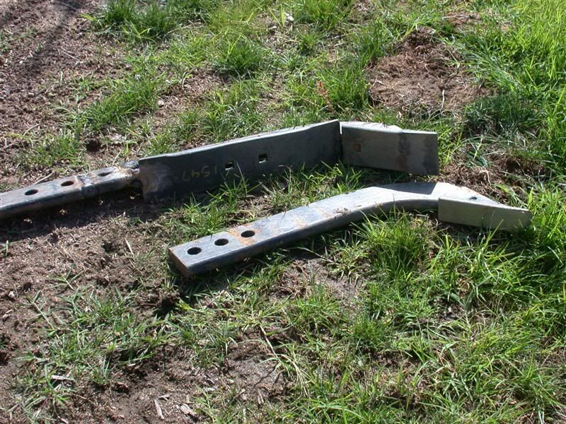

My plan was to use two of the spare box blade rippers.
One for a sub-soiler (sort of) and one for a furrower to clean out the ditch. I had to make the shanks a little longer so I cut them and welded on an extra 6". I made the cuts in a "L' shape so there would be more material to weld together hopefully making the weld joint stronger.
   / 3R Home and Barn Project
#1,287

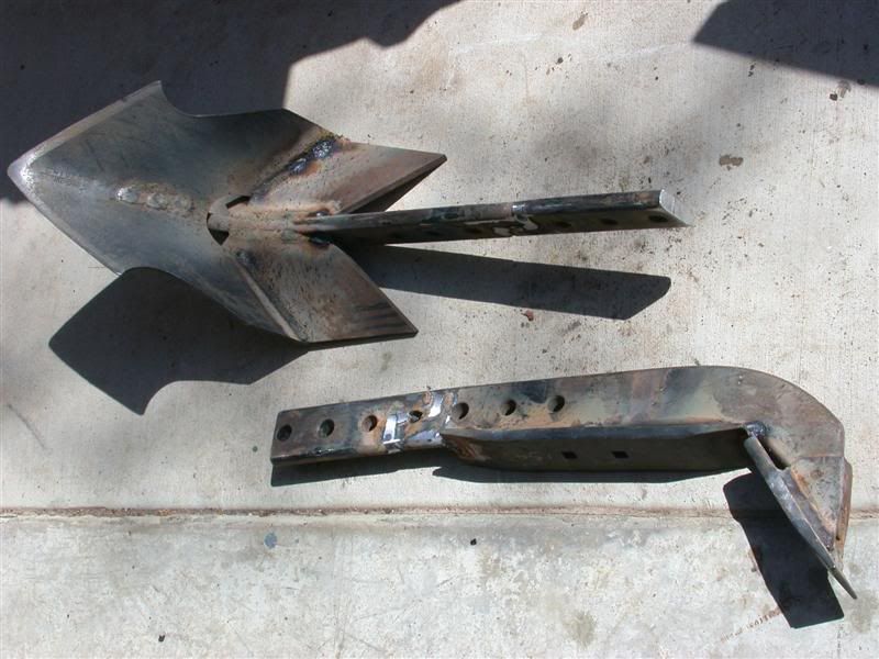

Here's what they came out like.

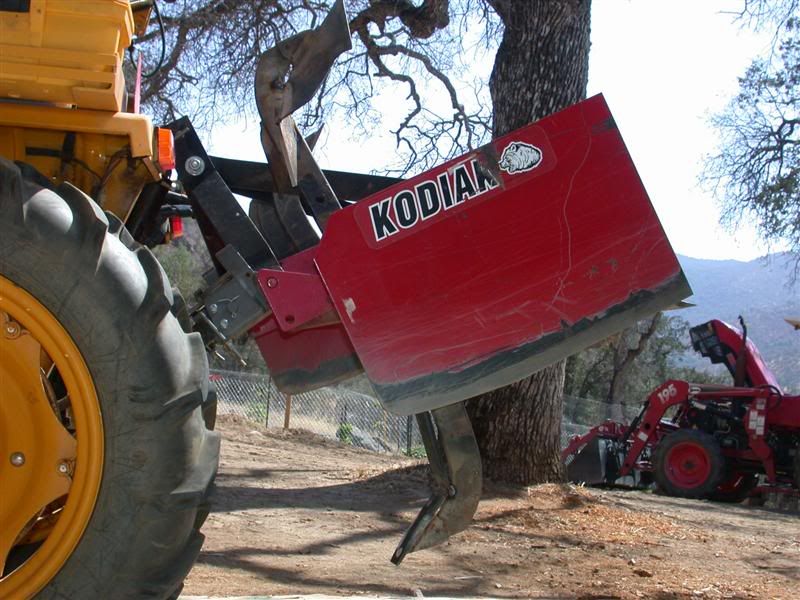

They are a little longer than a stock scarifier (see comparison). I added some mold boards to the furrower hoping it would scoop out the ditch clean.

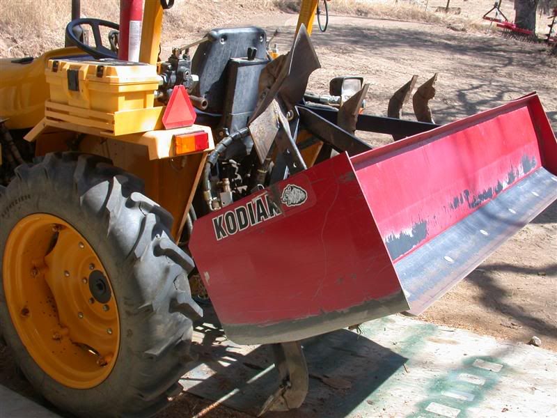

Then I put them into Loretta's boxblade and tried them out.

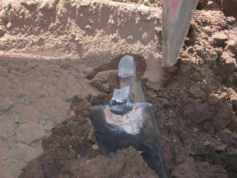

LOL ... after a few successful passes, I immediately busted the subsoiler off. So back to the barnd to weld it back up again. Surprisingly, the furrower never broke off?
#1,288

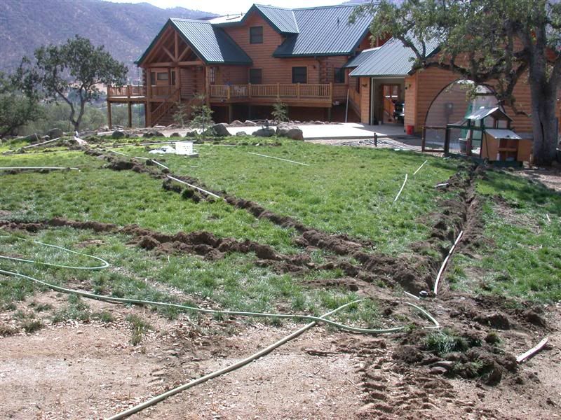

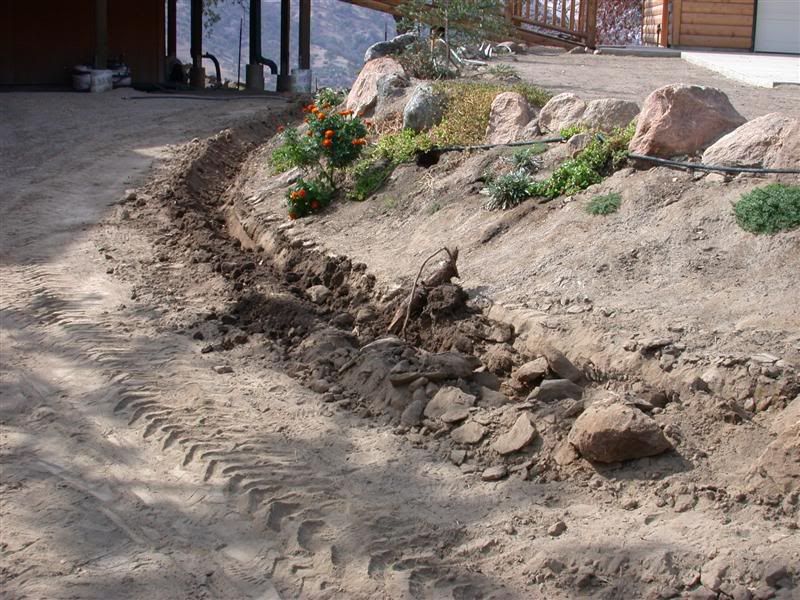

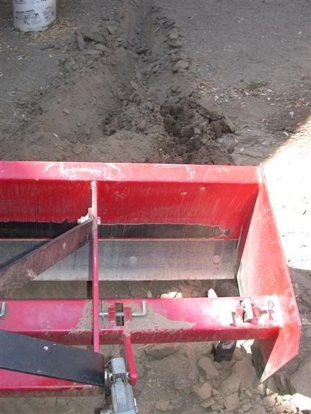

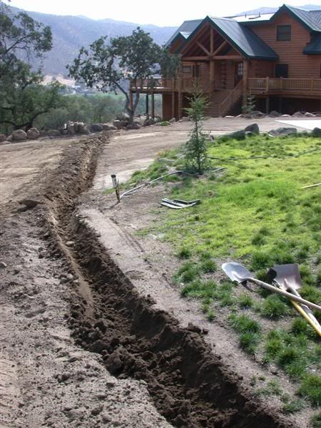

I did manage to get a bit of trench in though.
I tried both the sub soiler and the furrower and the furrower did a pretty good job. I still had to shovel out some of the clods though.

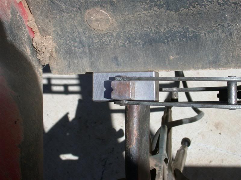

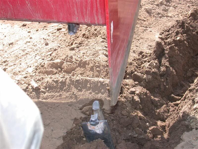

Well you guessed it, the sub soiler broke again.
After the second time welding and second time breaking it off AGAIN, I decided to add a brace.I figured out where the weak spot on that skinny shank was. So I added this tail piece that jams into the blade of the boxblade when it's being pushed backwards. All this stuff is made from the remnants of the scarifiers.:D This little feature worked great, so I did it to both sub soiler and furrower. You can see a little play before the stop hits the boxblade. That's so I can install the shanks into the box blade, but it moves backwards and hits against the inside lip of the blade and holds it there.

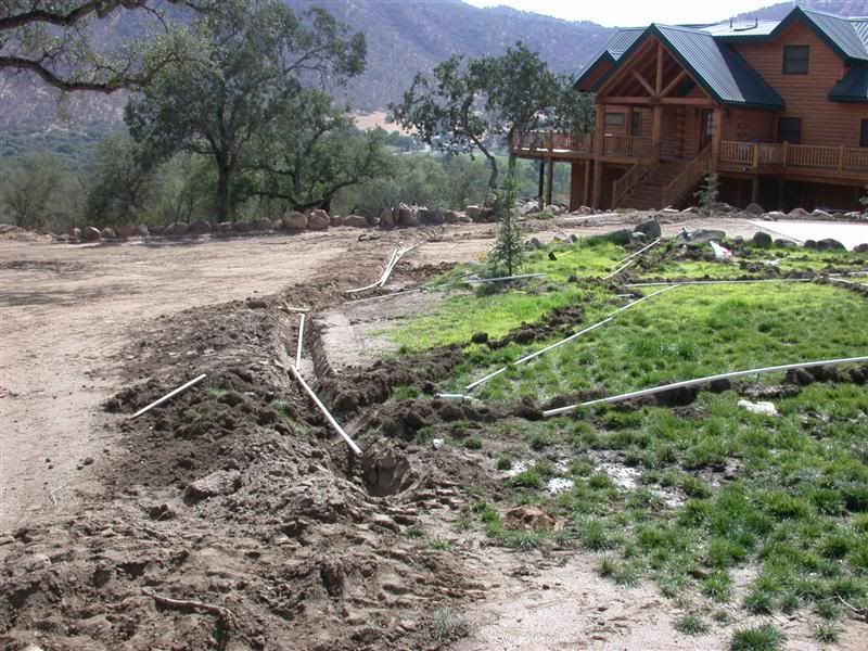

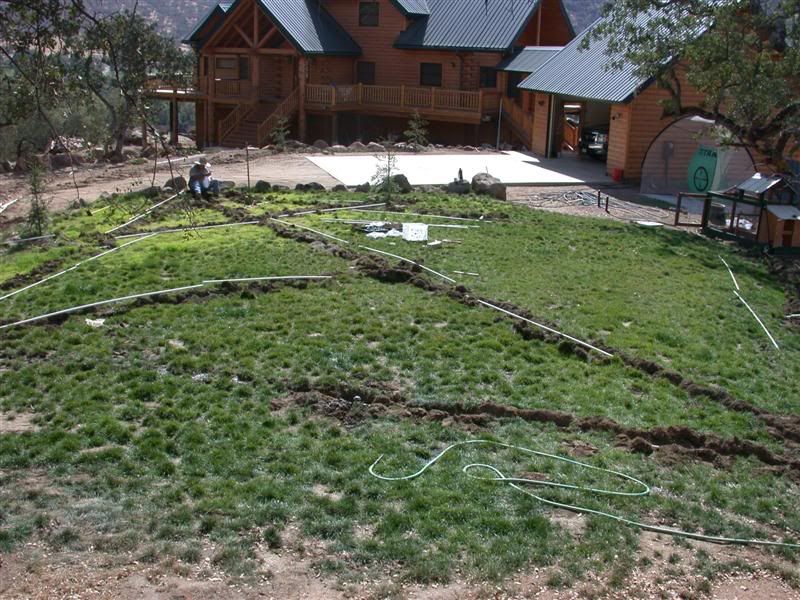

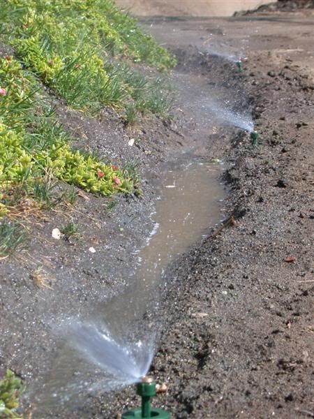

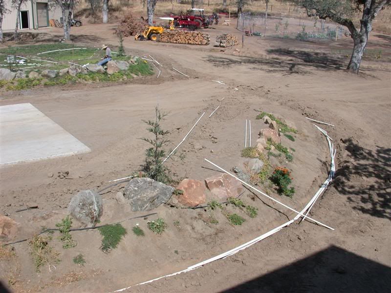

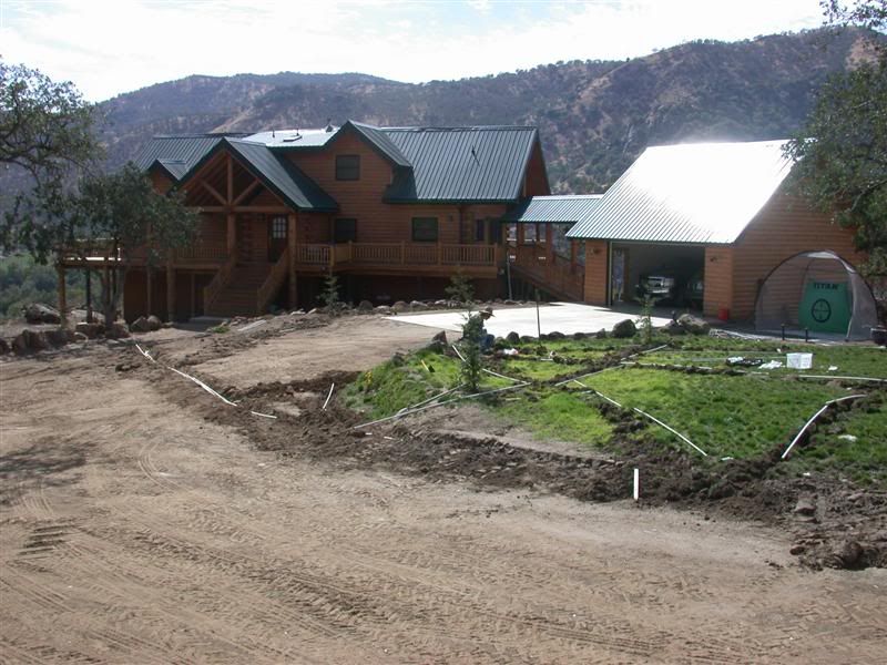

Once I got all that going and working, I soon had the PVC in the ground.
You know those valves I installed all around the deck of the house? I added a new set to control this lawn and flower bed area.

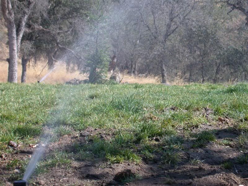

I will have to tell you that after finishing all the PVC, the dang 1/2" feeder lines were too small and I had to tear it all up. This was a little frustrating to me since I had calculated out what each sprinkler (theoretically) should take to work. In fact, I changed the 1/2" out to 3/4" and it still didn't work adequately ... double dang!!!
So I tore it ALL out and put in 1" PVC and that was the ticket.
Yeah, I know I'm a hard learner...

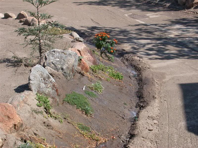

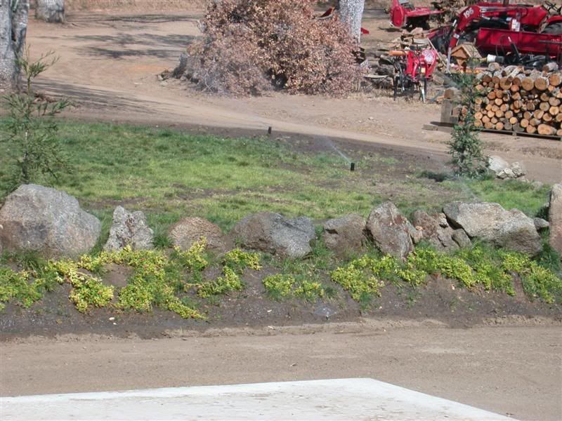

I'm sure you're enjoying it even more than I did.:D But finally, here are some photos of the sprinkler system working. I can run all lawns and flower beds at the same time now. That really saves on energy that the pumps consume. Now we can lay down some serious water in a very short time. The south lawn and those flower beds are next for the irrigation, but I'm taking a break for a little bit before starting that one. Our goal is to be able to actually grow at least some grass and few flowers around here.
