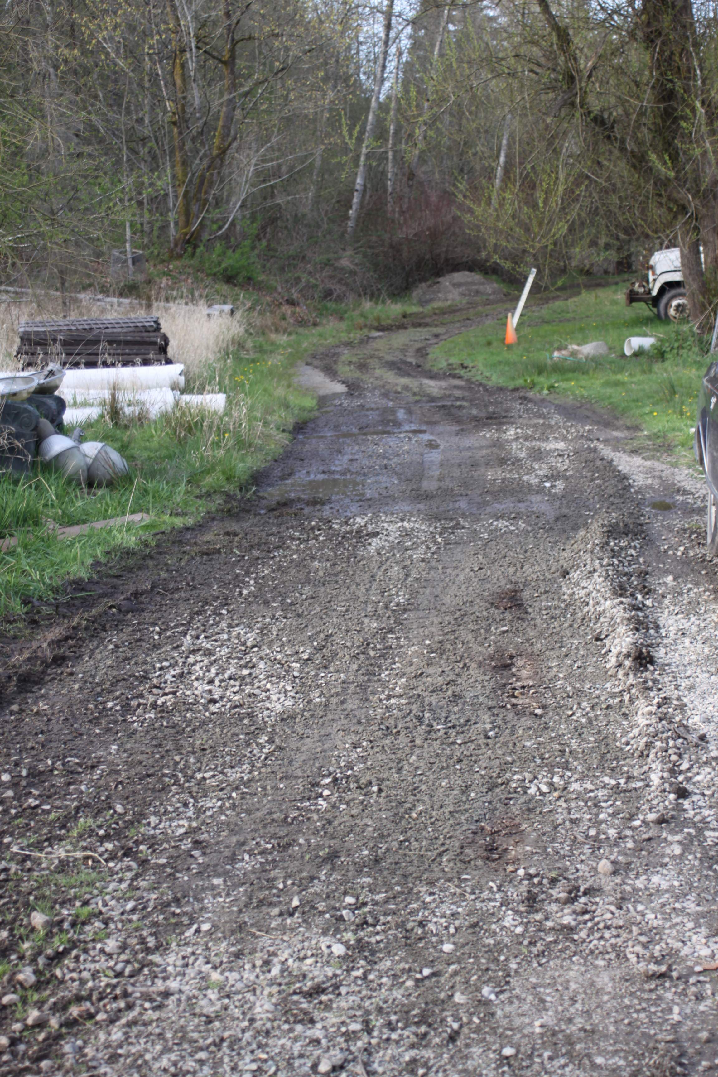

Good to hear from you on what's happening at the house. I have some sprinkler parts at the ranch and will try to remember to get you some pix on how the poly works to remove tension from the PVC if the sprinkler is run over or hit. As I used to work road construction building traffic signals, I used to salvage all that stuff for use on the ranch rather than letting the GC throw it in the trash. Used to bring a lot of plants home too. I managed to salvage about 400ft of 12" PVC pipe for culverts off one job! It was from the old storm drainage system which was being replaced and moved to the new curb line. They were uncovering it with the trackhoe, and then using the thumb and bucket on the maching to pull the sections apart. They came out with absolutely no damage and as full length 13ft sticks! You can see the end of one of the piles on the left side of the drive in this pic. (White pipe)

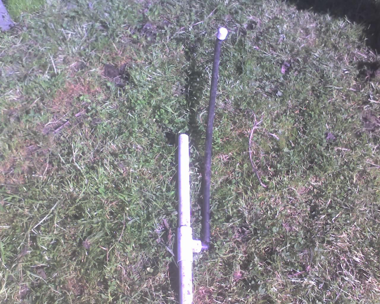

Rob the sprinkler risers Ive put the taps off to the side of the pipe and a elbow with a barb in the tee to another barb adapter then the riser that way you can tweak the riser height or nit use the riser just polly pipe to the head
If the riser or head gets hit bad enough you won't mess up the run of pipe just the 12" of poly .

Here's the picture Rob. The white cap is where the head would go. It's just like tommu56 is describing.

Thanks guys, for the info on the sprinkler set up.
That will work for sure. Mine are already in but if I break one, I will use that method in the repair.
