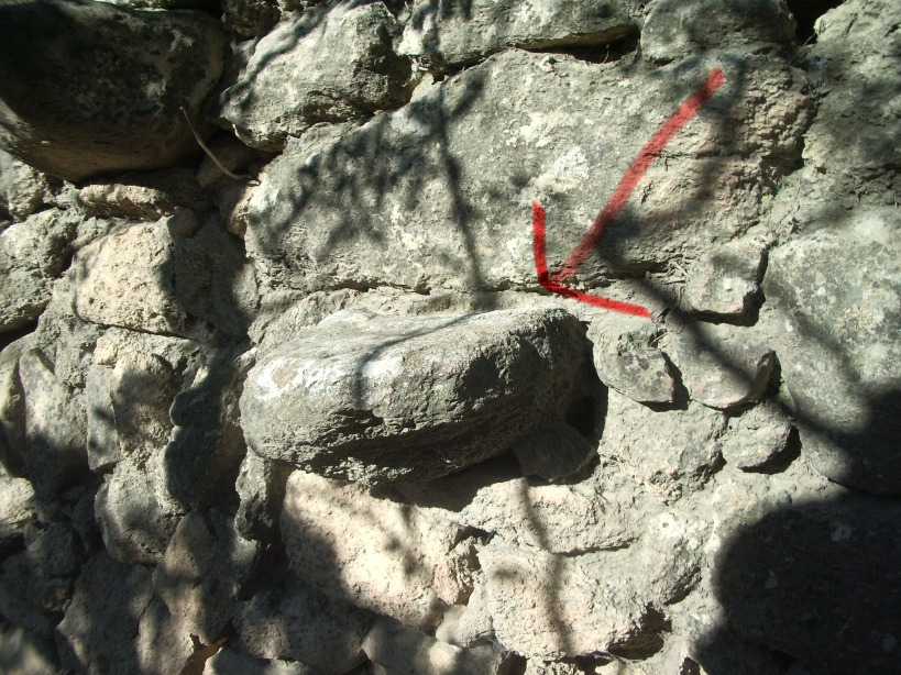

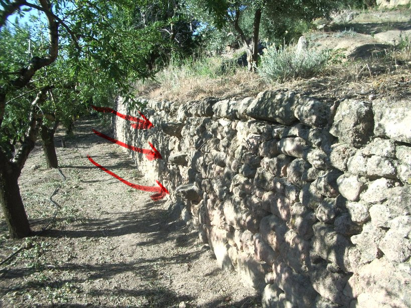

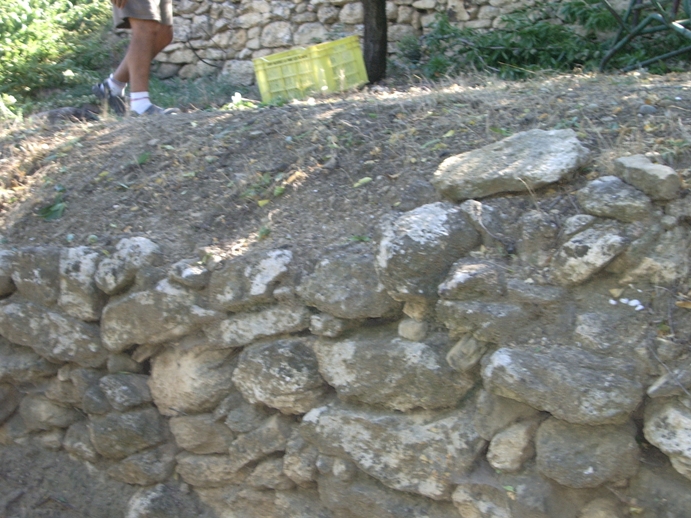

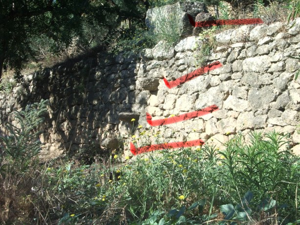

Rob, I took a couple pictures today.
Pic 1 is he built in stepsPic 2 is a coseup of one step
Pic 3 shows step in a higher wall and notice if the wall is high at the top fo the stone wall they placed a large boulder so you can hang on to it to lift yourself up.
Pic 4 is showing if you build terraces with stone walls be very careful NOT to build up your dirt higher than the stone wall. The previous owner ripped our grapevines and planted Almond trees. Whne he did so, after digging the holes for the almond trees he left the dirt, whihc was now higher than the top of the stones. we ahve a lot of stone wall reapairs to do because with the dirt now higher the wall looses integrity and stones fall out. From experience I would say have your dirt even or a tad lower than the final rocks. Our walls are 200 years old and except where the old owner left the dirt higher than the stone wall they are still very solid. No cement either, dry laid stones.

Thanks a million for taking those very cool pictures of your rock walls and steps.
They are very interesting. Incredible they are 200 years old! Building the rock wall like what you've shown is pretty much what I want to do. I want the top of the wall to be at least a foot above the ground to become a visible barrier. The steps I had in mind will be more like a rock staircase leading down to the next terrace. I'd have to be in as good a shape as you to climb up those ones you have.:) I'd like mine to be so I could carry something up and down the steps if I needed to.
