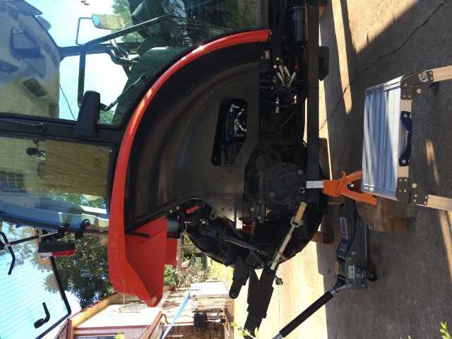

This pic shows the right aft wheel removed to see the access hole where I mounted the servo valve. There are existing threaded holes in the transmission casting that allow convenient mounting of a bracket to support the subplate and valve. This location is also near the loader valve so that splicing in to the power beyond (Kioti calls it "Carry over") is easy.

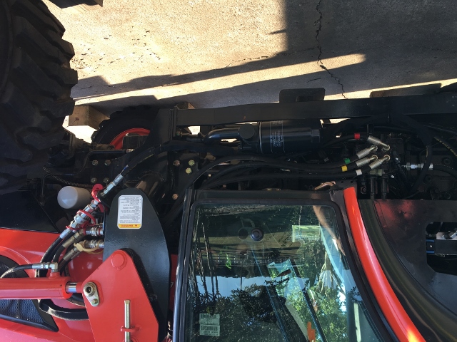

Close up of the servo valve. The power beyond line is 1/2 inch and the working port lines are 3/8.

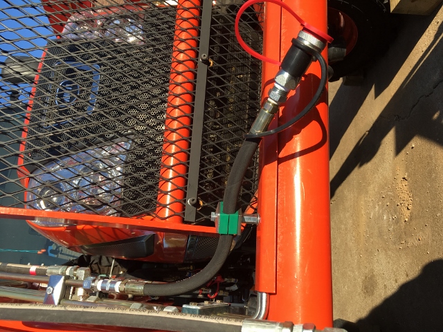

This shows the routing of the working port lines to a bracket that I mounted just below the loader Quick Disconnects.
The Quick Disconnects for my grapple mounted in a simple hose clamp. Nothing fancy.
