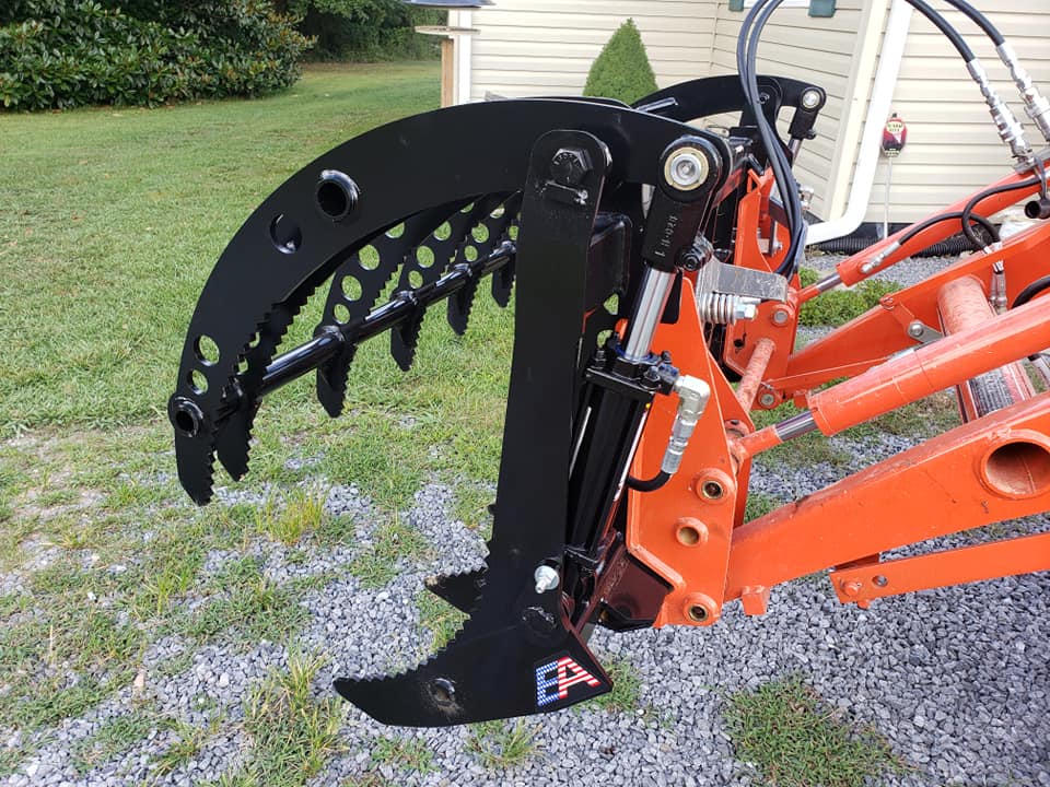

We sell tons of the custom, true 3rd function kits by WR Long. Guys like the easy interface of the rocker switch and installation is a breeze! It comes with the proper hoses and couplers to hook right up to our grapples.

No grapple on the planet will enhance a B Series Kubota's ability like our Wicked 55. Very lightweight, but the premium AR450 steel and thick walled DOM round tubing create unmatched strength as well. Customer reviews for the 55 have grown to a whopping 166, which is more feedback than any other grapple in the industry.

Besides being lightweight and strong, it also keeps the load closer to your pivot pins than any other grapple.

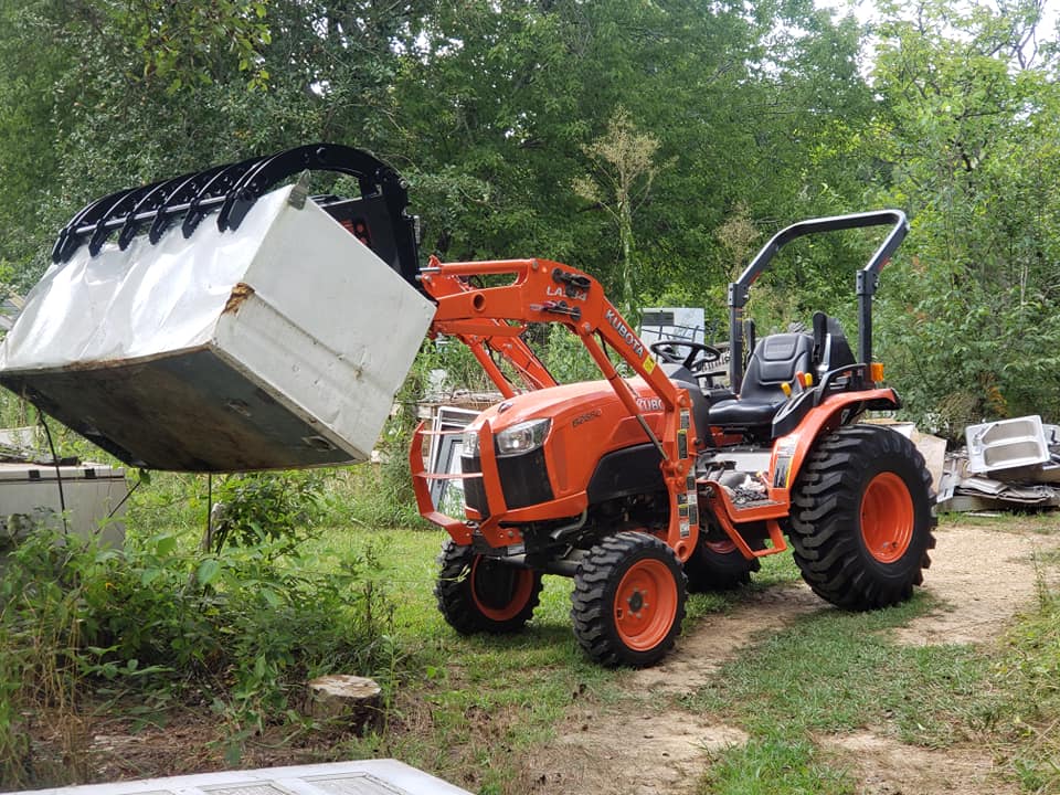

This is a B26, not a B2650, but it is one of the most impressive showings of a small tractor's ability that I've ever seen! I'm talking serious muscle flexing, ya'll.

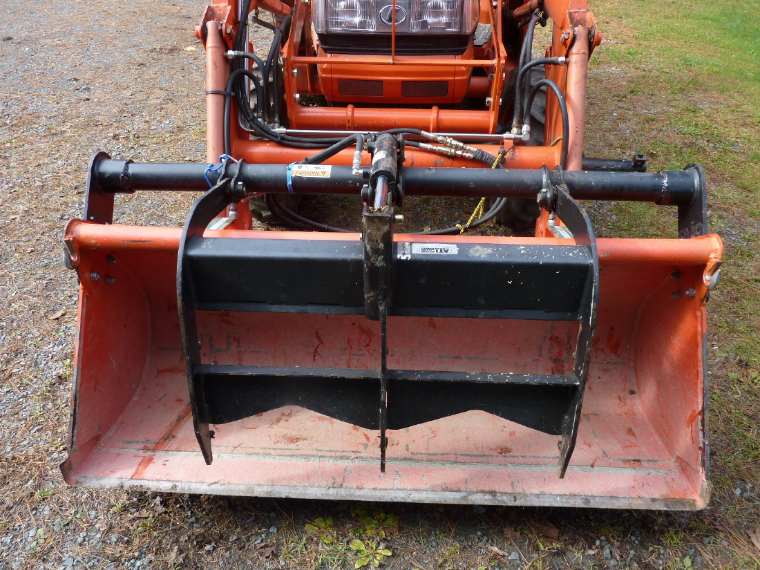

One thing to note on grapples, there are grapples with a single, wide top clamp, and grapples with individual left/right top clamps. You can watch "Tractor Time With Tim" and "Outdoors With The Morgans" on youtube to see the differences between the two. Again, it's operator preference to which you might want. I'm just pointing out the difference. The double top clamp version is able to clamp tight on loads of varying height (such as 2 different size rocks), while the single top clamp will clamp tight on the thickest object and drop the rest. However if all you're ever grabbing is long logs or piles of brush, the single top clamp may grab hold better than individual clamps. Only you can know what's right for your needs.

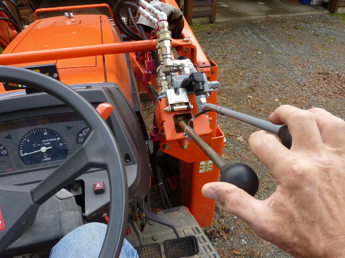

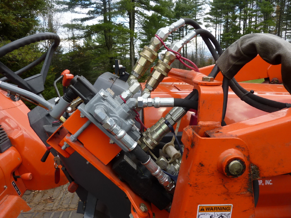

You can use a common DA manual valve and do it for a couple hundred bucks. Even better than a solenoid valve because you can feather it.
gg

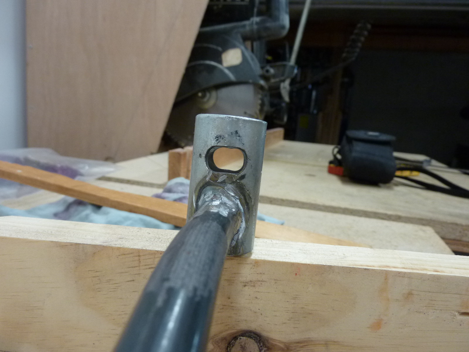

That's a slick setup. How long did it take you to master the dual levers? Also, what's the strap you have hose-clamped between the levers?
I have a bucket grapple on a old pin-on bucket. I made the grapple lever arm so it could swing left and right beside the curl/dump bucket lever so both levers could be in one hand. The strap is a small leaf spring from an ice fishing tip-up flag that holds the grapple lever off the right out of the way when I am just doing bucket work. Then I pull it over to the bucket lever when I want to use both. Easy to use.
