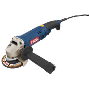

I caught the wife wrapping Christmas packages today, and she did not want to wrap the biggest one, so she gave it to me, It was a Ryobi 4 1/2 angle grinder with the 90 degree adjustable grip and the 3 location handle positions. It also has a no tools guard adjustment and onboard storage of the wrench in the handle. Kinda of a Jimcrack sort of thing, but I used it today and kinda like it.
