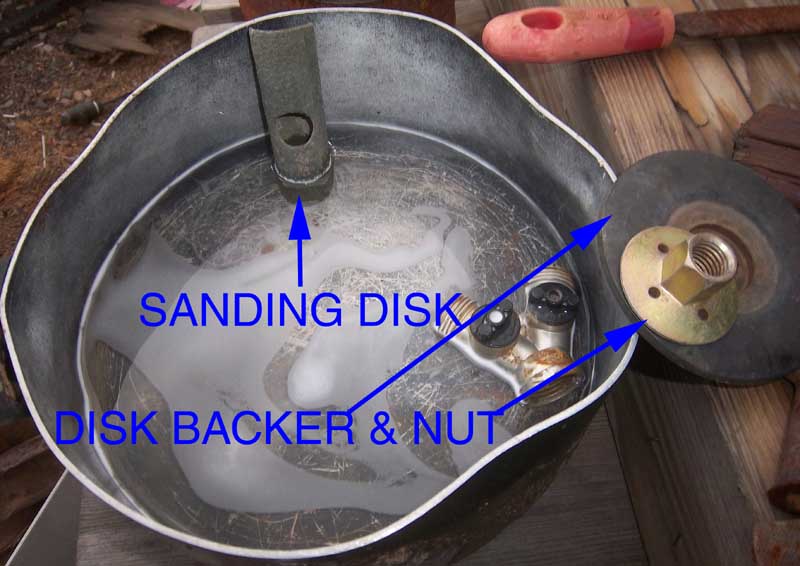

The lock nut has two sides to it, try turning it around so the flat side hits
With the bottom washer on, through nut will not reach the shaft. Without it can not screw the nut down enough to tighten the disk.
Sanding disks curl up or roll up very soon after the sealed package is opened. Soaking them in water lets them unroll and a little weight helps. They are water proof and work wet as good as dry. Don't last as long as a flap wheel, but are very aggressive, 24 & 36 grit.
See Picture
Something that seems common is the flanges that keep the lower washer from turning on the shaft are much 2 short of shallow. On the Porter Cable it often slips on to the round and really locks up. Big Pain.

... On the Porter Cable it often slips on to the round and really locks up. Big Pain.
I had one of the cheapies lock up good. It wasn't a HF one. It was some hardware store brand. I had to disassemble the head and put it in a vice and use a pipe wrench to get the lock nut off. Still use it weekly, though.
