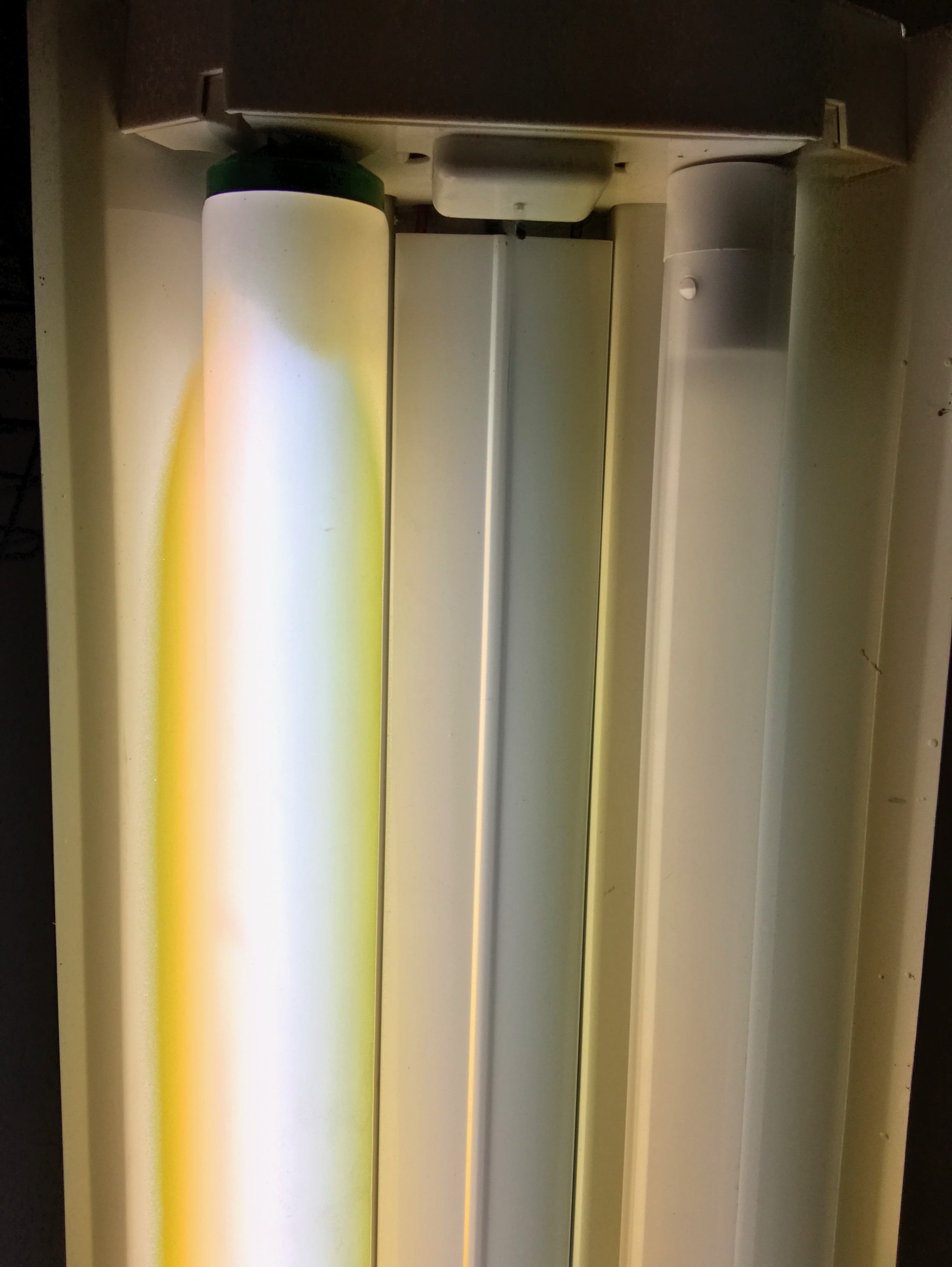

View attachment 523164 LED is the brighter one.
Mixed fixture, T12 and LED 55watt
Double T8 fixture. 55watt
Double LED, no ballast 34watt
When i feel better, ill put the two LED replacement tubes in a ballast fixture and measure it.
Here is my result with Costco LED bulb in old ballast vs. fluorescent. LED is the dim one.
   / 4' LED "shop" lights for ~ $32 at Costco #94
dragoneggs, is this picture the result of old and new tubes in a fixture that has the old magnetic or a 1st generation electronic ballast? If so I would replace it with an electronic ballast to see that difference. What is the rated lumin output of the LED tube?
