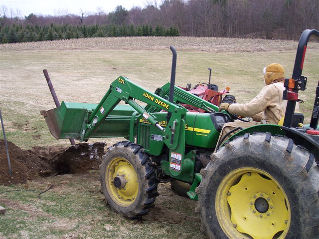

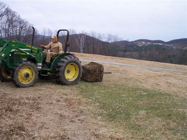

Mornin Z,
Far be it from me to plug a green tractor :rolleyes: But my neighbor Neil up the road from me is someone I have a great amount of respect for ! He is a sheep farmer, originally from North Dakota where his Dad ran a dairy farm. He is an electronics engineer by trade, but homesteads in Vt presently. The reason I give all this backround is to show that he has tractors in his blood. He owns amongst others a JD 5105 as you can see in the attached picture. He does everything with this machine, including a bunch of bailing. He has pulled a square baler for many years with a kicker and hay wagon in tow up in our very hilly enviroment ! The attached pictures shows him towing a large block of concrete for my flag pole that I put in last year. I think I posted that thread before you were on board :) In any event, I would be happy to e-mail you his address so you could chat with him about the machine. I think you will find him quite knowledgable !
BTW The last pic is coming through my field to its final resting place !
