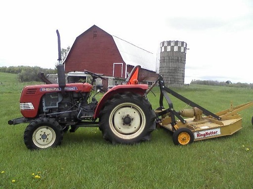

I ran a 4' rotary cutter with a 15 hp Shibaura SD1500AO, and a 5' with a 24 hp John Deere 850. Both were standard duty Kingkutter mowers, and I cut through a lot of tall brush. It doesn't take all that much power to spin up the blades, and it's best if you can ease them up to speed. I want to get a 6' for my 40 hp New Holland, but for now I am using the five footer. It doesn't even know it's back there.
