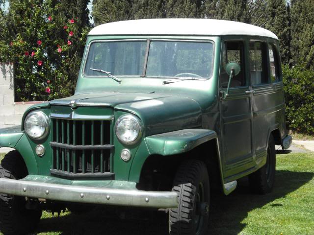

I owned a 1955 Jeep Wagon with a 75hp 4 cylinder and a 1972 Jeep CJ5 155hp V6. When the more powerful CJ5 would get stuck, I would drive the underpowered Jeep wagon out to pull it out. Traction beat horsepower in those cases, I could however go faster in the CJ5 :)
