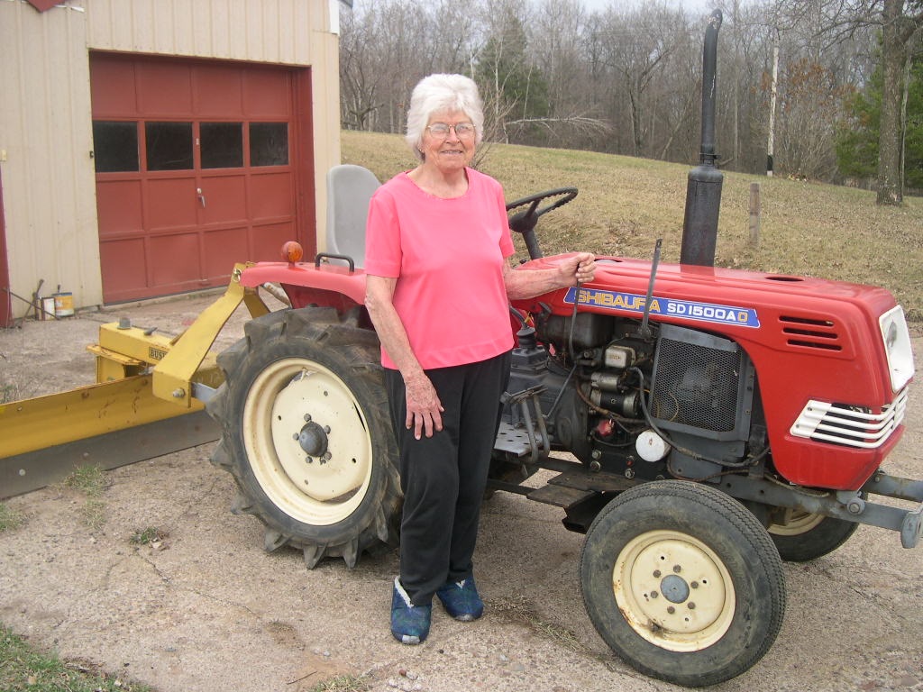

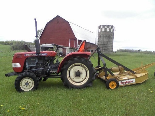

The wheels kept the front end from digging in on the uneven terrain of my trails, They worked great. It was amazing what that little Shibaura did. I literally drove through 8' tall brush with 1" - 1 1/2" stems and cut away. The weird thing is, I would look back and see a deer walking down the new trail about 30 yards back! The 2 cylinder diesel kind of stuttered, and it barely used any fuel. I couldn't believe what a 15hp tractor could do. Here it is with my 90- year old Mom.
