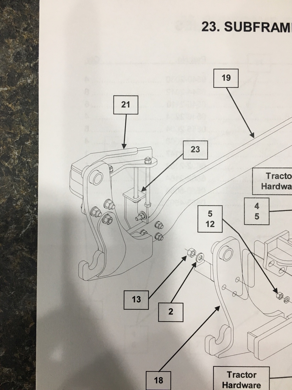

Not sure how this happened, but the subframe has sheared in 2 places just above the lower mounts. Is this frame cast iron? Is this reparable, or am i looking at a new subframe. Tractor has 70 hrs on it, and very little backhoe use.
The set up on my 2538 is similar but the bracket that the backhoe seats into looks like it could be removed with 6-8 bolts. It is all mounted to the subframe. It doesn't look to be anywhere close to a $1000 part per side. Part 21 on mine, Top Plate Assembly RH or LH.

My only comment again is the reason the frame broke is: the load exceeded the design strength . That you have to agree, the reason that happened load was transferred because of a reason. Still go back and check all the bolts attaching the mounts to the tractor if non are loose- the failure was from operating in overload.
No BS just practical science. I am not saying the design is wrong just the load exceeded the design.
