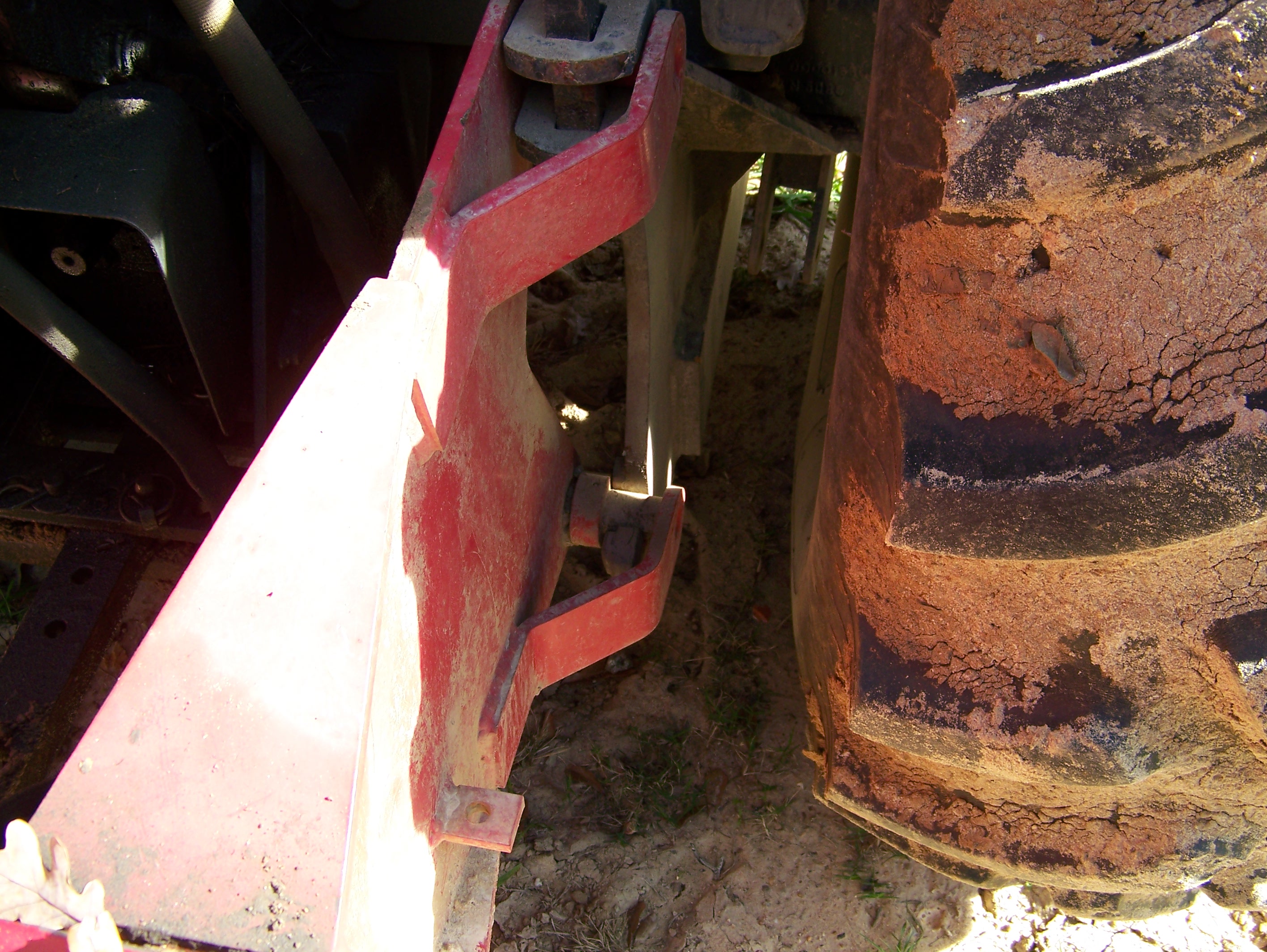

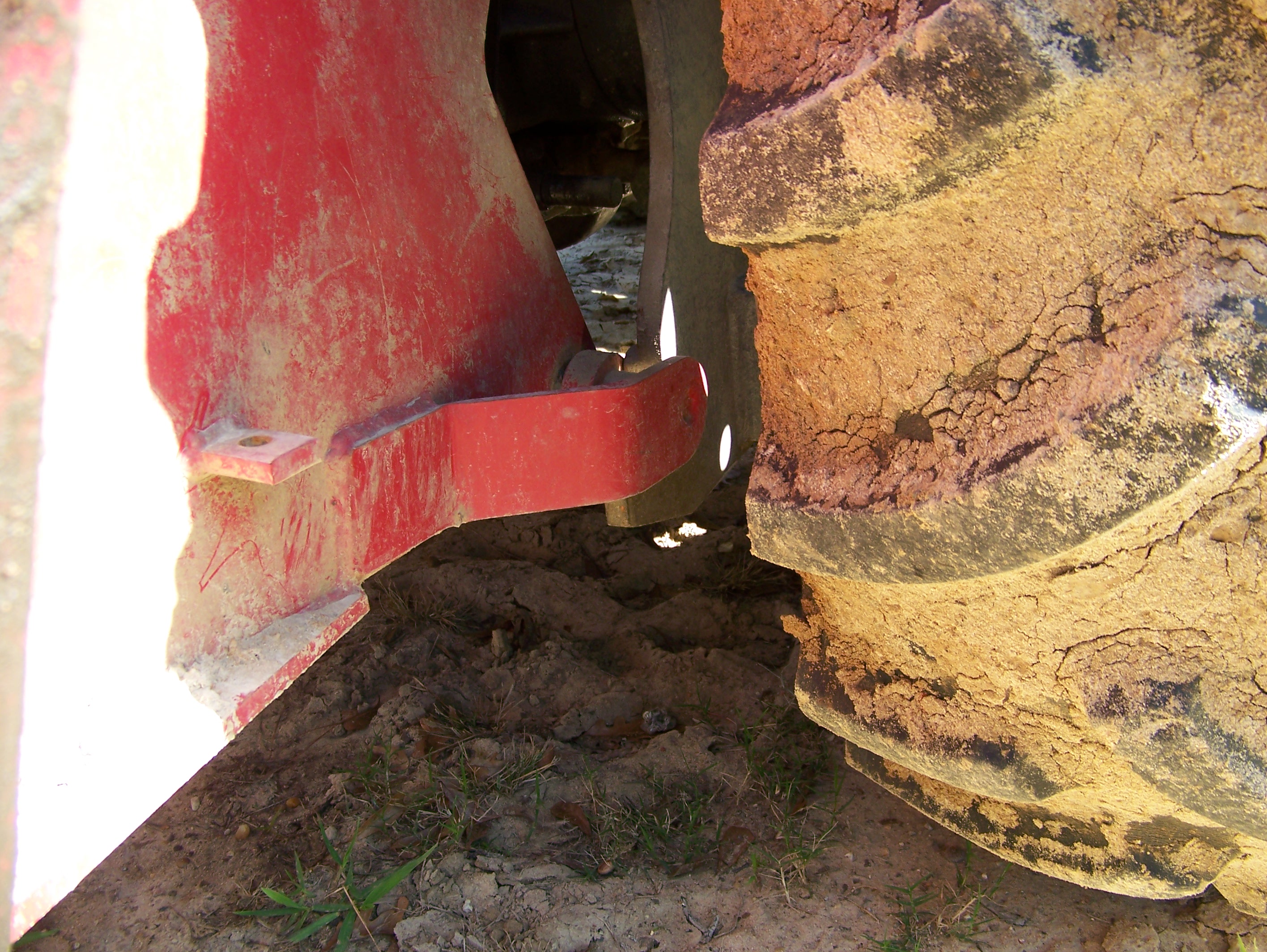

Not sure how this happened, but the subframe has sheared in 2 places just above the lower mounts. Is this frame cast iron? Is this reparable, or am i looking at a new subframe. Tractor has 70 hrs on it, and very little backhoe use.
I am sure about how that happened ..... It just happened to me, same tractor, same BH, same break ....
1 or more of the bolts on the top back mounting plate for the subframe loosened .... This allowed inordinate stresses on the subframe where the BH mounts.
Hopefully I can get the subframe welded this week.

bmohr1954 is probably correct, the bolts up higher were likely loose. Has the original poster commented on whether the bolts were loose? With all the banter about bulges in tires and outriggers vs stabilizers I may have missed it.
That is a pretty easy welding project. I'd not pay $2000 for mounts if they can be welded up in a couple of hours. Then I'd look at the failure area and see if there is something to do to prevent a repeat. Obviously torque and locktite the bolts that came loose, but perhaps there are other means of reinforcing this area. This is not a hard repair for a competent welder.
