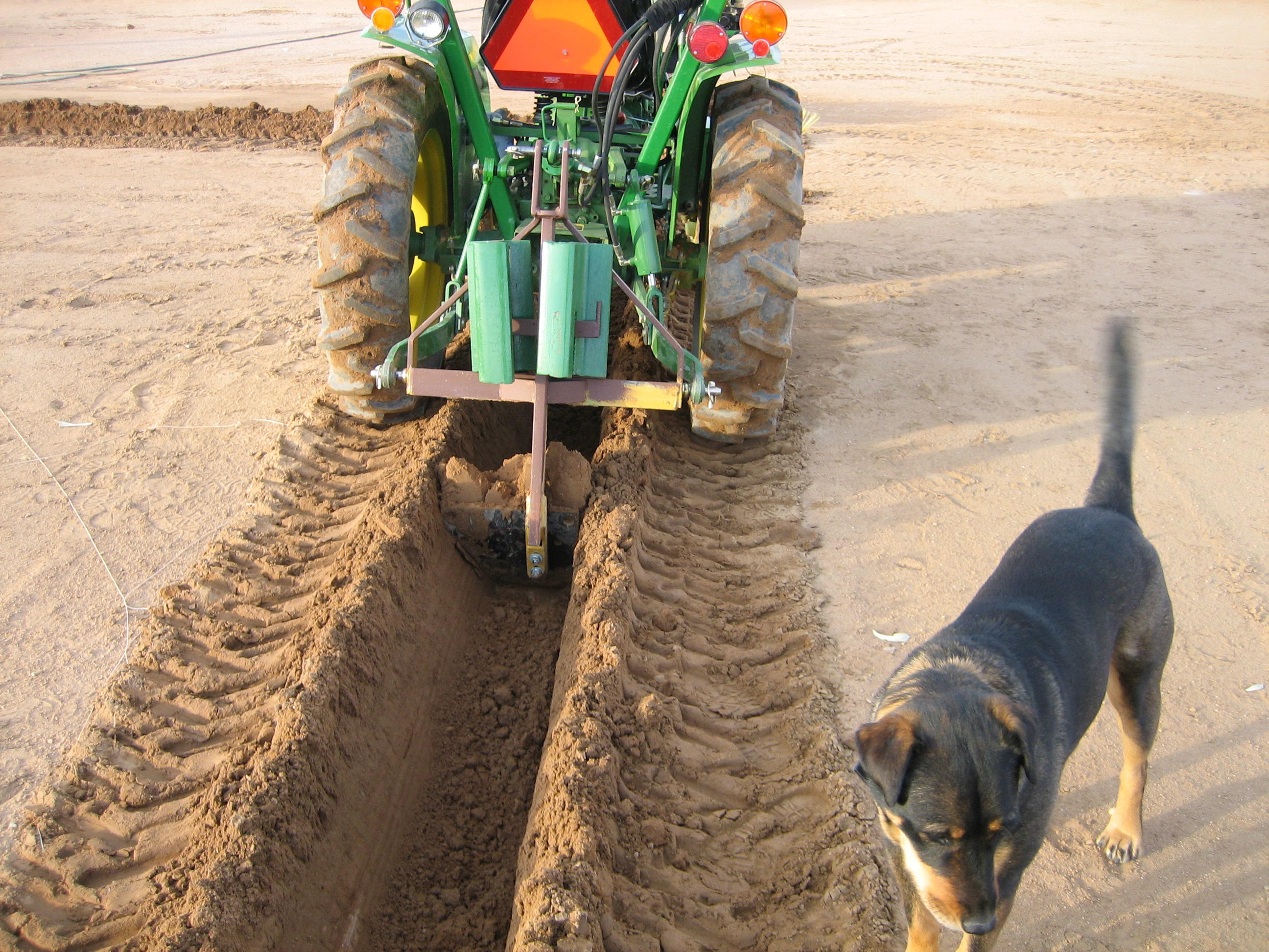

That's a pretty handy trenching tool you have there. I've never seen one like that where you could dig out a trench so nicely!!!! I hate sand, except when it comes to building on it. Then it's my favorite base material.

A little water and compaction and this sand tightens up like a rock.;)

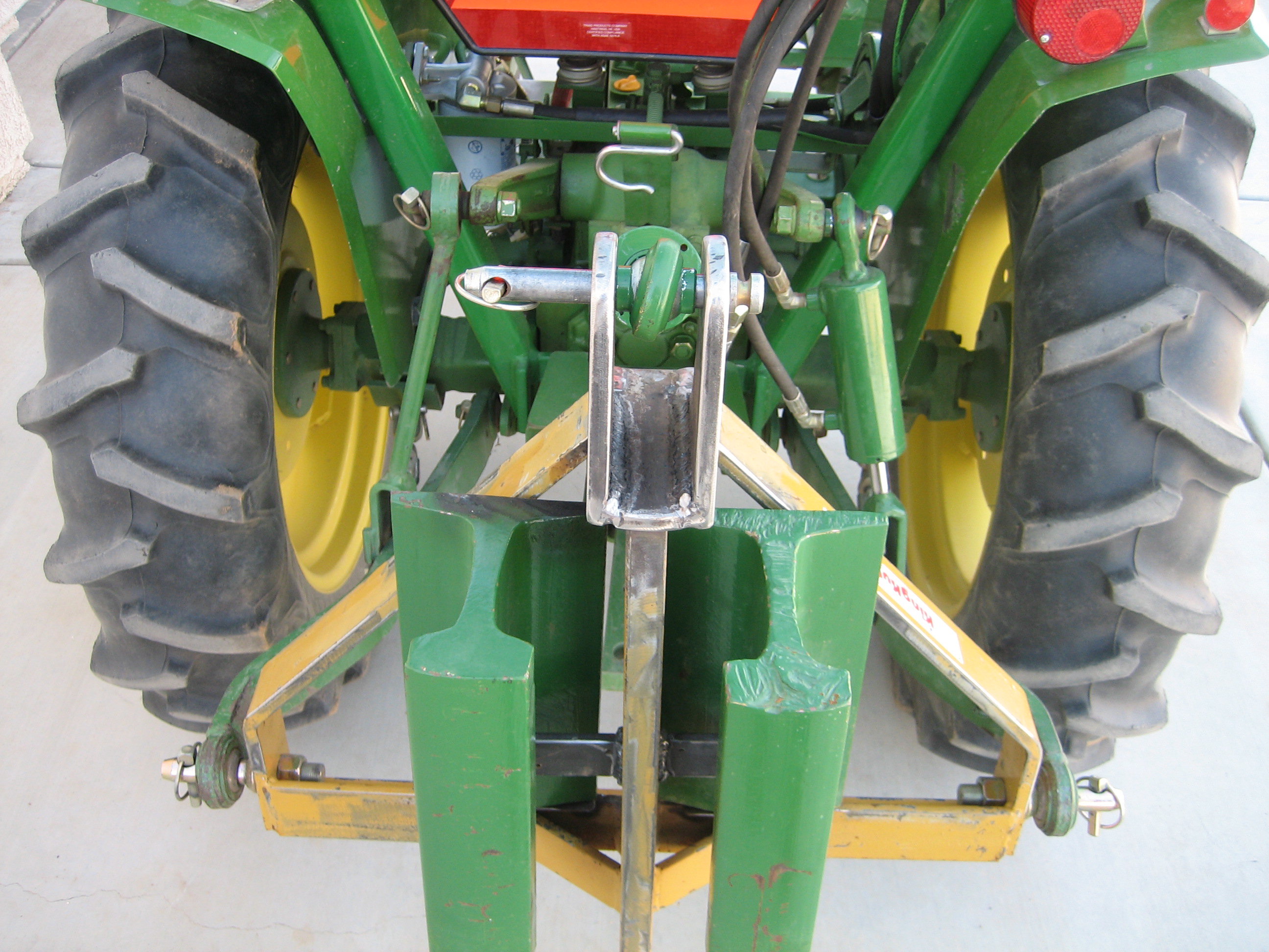

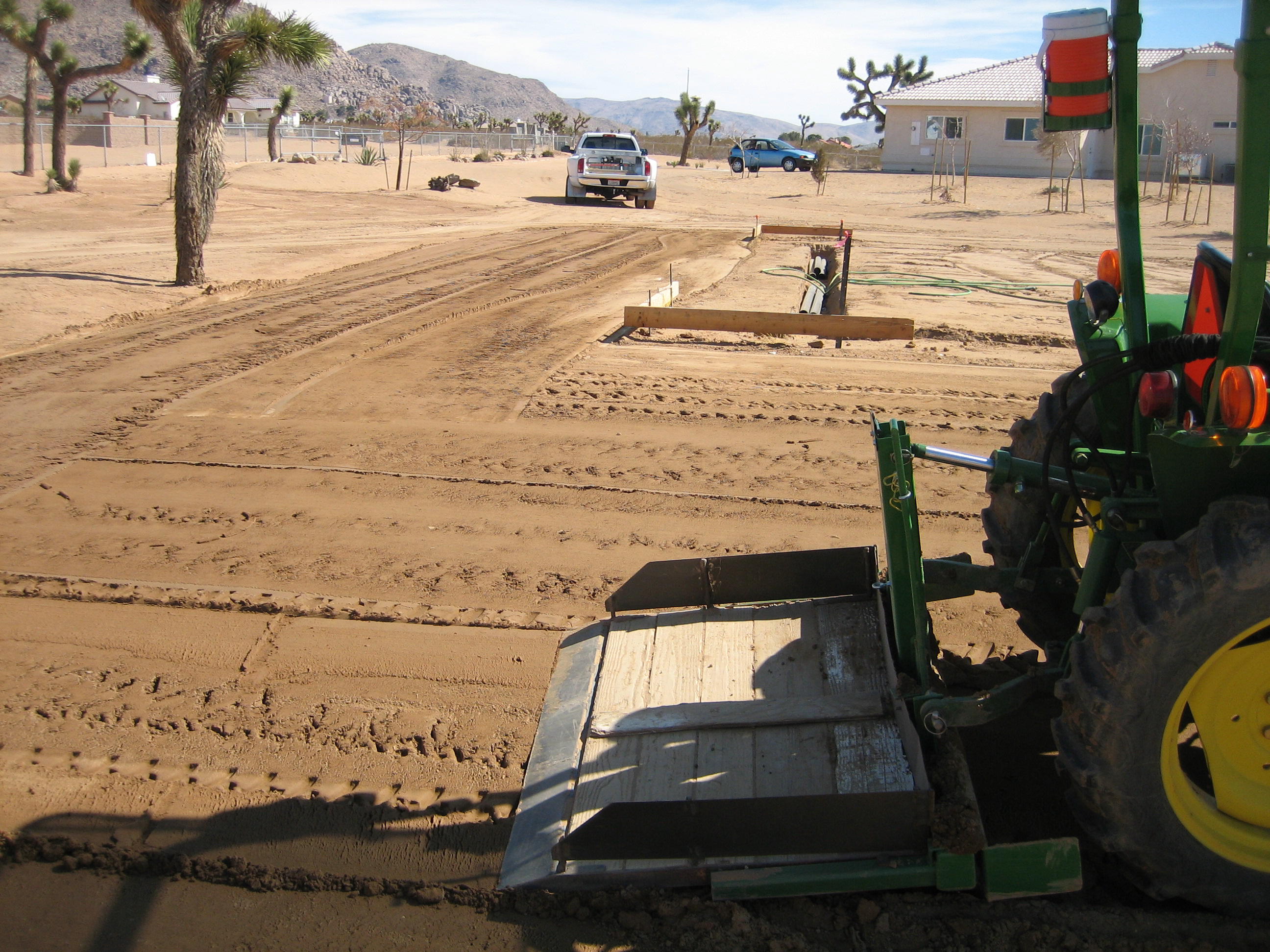

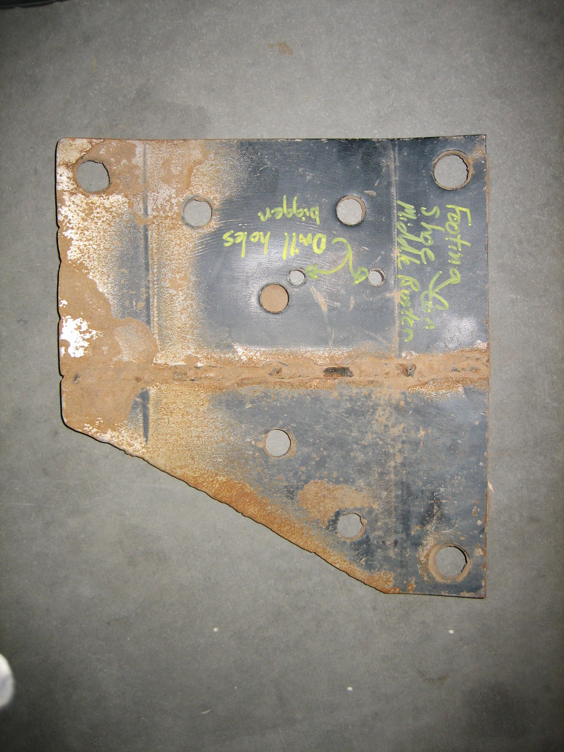

Made a shoe for the middle buster out of a couple 1/2" bus spring perch plates the size of the footing. It worked pretty good. Just minor shovel work. Her are some more pictures. Having a problem getting some pics resized under 1mb. Have more interesting ones to post but can't.:(

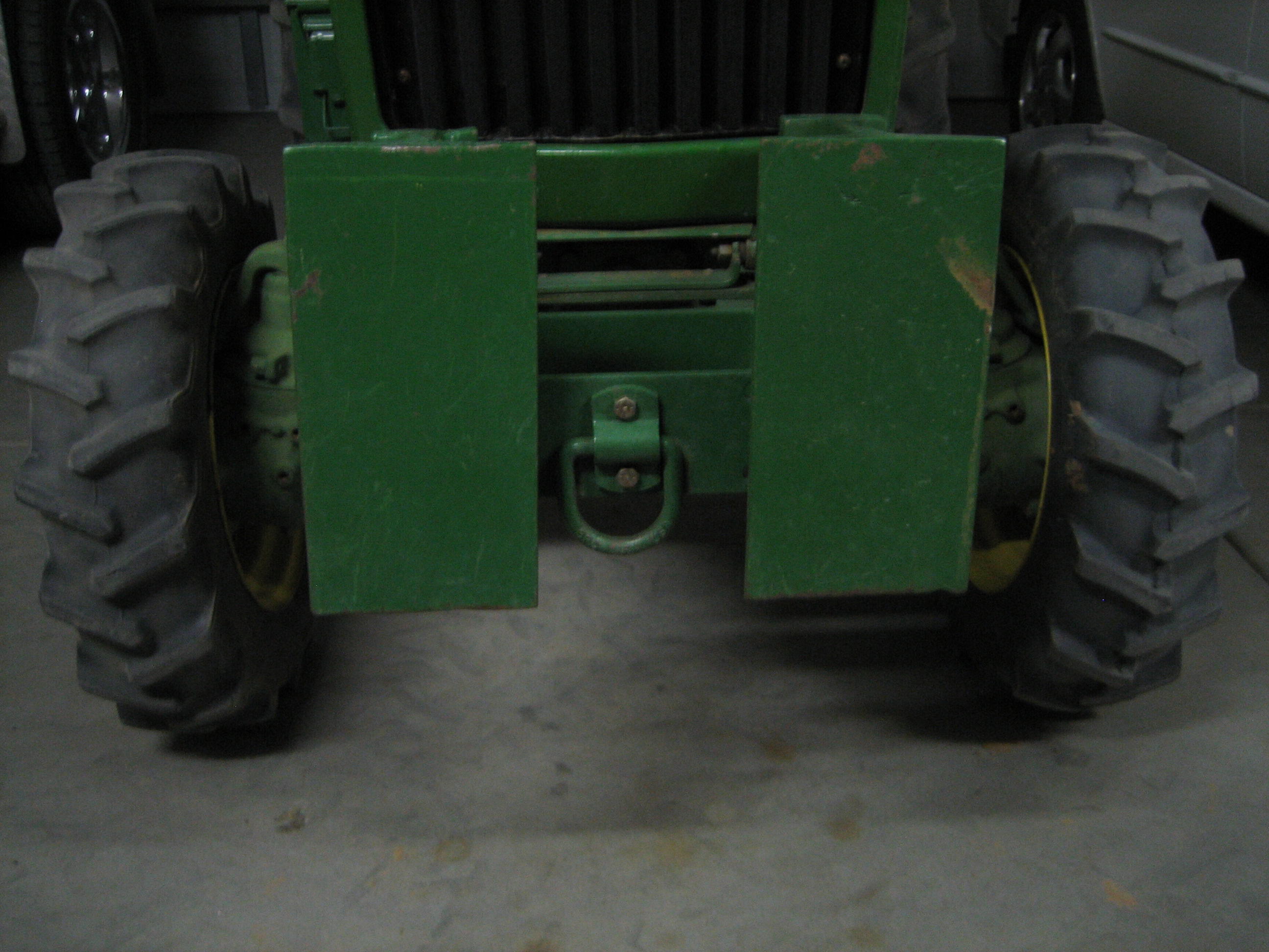

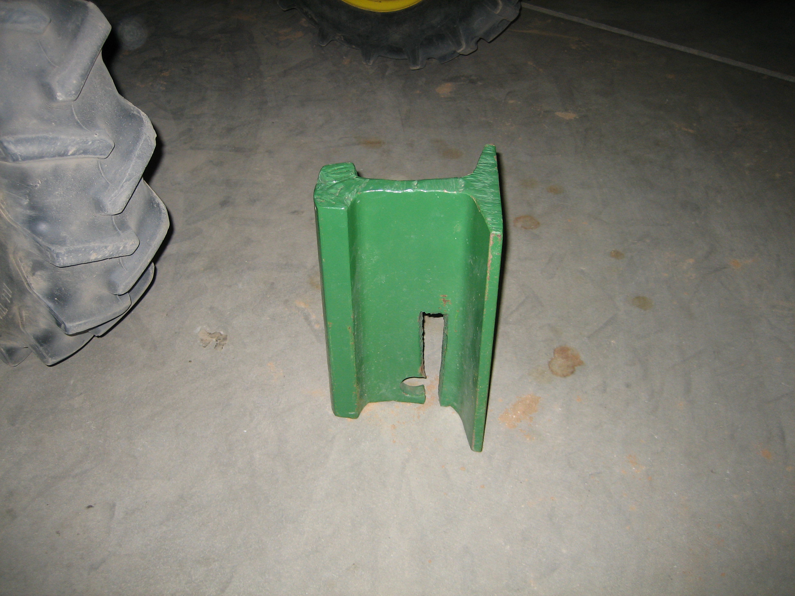

Beautiful scenery. How about a closeup of that middle buster working end and I'd like some info on your front end weights. Think they would work good on my 790.
   / 40x40x16 steel tractor shop
#17
Attached are pictures of the footing shoe for the middle buster made from 1/2inch spring perch plates and the front end weights made of rail track and slotted to hang on the front racket or whatever else I them to. Want to cut some more for the frontend to keep it on the ground.:eek:
