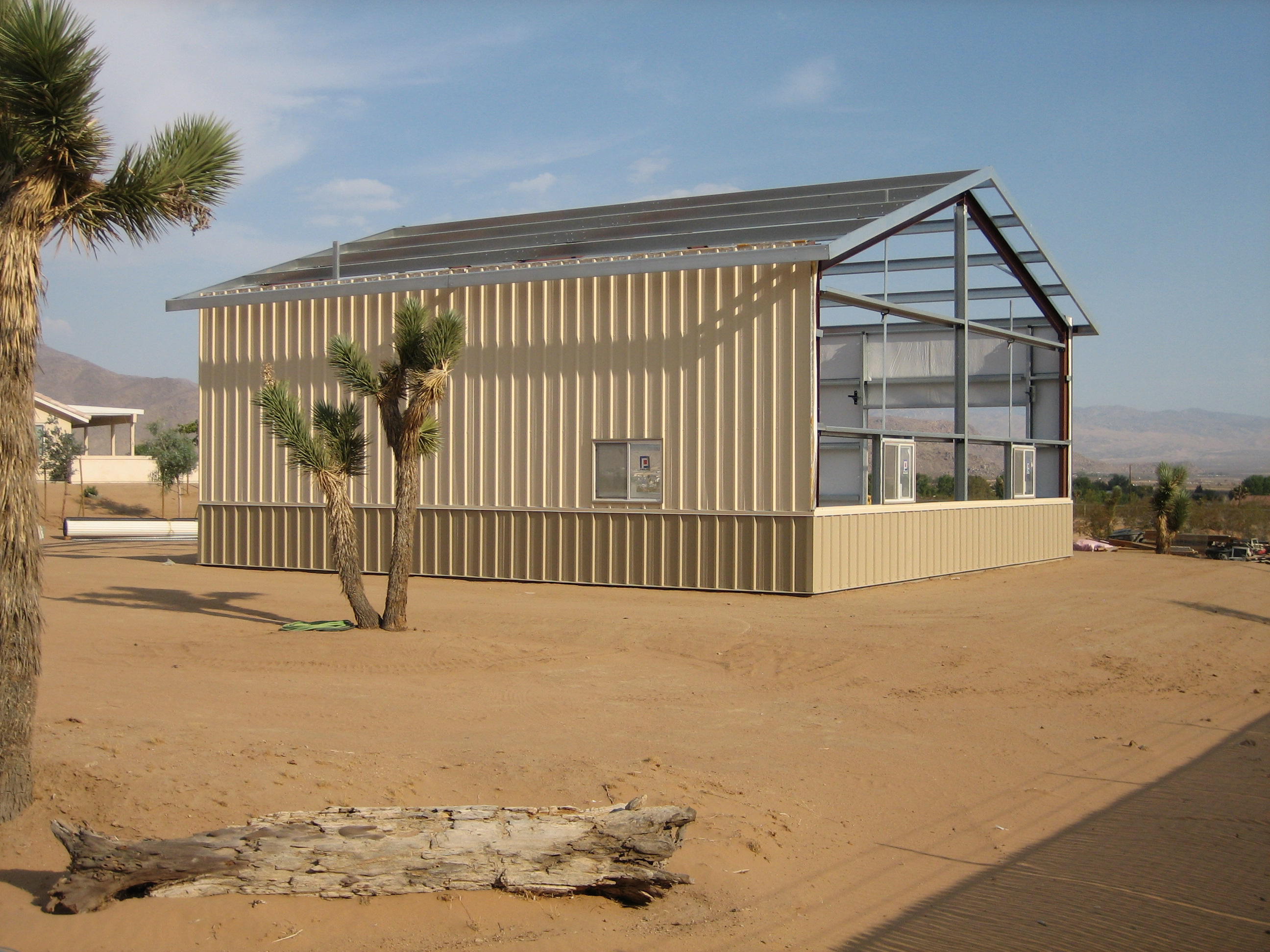

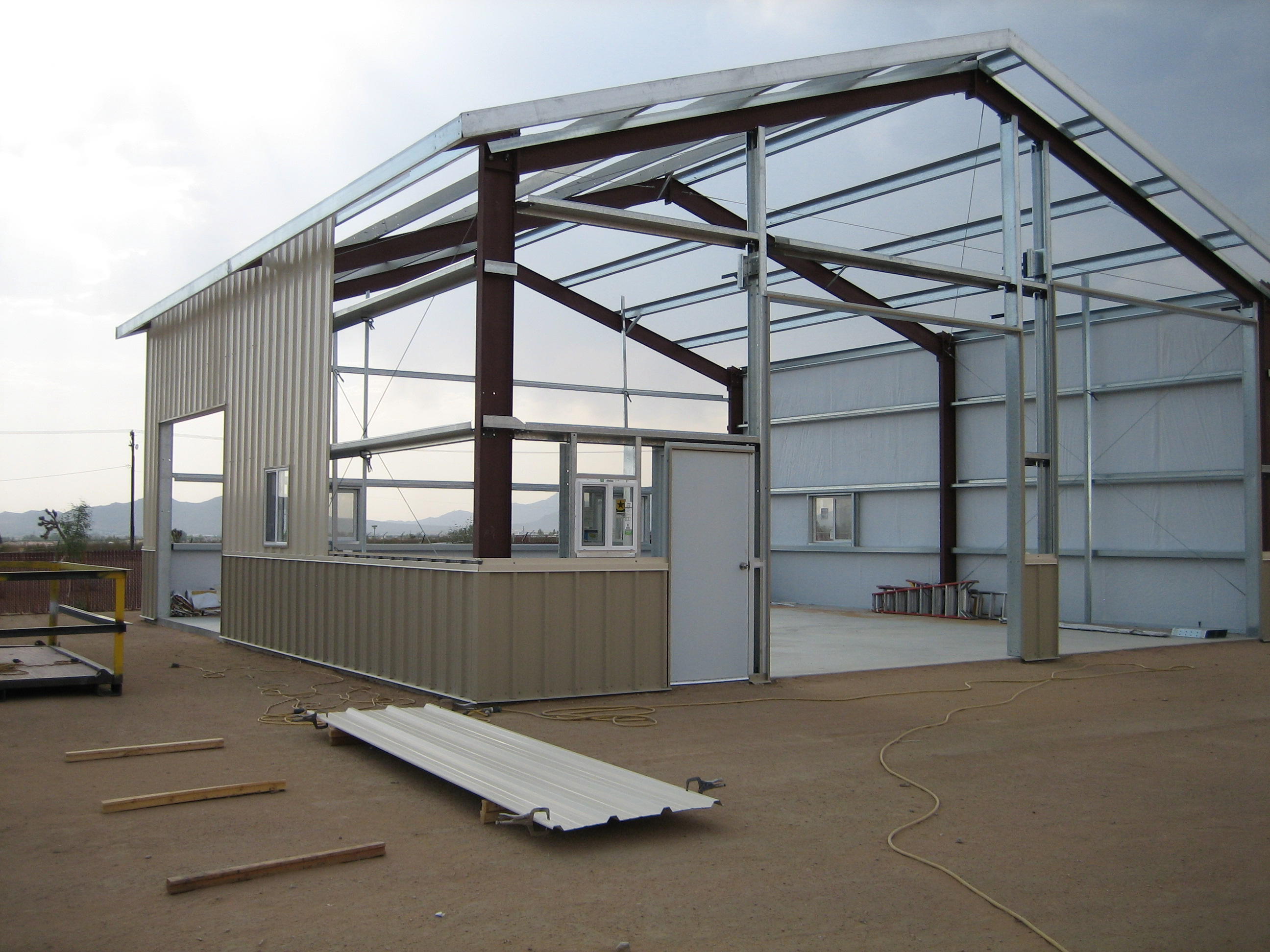

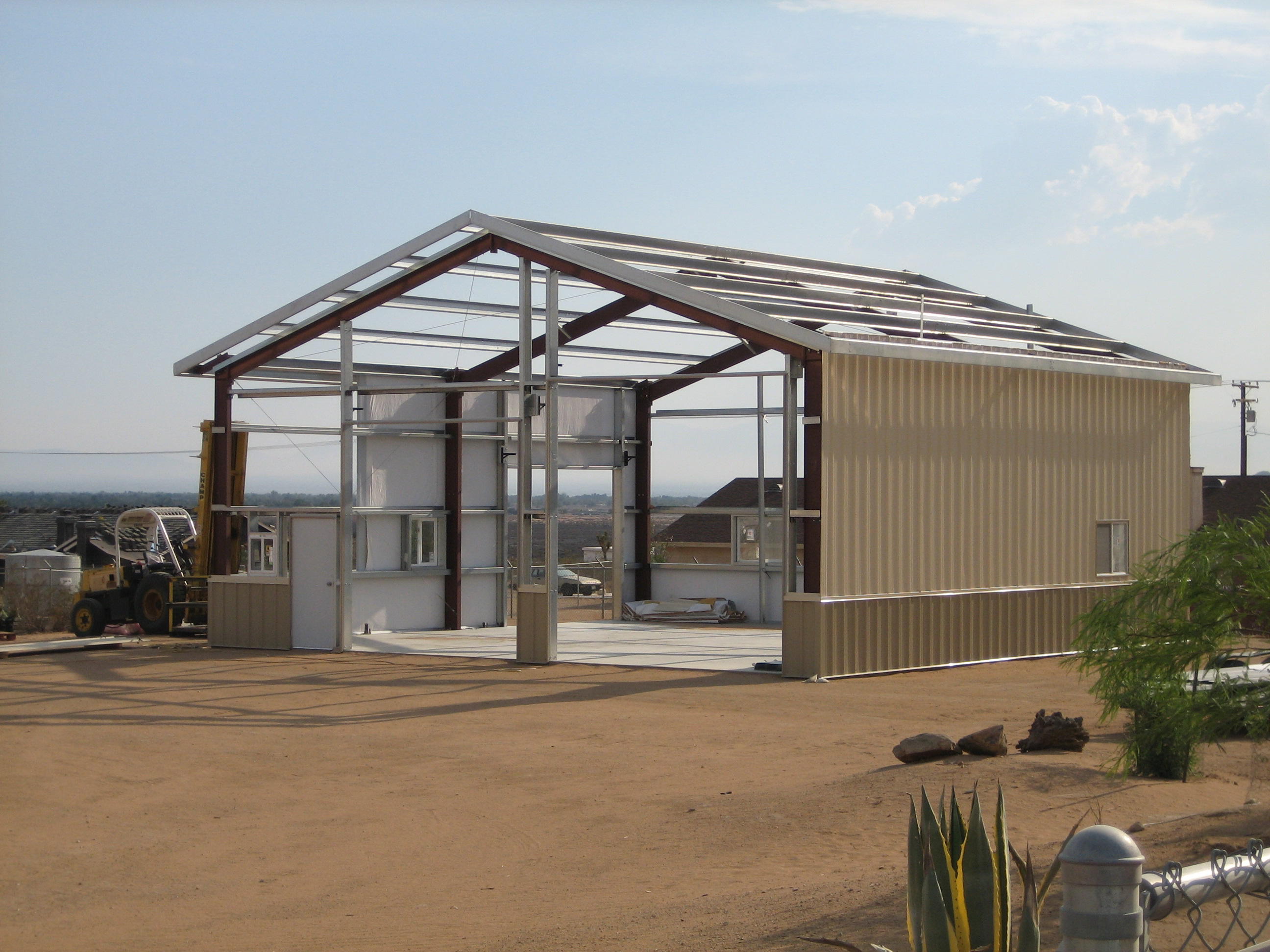

Finally made it back with some more pictures. Got it all framed and decided to hire out the siding of it. it has been dragging out to long. They are doing a good job on the installation.
