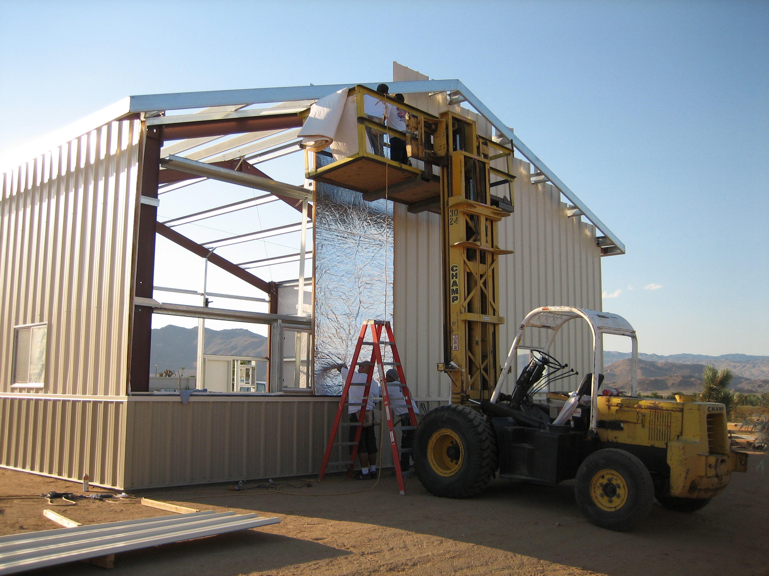

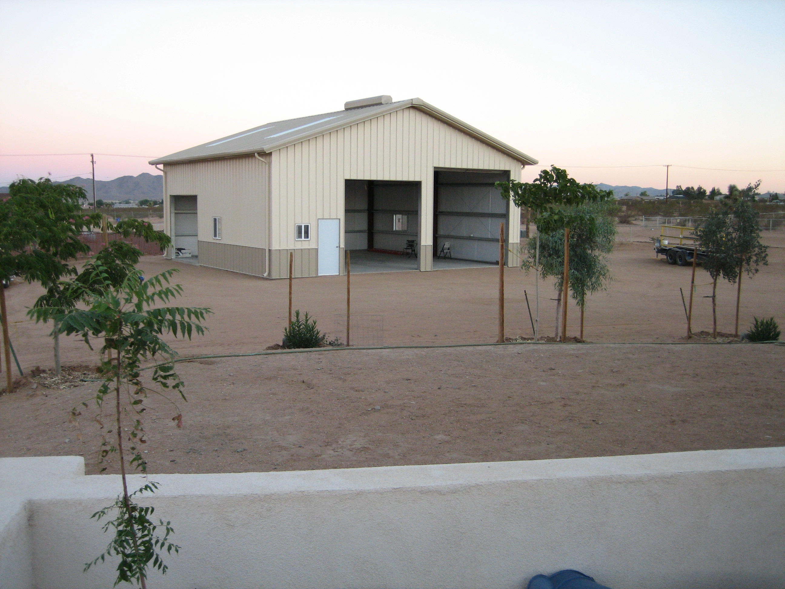

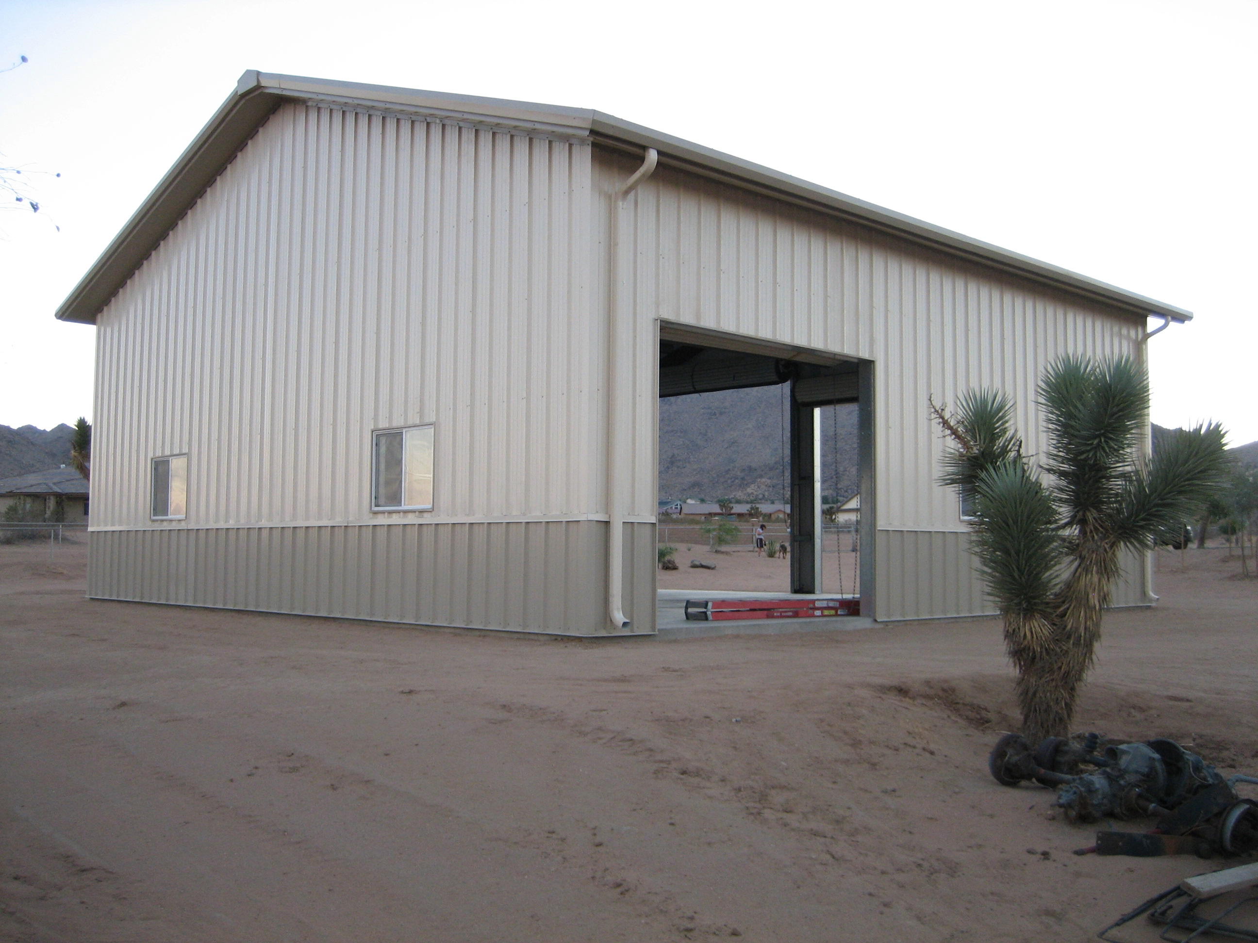

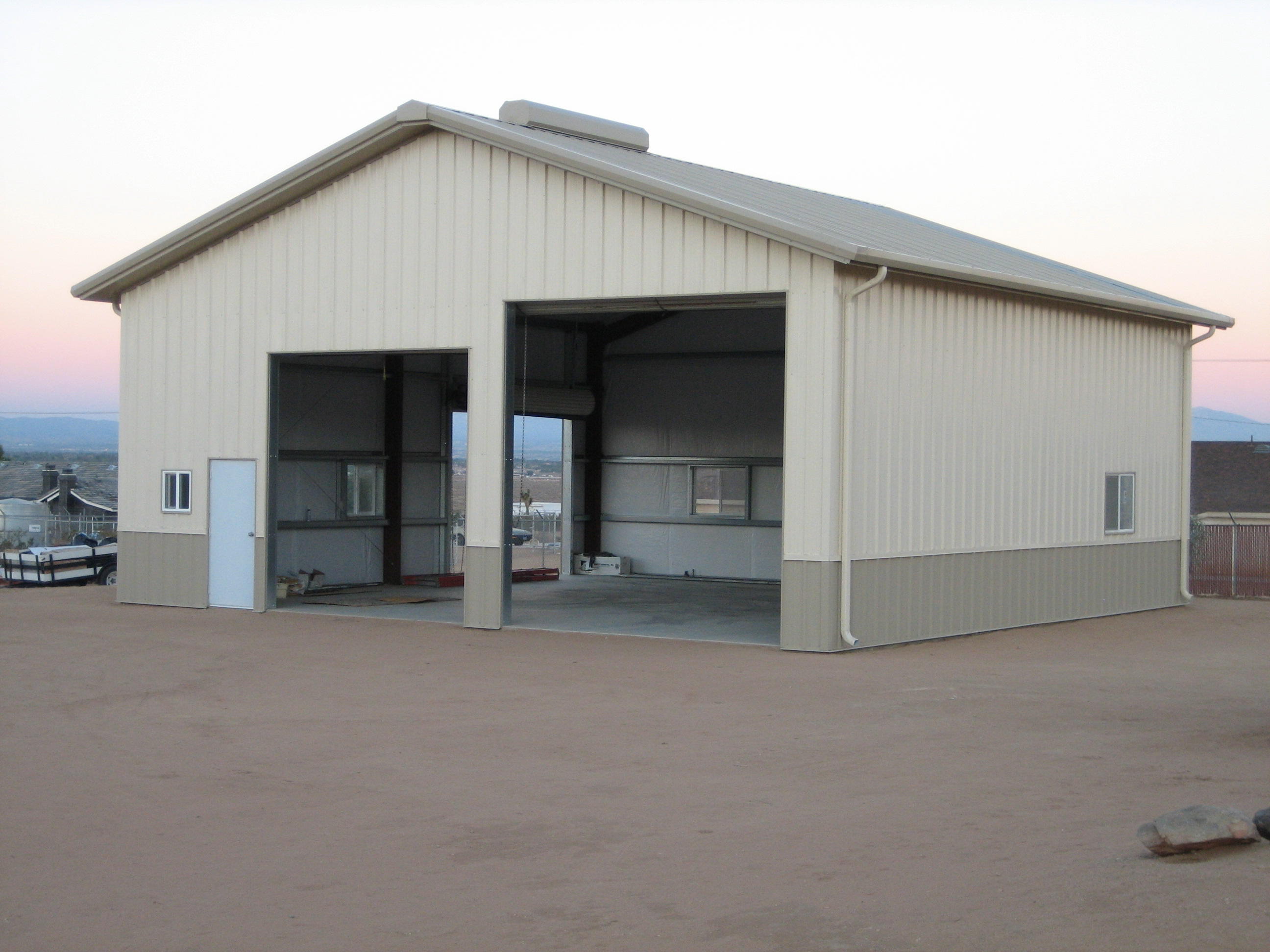

Hired out the siding and it took 4 men 8 days to complete. They said it would take 5 1/2 days. They did a good job but they didn't get paid anymore. Some of the best lesson I learned cost me the most. It had a lot of detail to it. They were 2 roof sheets short so they put a couple different colored ones in temporarily. Should get them next week. Now the work starts inside:eek:

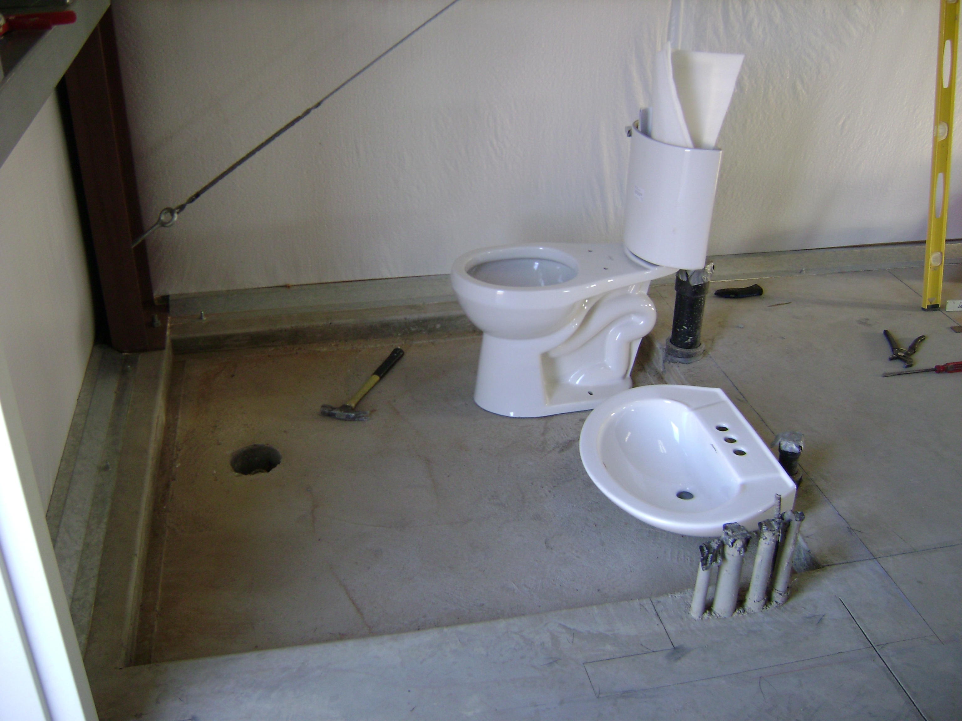

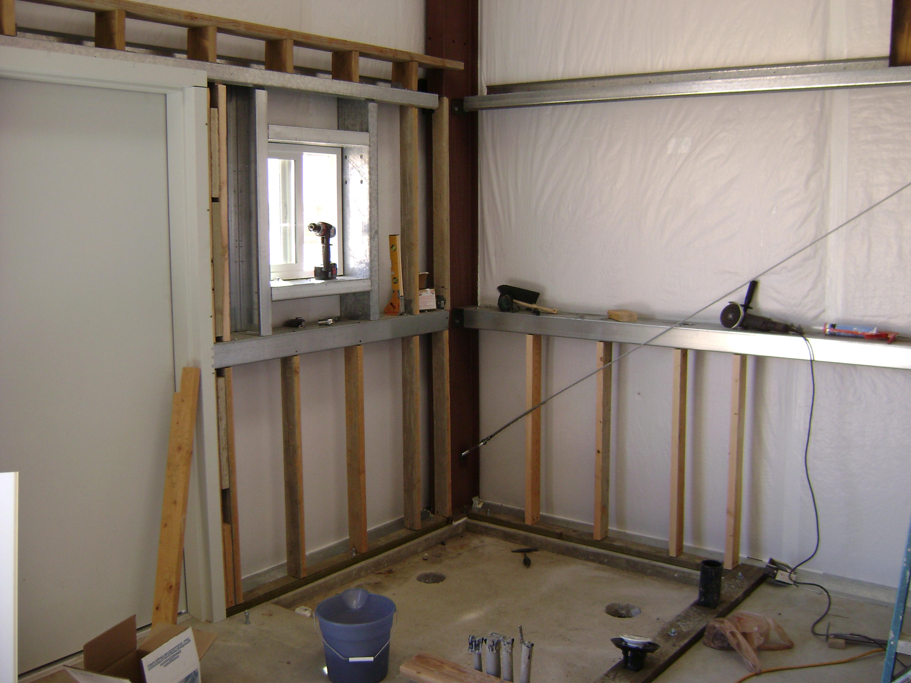

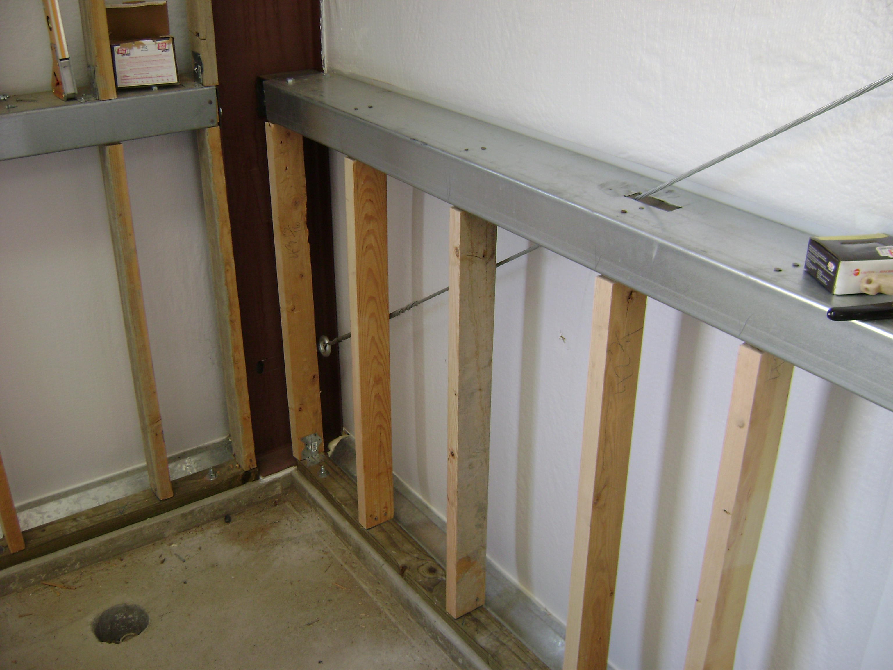

Well, here is a picture of my 750 enjoying her new living space :) and a few of the start on the toilet room. Using recycled wood to stud between the girts. Moved the one cable brace to the inside of the girts space.
