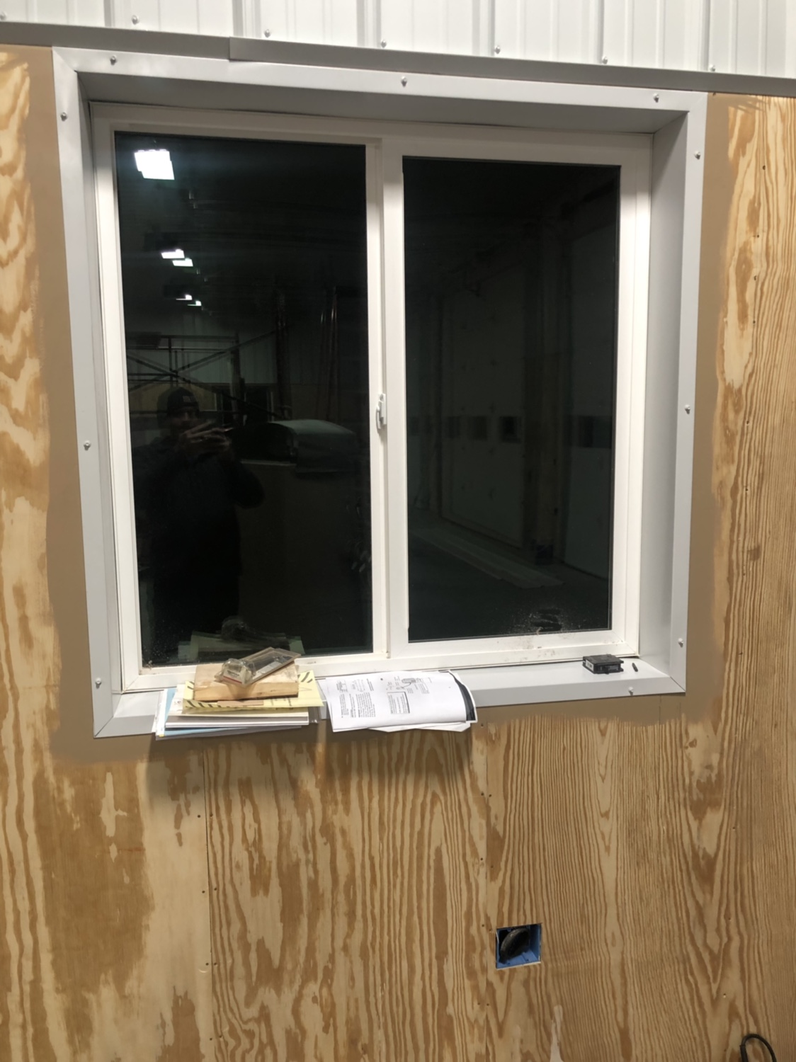

Couple of the windows trimmed in white metal. Oddly, he trimmed the doors in brown. You can see the color that we are going to paint the plywood in this pic too.

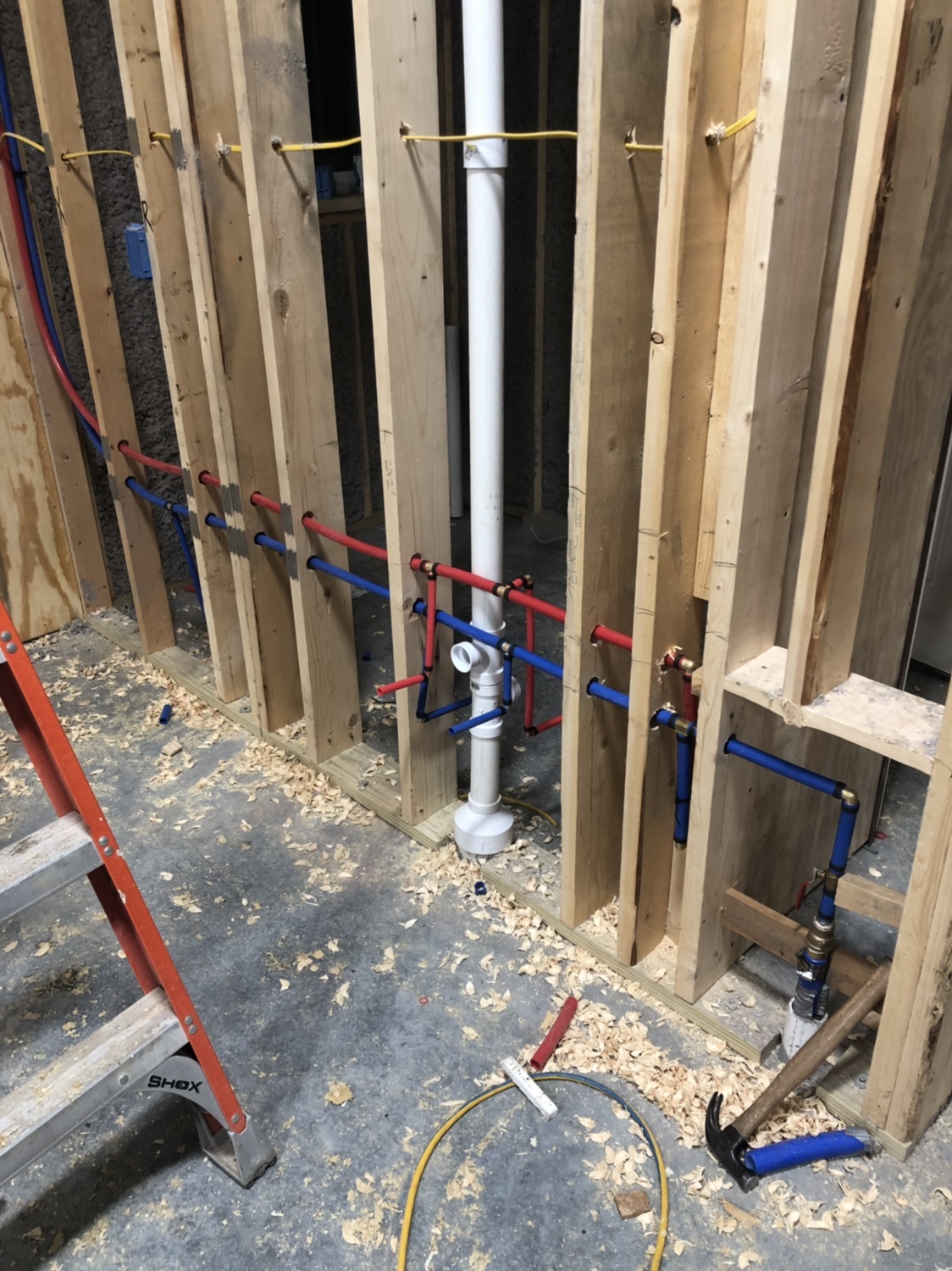

Bathroom plumbing!

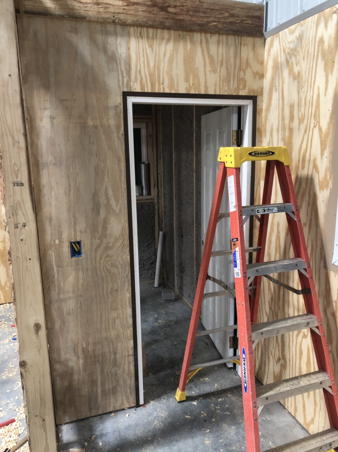

Bathroom entry.

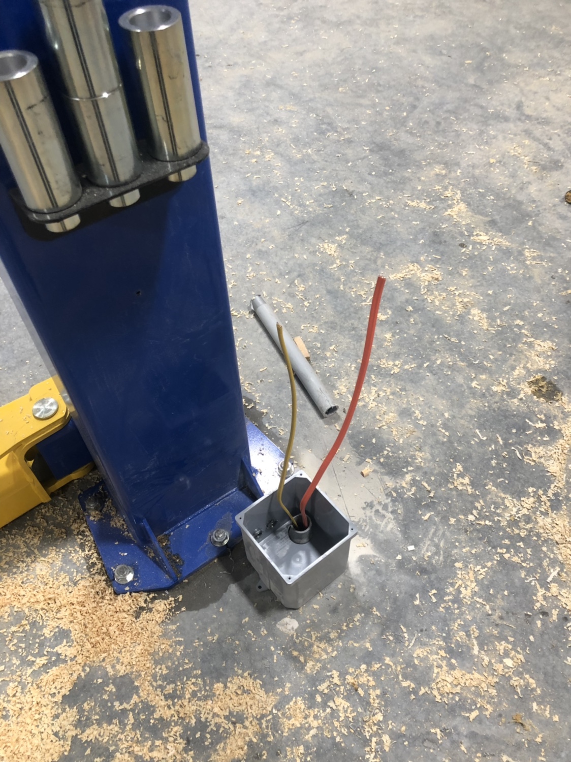

Wiring for the hoist. It’s funny too, I asked him to put me a four receptacle box on the hoist so I had power close. If it was me (and I’m **** sure no electrician) I would have just come off of the hoist wiring and added it. Hoist and electrical box would never have been used at the same time. But he added another wire/circuit to it.

I remodel homes for a living and one of my big pet peeves is water valves that are not solid. Older homes will usually have a nail or two bent over the copper pipe to hold it in place that works itself loose over time. Nowadays with PEX being so common, Brass Drop Ear Elbows are used all the time. Three screws into some blocking and you can stand on the valves and not worry about them.
https://www.lowes.com/pd/SharkBite-Brass-PEX-Drop-ear-elbow-Crimp-Fitting/1000683673
In your picture, it shows the PEX sticking straight out. I'm guessing that they are going to use slide on valves and just leave them flopping around.

Eddie, we're not positive what's going on with the water lines on top of the bathroom. Pretty certain there will be a tank type water heater up there providing hot water for the two sinks below. I can't say for sure whether that is the floor heat source? I don't recall seeing any water lines going from the bathroom to the floor heat manifold area. I don't recall any water lines at that area but Jarid can confirm that, maybe take a pic for future reference.
I haven't looked at this progress in person, just viewing Jarid's pics like the rest of us. I think there's a main shutoff valve on the main line coming out of the floor viewed in the right side of pic #4 "bathroom plumbing". Can't tell how it's secured.
In the center of same pic is the plumbing for two sinks. One inside the bathroom. One outside. As you stated, it appears these will be free hanging. We'll see as the builder progresses.
I totally agree with your feelings about that. As valves age they become difficult to close/open. Nothing more aggravating than trying to hang onto a valve that's hanging while trying to turn it while wadded up under a sink.....
It appears the hoist has a 30 amp circuit (orange wire) and the convenience outlet has a 20 amp circuit (yellow wire), its probably cheaper (in both time and materials) to run a piece of 12 gauge wire for the convenience outlet than to add a small breaker panel on the hoist to have a 30 amp circuit for the hoist and a 20 amp circuit for the convenience outlet (especially if its a 30 amp 240V circuit and a 20 amp 120V circuit).

Also the orange 240 line appears to be 10-2 W Ground, you can’t pull 120 off it with out a neutral.
