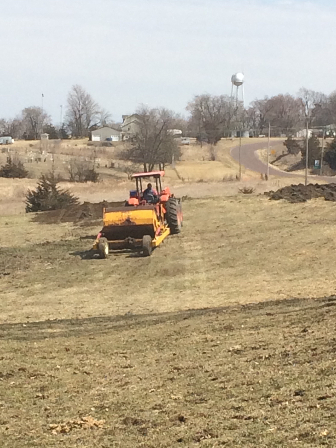

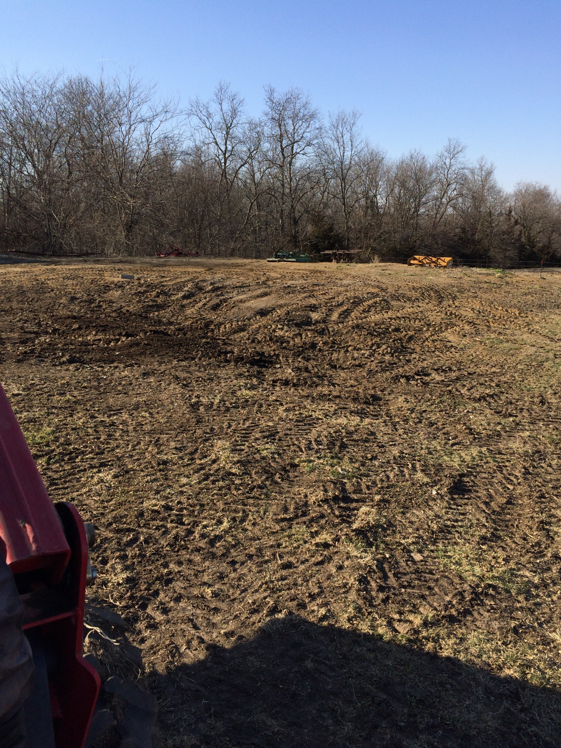

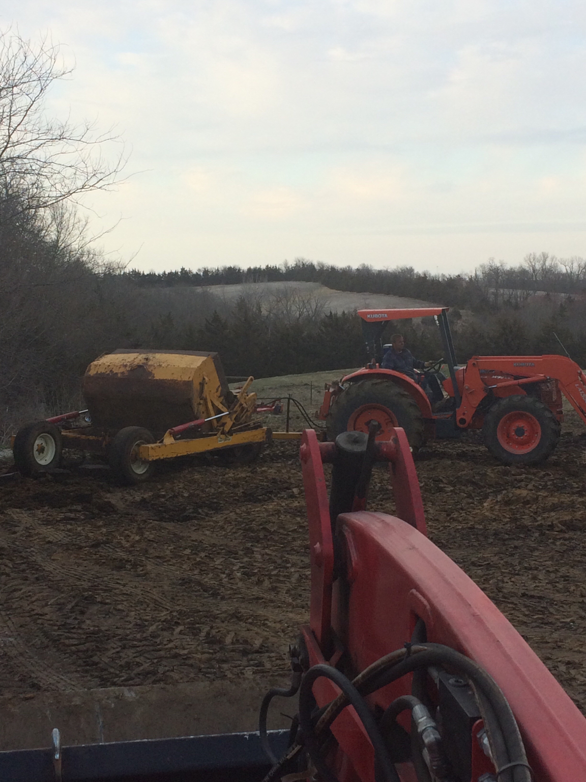

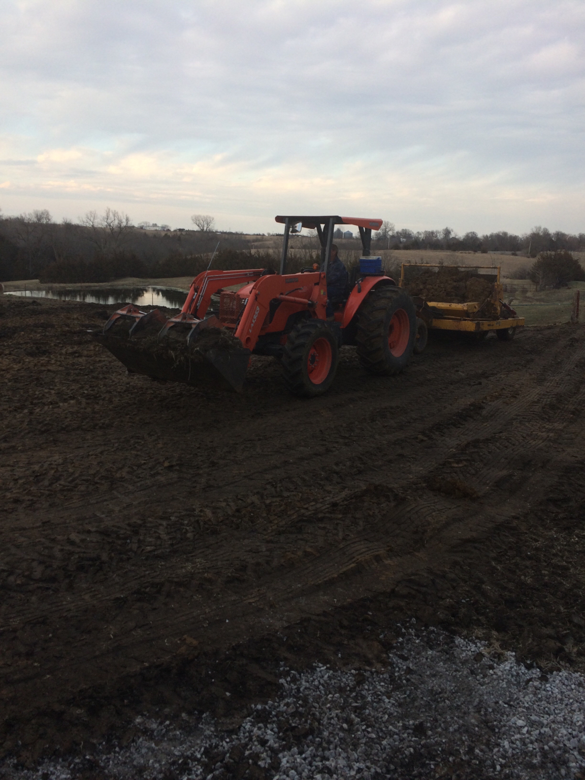

Ovrszd hauled a LOT of fill after the wife decided that she wanted to move the shop farther south than originally planned. I can't remember now how many scraper loads it was, but it was a BUNCH. I was the resident packer. Luckily, it had all summer to settle, and it ended up looking great when they did start on the shop.

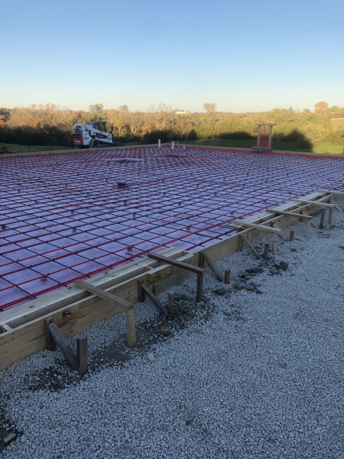

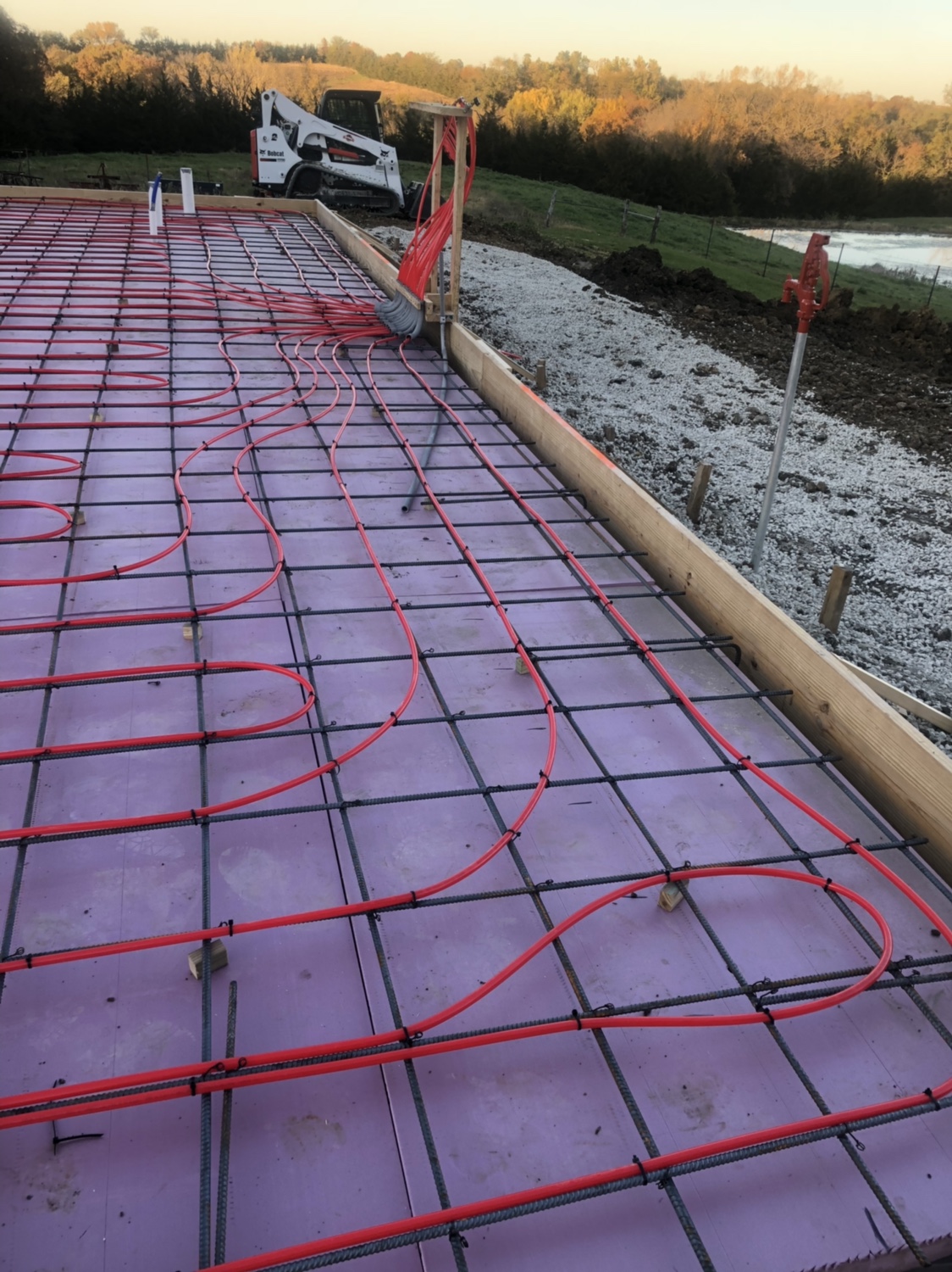

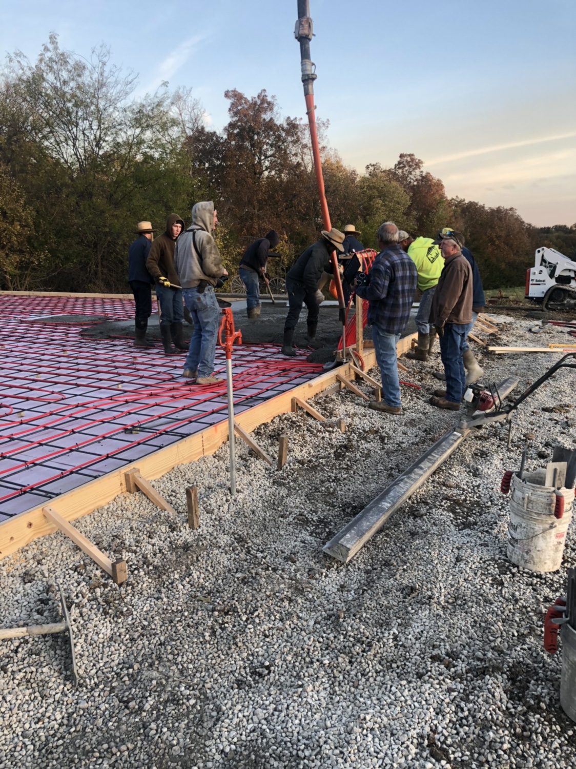

Rebar and foam in yesterday. Should get the floor heat ran today, and hopefully pour concrete on Thursday.

That's a lot of rebar!!!!! How far apart is each stick? Will you be adding chairs before your pour? I never trust a contractor that tells me that they can pick it up while spreading the concrete and that it will stay there while they walk on it. In every case, the rebar ends up at the bottom of the concrete and you no longer gain any strength from it.
Concrete chairs are the only way to ensure that the rebar remains in the middle, or lower 1/3 of the concrete.
/ 40x60x14 Shop
I didn't measure it, but I would say they are 1-1.5' apart. We haven't discussed chairs, but I have seen one of his pours that was similar to this, and it had chairs. I don't recall exactly how it was done, but he added them when he was wiring the pipe to the rebar.

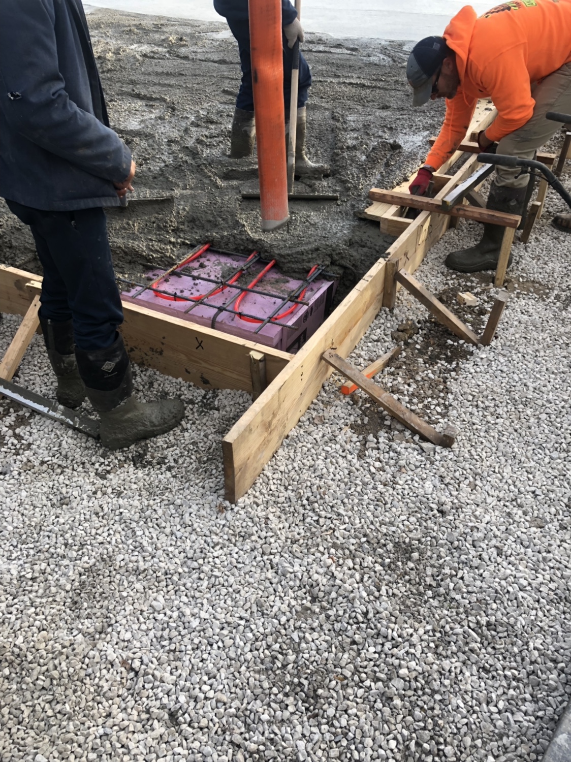

It will be 6” deep everywhere except for where the hoist is going to go. 10k two post hoist will be close to 12” deep 4’x4’ pad. I didn’t think ahead enough to have any forms done!

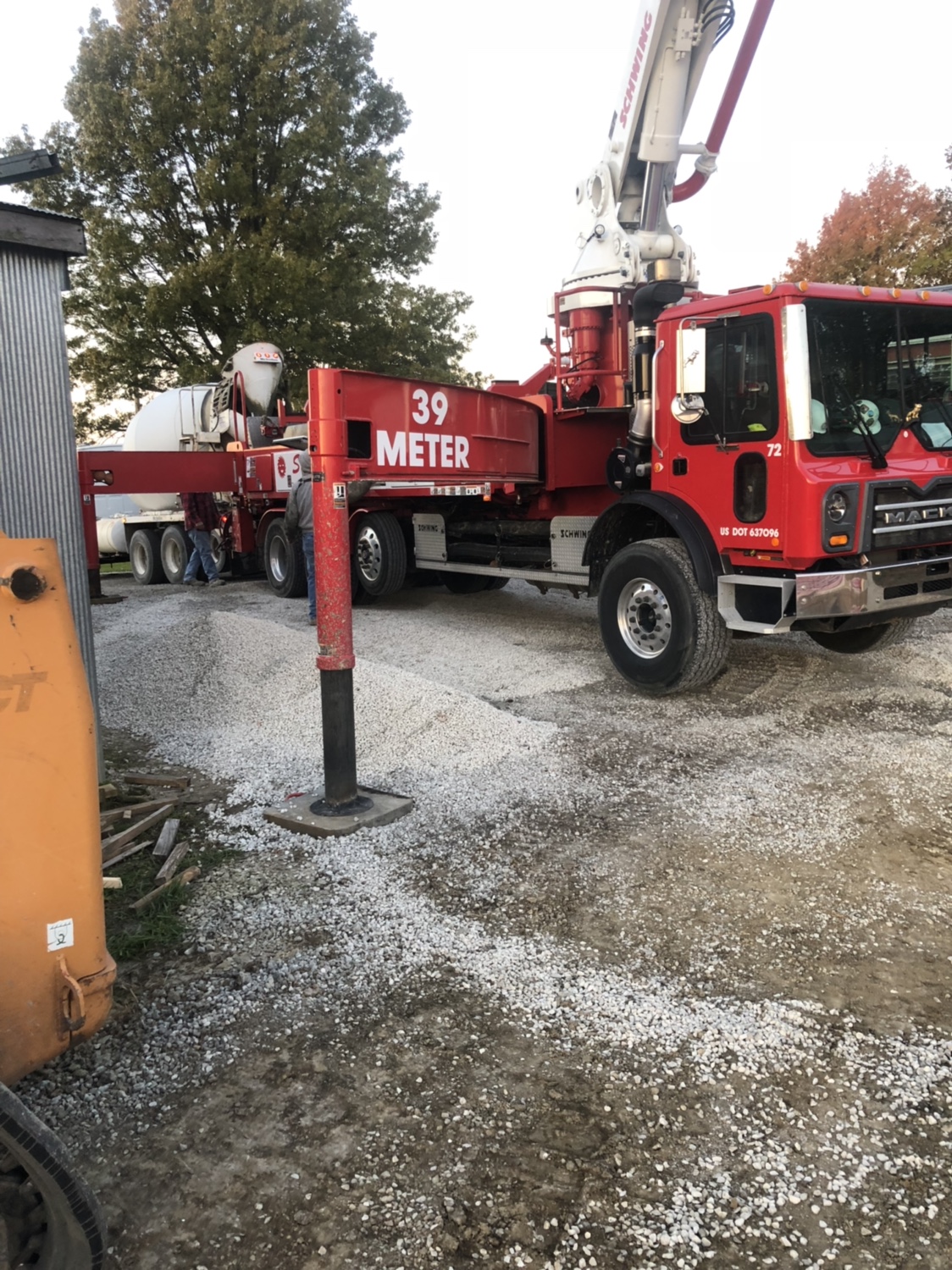

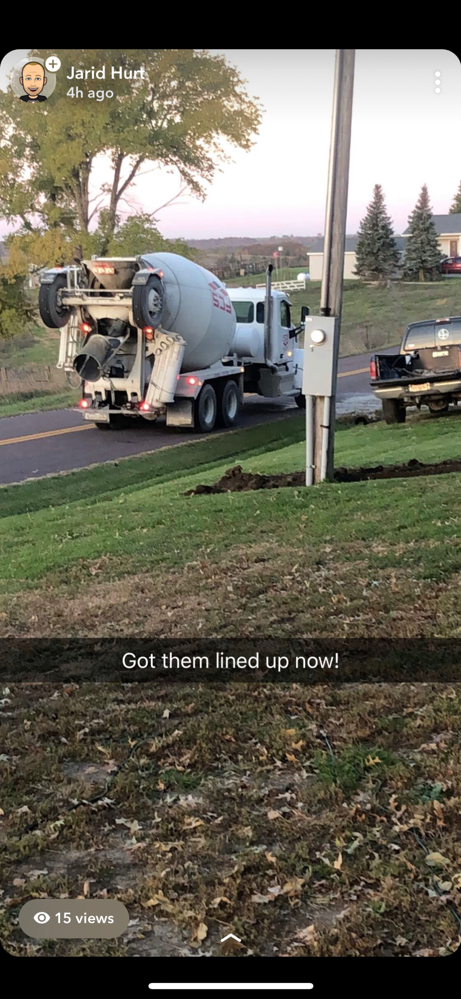

Pumper truck waiting on the first concrete truck to arrive!

Thanks for the picture showing the chairs. My opinion of your contractor went WAY UP!!!! I can't wait to see more pics of the finished slab.

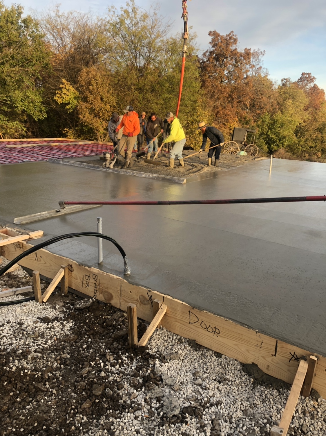

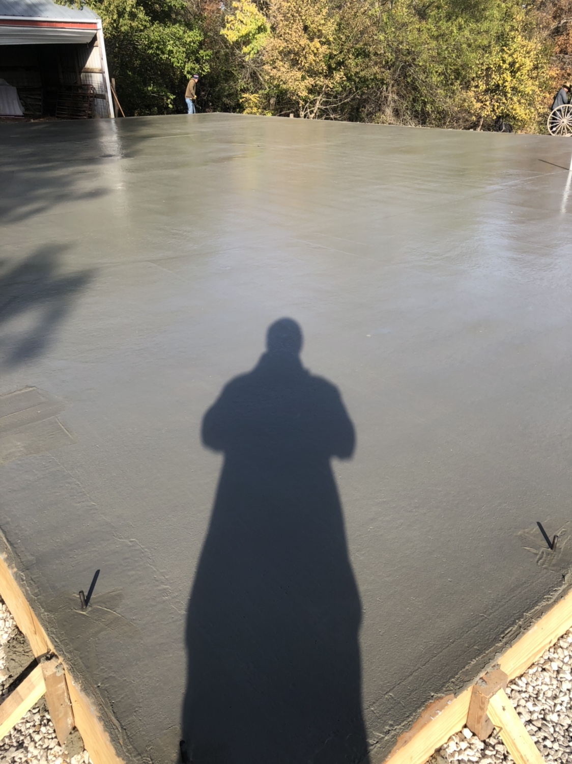

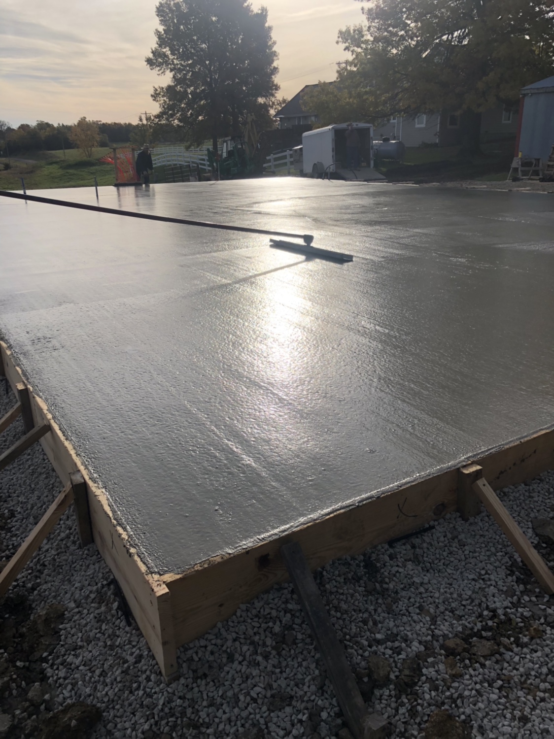

Tons of pics of the pour this morning. Had to go to work before they finished it though.
Richard was kind enough to take some drone pics this morning too!

Seeing everyone standing on your rebar sure is a good reason to always use concrete chairs!!!!!
Looks like they did a really nice job!!!
