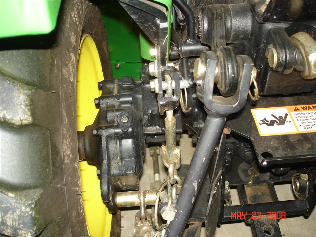

Kenny; did my pictures come through showing the offset brackets ? If you have time or still have them could you down size one of them and post it. Maybe someone with another series tractor has the same brackets. One of these days I should modify them to provide more clearance. thanks

Klink; Do your brackets look like the ones in the thumb nails posted by Kenny ? I was just wondering if I had the right brackets for a 4110. If your are the same maybe there are two styles.

Yes, those lift brackets in the pics are exactly like the ones I got with my 60" MMM for My JD 4110 in June of 2004. I don't know why they changed the design. there must be a reason, but I don't know it. The lift brackets on the mower deck must have been spaced farther apart??? So they had to change the offset on the 3 pt. lift brackets??? So that the linkage pull would be in a straight line. only guessing. Thanks Kennyd for the pics

My 2003 4110 with 60" MMM has the same wider brackets as Joe and Klink. I have turf tires, but the clearance is still pretty limited. - Jeff

I will bet your decks (Joe's,Klink's, and Jeff's) are for the 4110/4115 series tractors...Look at the tag on it and post a picture if you can please.
NOW, My deck is actually for a 4100, the dealer had it "left over", but still brand new and never mounted. For those that don't know the 4110 is a updated model of the 4100-but essentially the same.

I think you solved the mystery. Thanks for your research kennyd. I even had a reply in that old thread, but I forgot the out come result. So I copied and pasted my old reply into this reply to remind myself and others. Yes I have the newer 4110 - 4115 deck. I cut the 4115 extended bracket off. I used a metabo cut off grinder to do the cutting. I didn't want to use a torch. I saved the cut off pieces, just in case. and sprayed some green paint on. Now the mower deck is so much easier to install and remove. Make sure you turn your front wheels to the left.

Thanks guys for all the research and insight. I thought for a while I was stuck with a refit from another tractor series. The operators manual even shows the brackets a couple inches away from the tires. I was looking at adjusting the rear turn buckles when I noticed the design engineer must have been on vacation when that deal was approved. The thickness of the brackets looked like they were designed to lift a ton or more. Guess I can live with it... at least til I see a new and improved design I just have to have.

Haven't been here in awhile and I'm waaaay late to this discussion, but my 2004 4110 has the same deal as Joe and Kink - and I have the 4110-4115 deck. I put the slip ring on the tire side of the lift bracket so the pin slides to the inside; I can adjust the deck height without removing the tire (turf tires)
Also had an earlier issue with the lift bracket, the welded-on mounting sleeve that slides over the rod (which the 3PH turnbuckle also slides onto) was welded in the wrong location by about 3/8" in the wrong direction - the slip ring and pin scuffed the tire until a replacement lift bracket was received.

Joe, I had the tractor out today to mow, so I took two picture for you.
Kennyd---that turnbuckle you have pictured---is that stock, mine just has chain links in that location---its a PITA---and Ace doesn't carry any heavy duty turnbuckles like that.
Also does anyone else have problems with the retaining pins (hairpin type pictured in pics on post # 22) coming out and then the 5/8" pin falls out and gets lost or is that just a 'me" problem?

The turnbuckle is stock, came with the "lock-up kit"
