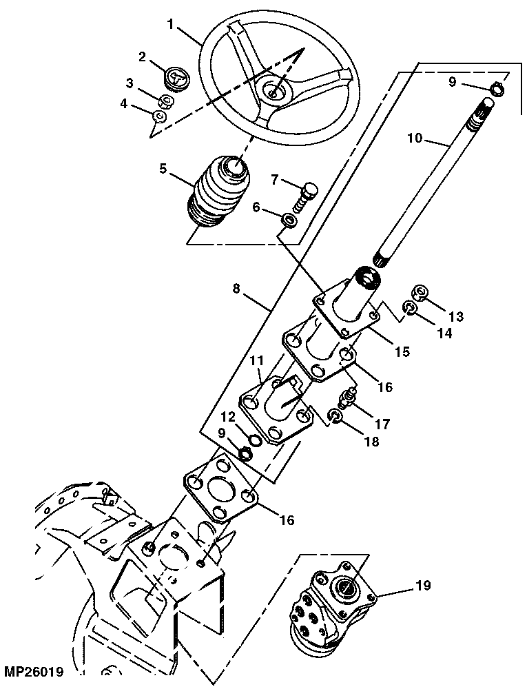

I just notice where fluid leaked on the mower deck after my wife mowed last week. All I could see is fluid on the power steering hoses apparently coming from the top where the steering colume is housed. Not having time right now to take the plastic cover off what are the hoses leading to and how hard is removing the plastic cover. Any ideas what could cause a leak now the tractor is a 2005 4115. Any help or ideas are welcomed. As always thanks again. Larry
/ 4115 power steering leak #2
The hoses go to the steering (orbital) valve, #19. I have never removed the cover on my on 4110 (same as your 4115) so I cannot advise there...

I have the 4110/4115 tech manual and this is what it directs you to do. Hope this helps. -Jeff
Control Panel Removal and Installation
1. Remove steering wheel.
2. Remove four screws and lift off the control panel.
3. Disconnect two wiring harness connectors.
4. Disconnect tachometer cable.
5. Disconnect PTO switch electrical connector.
6. Installation is the reverse of removal.
Control Panel Lower Shroud Removal and
Installation
Removal:
1. Remove control panel.
2. Remove cap crews from RH and LH side edges of
shroud.
3. Lift control panel and tilt top of shroud towards seat until
park brake connecting rod and speed control lock are
accessible.
4. Remove spring clips and washers from park brake
connecting rod and speed control lock rod and disconnect
rods from handles.
5. Disconnect electrical connectors from key switch.
6. Remove shroud.
Installation:
