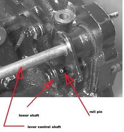

So my rockshaft stopped working correctly some time ago and I haven't really had to do any box blading or anything precise. It would still go up and down, just not in proportion to the lever. I finally decided to see what the heck was wrong.
I can tell you my fix was not costly, but it took me about 8 hours to repair. I could do it over again, knowing the job and exactly what is needed in about 3 -4 hours possibly. It was small snafuus that caused the job to take so much time. Having to make tools, and retap the hydraulic lines to the rockshaft filter. More on that later.
The problem was a rusty frozen control shaft going into the control valve. There are 2 shafts that go into the control valve. The top one is the actual 3 point lever that raises and lowers the 3 point. There is a 2nd shaft under that, that is connected to the 3 point lift arms and has some adjustability.
My lower shaft was rusted stuck from being13 years old, and much of that sitting outside.
You first have to take your seat off and the plastic base that covers everything under the seat. There are 4 seat bolts which are 13 mm and then the black plastic base has a bunch of 10mm bolts all around. You have to take off your A-B-C handle. A new orange cap is about $2 something. Also take off the black plastic handle on the 3 point hitch lever. You'll have to unhook the boot around your FEL loader joystick and work the base around it to get the whole thing off. Take pictures of everything so you can see how it goes back together. You will also need to take off the draft lowering speed control knob.
Can you tell me exactly what your tractor was doing before the fix? Mine, too, is missing the same roll pin. Is the shaft supposed to turn easily? I replaced the roll pin but this tractor acts like the rate of drop valve is inoperable. Also, acts like the rockshaft adjustment is way out of wack, only works on fully raised and about an inch down. Does any of this sound familiar?
The roll pin shears off because the shaft is rusted up inside the case it goes into. at least that was what my problem was. The problem was the rear arms did not actuate properly

Hello sir. I own a JD 4105 and have NO mechanical know how. I broke the 3-point hitch lift control shaft and it look identical to the one you have pictured for your model. I ordered a new shaft but can't get the old one out. The key (#29) seems to be the problem. I've tried tapping the shaft (towards the left tire) and I've tried tapping the piece you have in your fingertips away from the housing. Is the key the only thing that holds that piece (pictured in your fingertips) against the housing? Frustrated !
