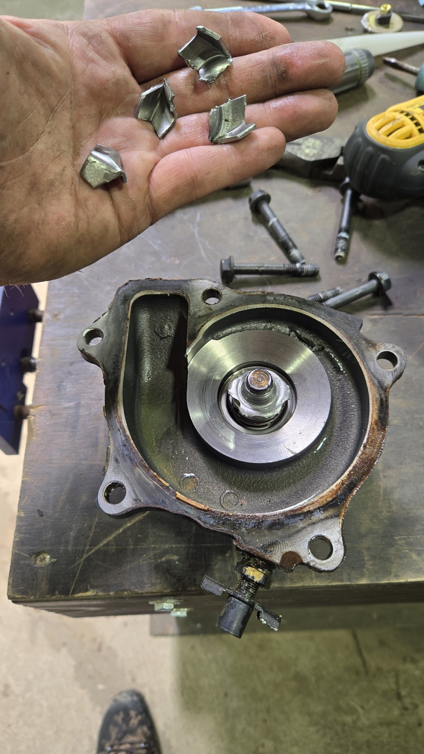

Well, the K-Seal did not work and here is why. It was not the gasket it was the pump itself. still missing two pieces.
That looks like a busted up impeller on the water pump. I think the op mentioned a water pump issue on his, in addition to the timing cover sealant joint leak. How much for a new water pump ? Was it tough to get off ? Was it overheating, loosing coolant or both ? Maybe the K-seal did fix your timing cover sealant leak, if you had that going in too, like the op did.

It appears I had no timing cover leak.
All the coolant was from the water pump which the bearing and seal gave out.
It was a pain in the butt. Had to cut the bottom bolts off the radiator to get it out. Then remove the shroud, fan and pully.
JD soaked me $317.00 for a new pump and I had to buy a gasket as well. Like I would buy either without the other.
The radiator is still serviceable. The studs are still there that will fit into the rubber grommets. It doesn't need those bolts on the bottom. New tractors don't have them.
