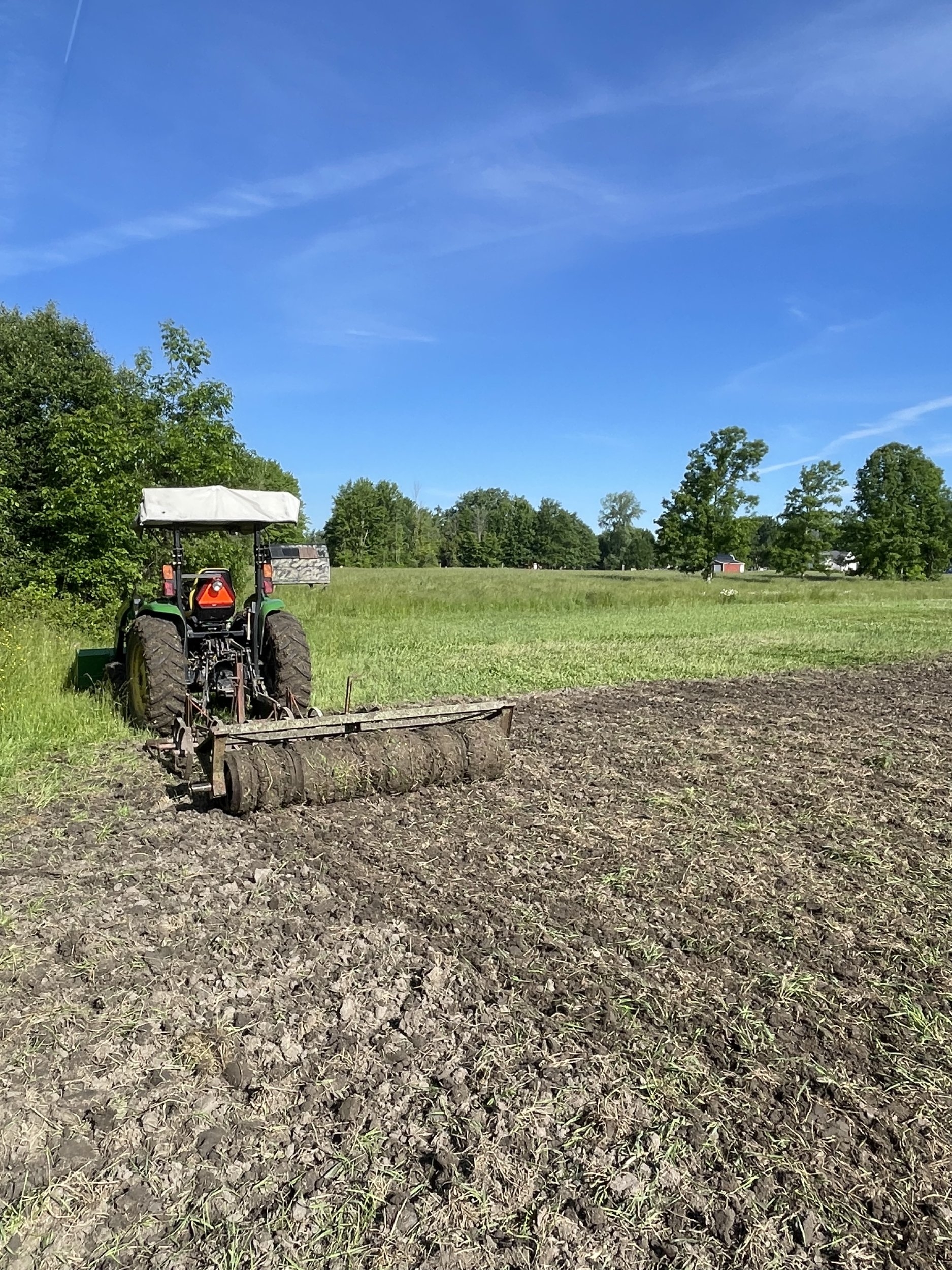

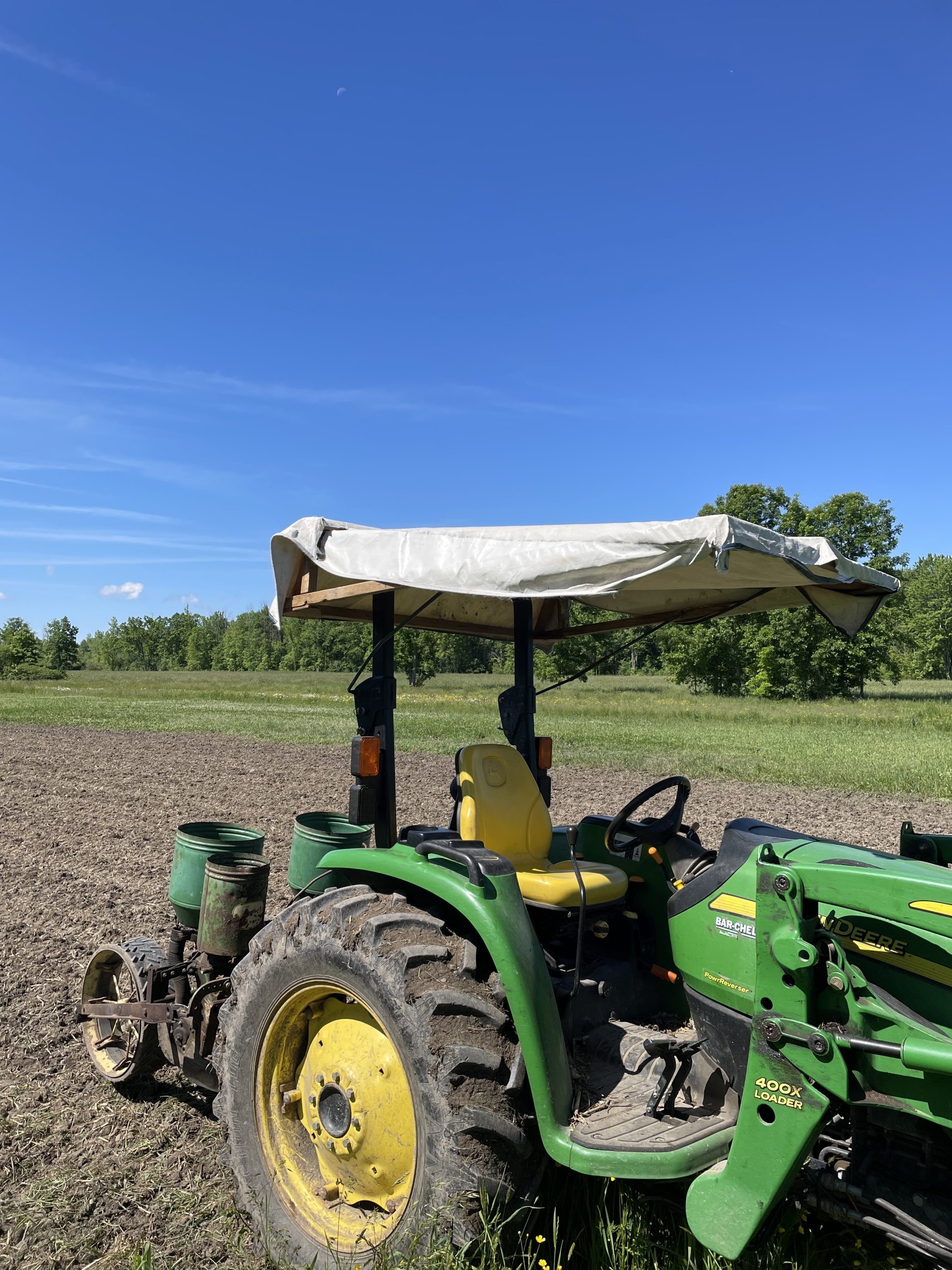

I think I may have recently had this issue on my 2005 model 4120. I noted that the coolant level was approx 1/2 gallon low a couple months ago and I topped it off then. About a week ago, the high temp alert came on and again it was about 1/2 gallon low on coolant.
I had last changed the coolant 14 months prior, using JD coolant at the recommended water mix ratio. Not having the time to pull the front axle and the oil pan, or spare $6 k around to do the job “properly” at the dealer (I assume that would be the approximate cost of the job now since everything has doubled in cost since Covid), I opted to pour a $ 16 bottle of K-seal into the radiator.
It’s only been a few days, but I’ve been working that tractor pretty hard getting ground ready for and planting corn. So far the $16 fix is working. It says on the bottle that stuff makes a “permanent fix”. Time will tell I guess. The coolant level is holding after about 10 operating hours.
