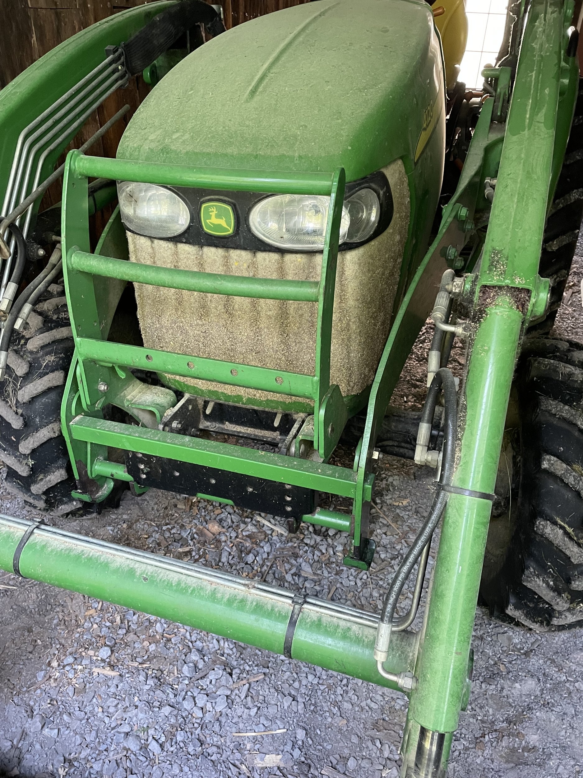

I noticed my coolant temperature starting to creep up a little closer to the red zone on the gauge, as I was getting near the end of bush/hogging this thick, 5 acre hay field on Tuesday night. I was wondering if the coolant leak might have started again.
I used the 4120 tonight, to move some firewood, and I discovered what caused the slightly higher than normal temperature. Cotton, from the poplar trees growing along the creek across the back of the field, had built up about an inch thick over the entire grill.
Now I feel safe to move my jug of 50/50 coolant mix back up to my long term stage shelf in the metal shop. I had been keeping it in the back tractor shed where I keep the 4120.
Same exact thing happened to my Kubota BX. The radiator screens won't stop the small stuff.

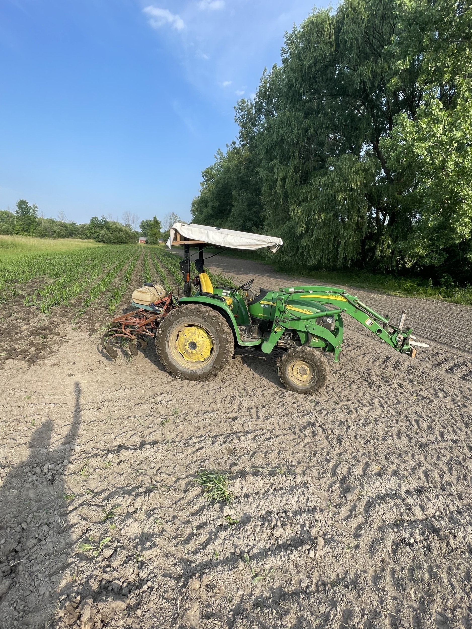

I took a vacation day from my factory job today, and I pulled a “David Frizell” with the 4120 (That’s 10 more operating hours). I started out cultivating and spraying my first planting of field corn. It was up about 2 ft and looking pretty weedy.
Next, I hauled a bunch of top soil and finish graded around a barn demolition site, next to my pole barn. I ended with a few more hours of heavy brush-hogging. We are just getting into a heat wave and the air temperature was in the mid to upper 80’s most of the time.
The K-seal coolant system repair continues to hold. Even though my grill was about 3/4 blocked by Timothy seed by the end, the coolant temperature stayed well within the green the whole time.
