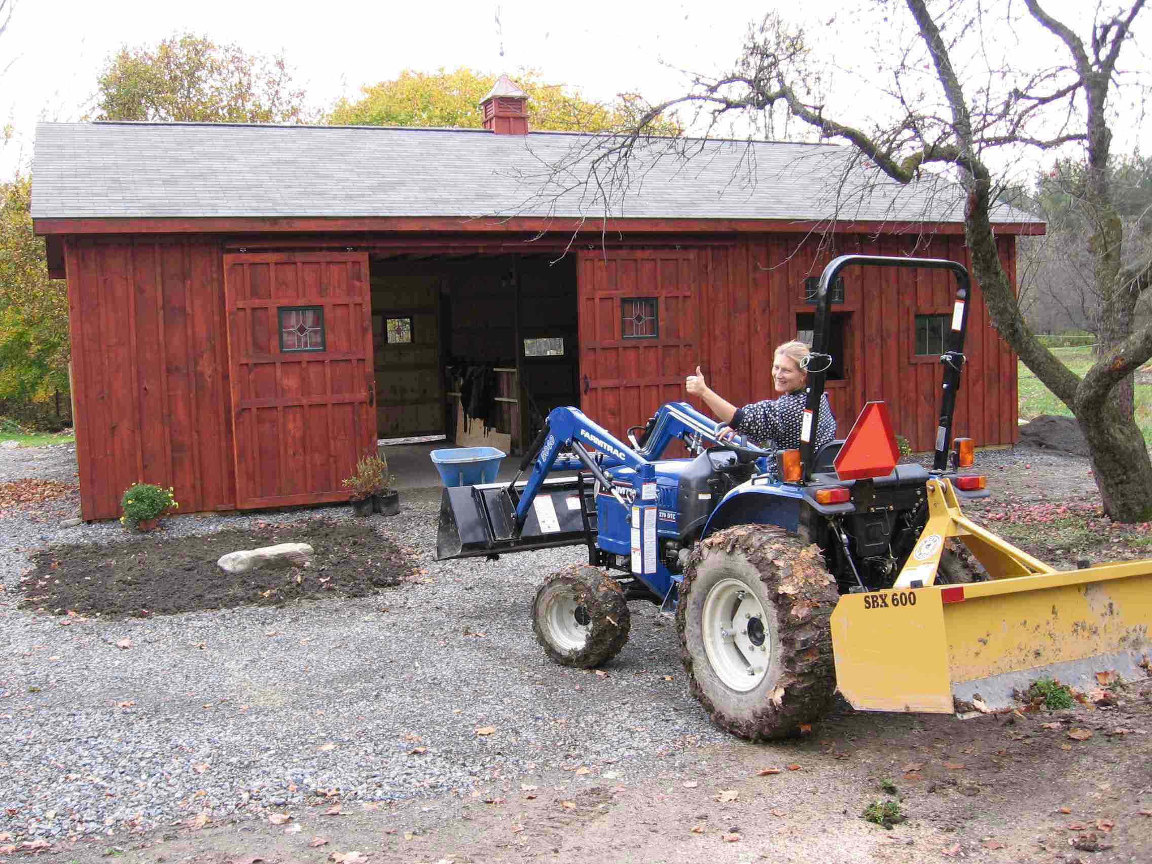

biggerten said:
It then moves from the column "Work" to the column "Play". FFLF (Female Fun Limiting Factor) rules will then apply.
Early in my tractorin' career, I made a significant mistake by breaking out into a huge grin while doing "work" on the tractor. It was then that I learned that a tractor should never be positioned such that a wife could observe head-on, the husband-tractor-operator's face. The attached photo shows what I found when I returned home from work the following day.
She ain't been the same gal since.
