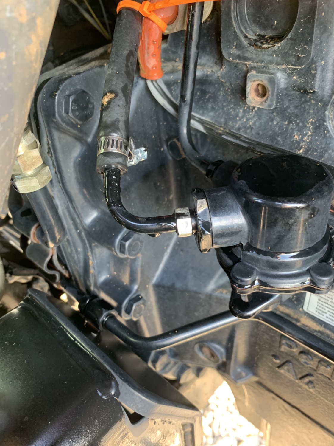

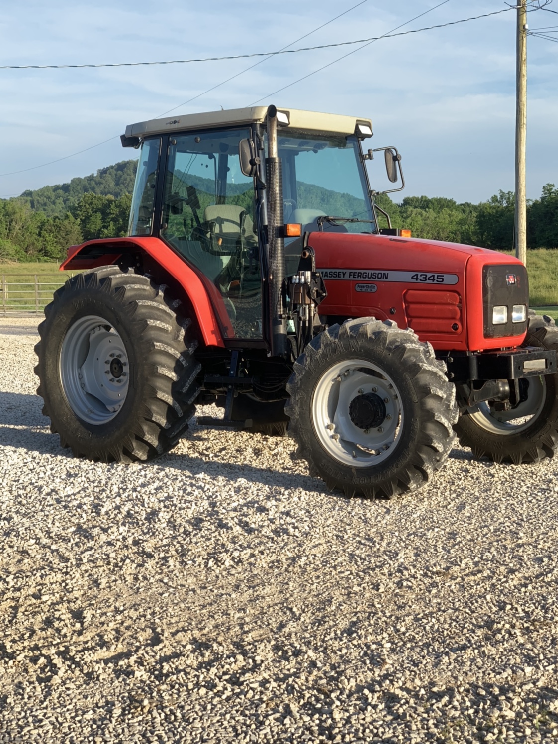

Update. I talked to a couple of dealers and they both agree it sounds like fuel starvation. I replaced the fuel line to the lift pump. It was not in the best shape but I did not get it to leak when I put air on it and soaped it up. I did find the elbow on the lift pump that the hose hooks to loose. It a compression fitting, I could swivel it pretty easy. After that I drove it hard for several miles up some hilly roads. It acts and sounds good. Normal. But that did not push it hard like bailing or cutting. Have some thick fields I can bush hog this weekend, if I don’t cut hay. If that’s not the issue then I’ll replace the lift pump and sending unit. If that’s not it I’ll bite the bullet and send off to the extremely busy dealer. Here’s pics of the old line where the hose clamp was and the elbow on the lift pump.
