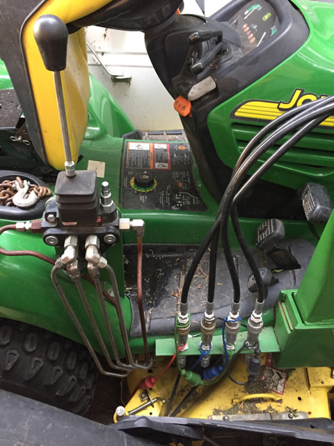

Hello this is a picture of how I set my valve up, I cut the line going to the factory black capped hydraulic coupler. I ran it through my valve which has power beyond capabilities then back to the factory coupler. I don't have any factory attachments but I don't see where there would be any problems. Thee only thing I might consider changing would be to turn the valve I mounted 180 degrees so the float would be in the right position. I haven't had any problems with this hookup , it's great to be able to use the loader separate from everything else and I still have use of the factory setup. Well I was going to load the picture but evidently the forum has disabled photo sharing so I'll have to get them to send me my password. As soon as this happens I'll upload the picture

Likely Deere put in the simpler shut-off valve because front mounted equipment.. FEL, etc wouldn't be mounted at the same time.
To operate both FEL and rear blade ( 3-ph setup), then sub-ing in an electric valve in place of the manual valve should do it well.
Could then do without the menagerie of plumbing as shown in the photo of mtnlover. Just a thought.

I don't have any other equipment for my tractor yet. I've been looking at blades, snow throwers etc but haven't purchased any as of yet. The pluming was that hard and I think it turned out pretty good, certainly not a menagerie! The valve isn't that big, it's not in the way when you're sitting on the tractor, being a heavy equipment operated by trade I'm used to always getting on and off on one Side. With the power beyond capabilities of the valve I've actually though of adding another valve at the back so I can use hydraulics to adjust my box scraper when I have it on

Couldn't you just use the factory levers and just make that go to the back? I think it looks fine I was just thinking it would be a little smaller than that. I haven't looked at any valves or anything yet.

I'll get another picture tonight from the seat so you can see where the valve is in relation to the seat. I got the valve from northern, didn't see any that were smaller at the time but they may have something by now. I installed the valve about 5 years ago. I also had access to all the stainless tubing and benders at that time
