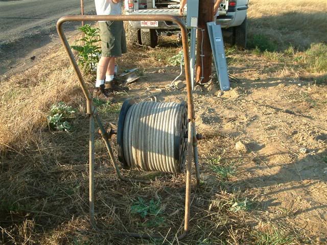

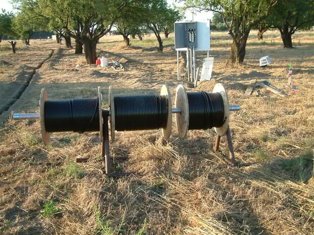

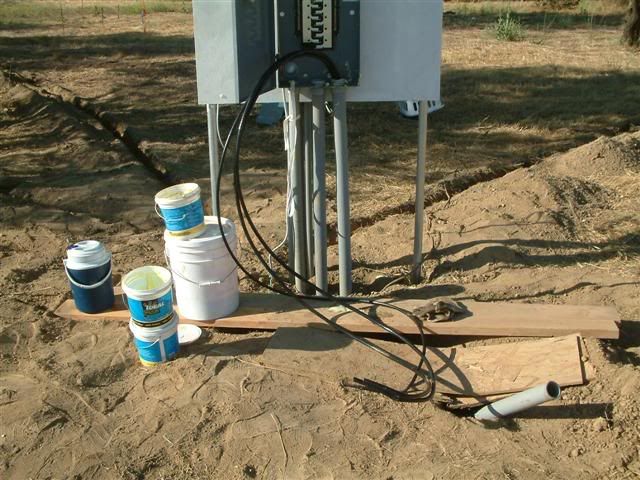

Here are a few images taken when my 220V/200A service was installed a few years ago. The PVC conduit was about 350 ft in length, glued together and buried. Two 4/0 and one 2/0 cables.
The input end:
The output end:
Fiberglass pulling rope
Electric winch mounted in the trailer hitch receiver
Need a lot of pulling lubricant
The cable pulling job took about 4 hours doing it this way.
