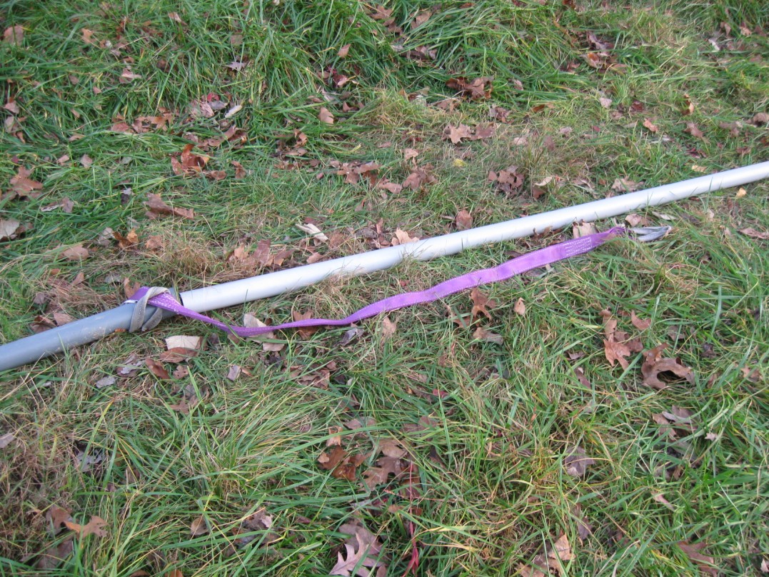

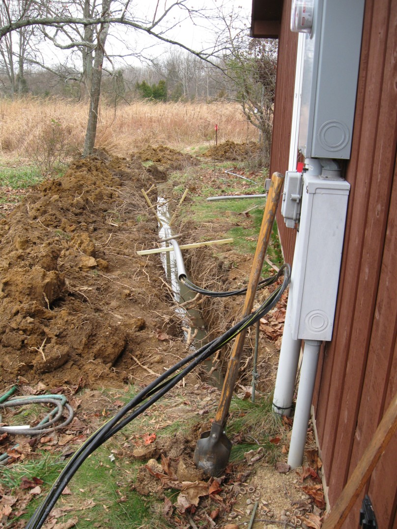

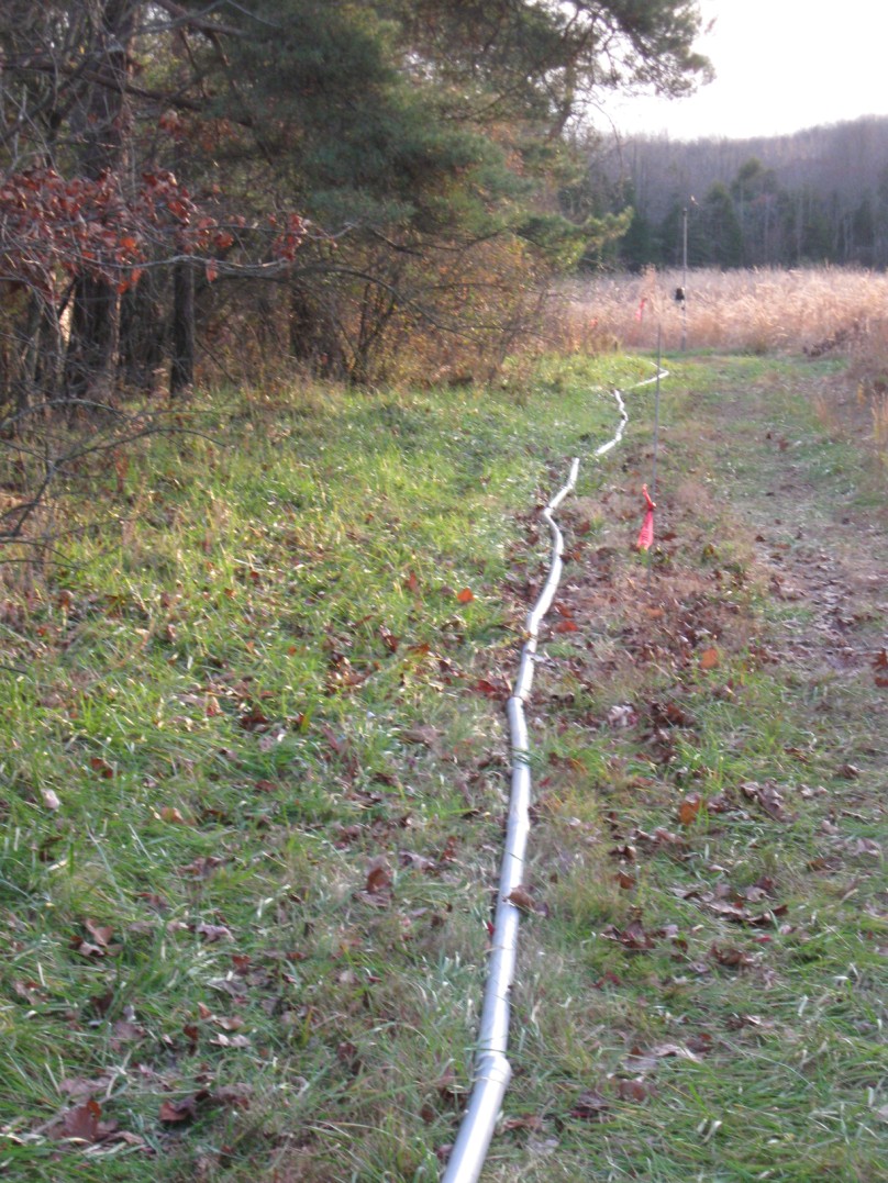

It has been a while but finale got this project going. The wire is in and the panel and boxes should be installed this week. I wanted to wrap up this thread since the hard part is done and I did learn a few things.
I went with 4/0 wire in 2" conduit. I tired to justify the 3 times the cost of 2 1/2" and just couldn't do it. That went in the trench at 3'. A foot above that I ran 1" conduit with 2 Cat 5e and a pull string. A foot above that (so 12' from the top) is the red warning tape.

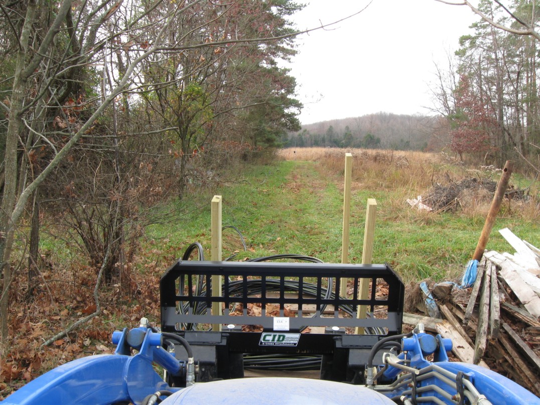

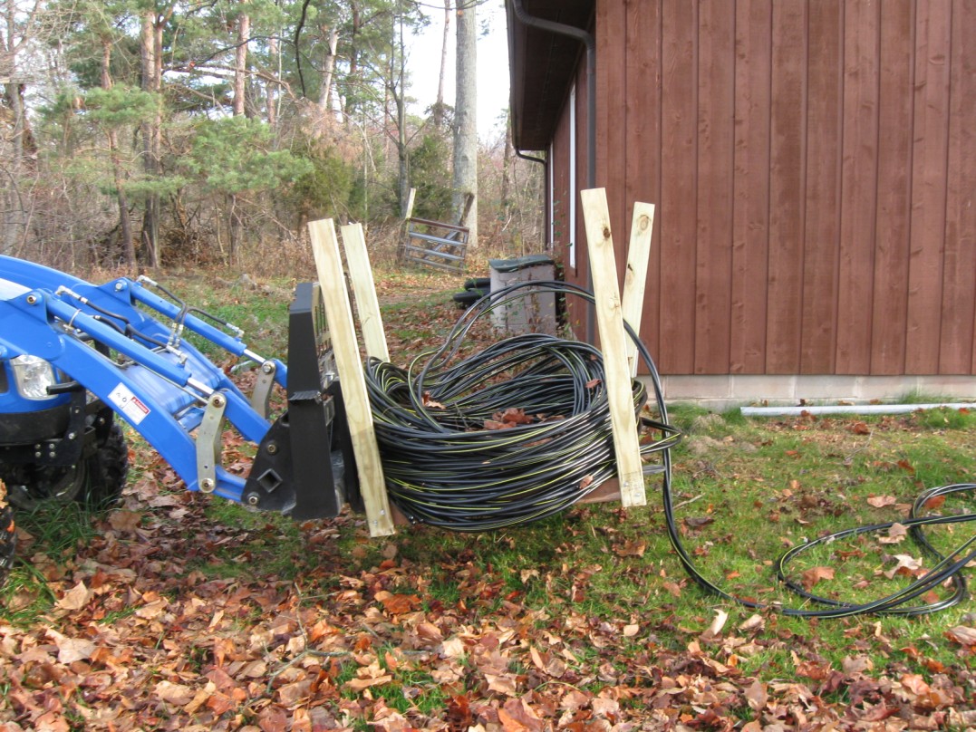

I called ahead to Menard's (the closet local box store) to make sure they had the cable. The sales guy recommended that I get a pallet and attach some 2x4s to the sides for handling the cable as it came off of their spool. Luckily, I had acquired new forks and this method turned out every well. As you can see in the first couple of pictures, I was able to string the cable out by myself. I did have one of the uprights come off, but I only had to get off the tractor a couple of times. I just backed my way to barn and watch as the cable came off the pallet.
I learned the hard way that I should have gotten the cable as straight as possible before sliding in the conduit. I was using a strap over my shoulder to pull the 10' sticks. For the first several pieces, I was using brute force to striaghten the cable by passing it through the conduit. 2 1/2" would have been easier for sure, but I finally figured out that if I the cable as straight as possible the conduit went on fairly easily. But it took time as I was pulling until I hit a tight spot. I'd stop, straighten the wire and pull again. Next time (I hope never!), I'd stretch the entire length before I started.

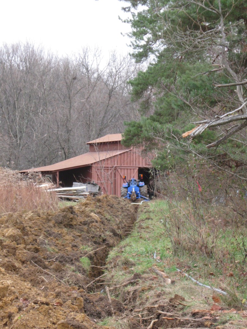

We are having some remodeling done and I had our contractor dig the trench, using my BH. He is an experience operator and I was running out of time before the snow files. As he started digging away from the garage, he saw water coming up from the bottom of the trench. He thought he had hit a water line, but figured out (after probing) that it was just water perking up through the clay. As you can see in the picture, the trench filled with water. He hit a couple of other spots on the way to the barn. We had lots of rain this fall, but none recently. I'm going to mark the spots and do some digging (to the side) later to see if it might be a spring. A guy can always hope!
I'm really looking forward to having power at the barn. I decided to have a pro install the panel and shut-offs and I'll do the wiring in the barn. I really appreciate all the comments and advice.
