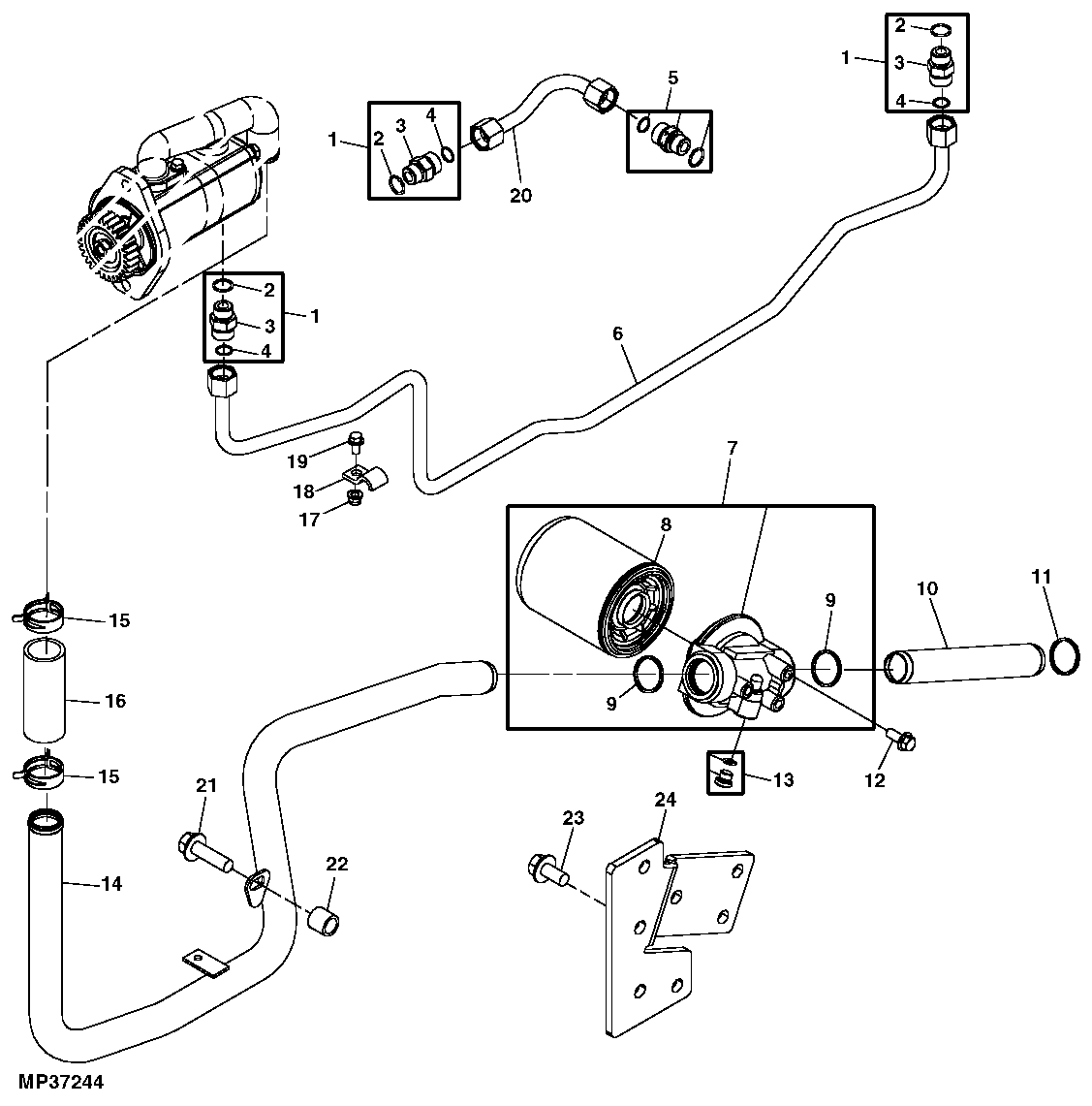

Air leaks on the return suction side of the system are very hard to find, they usually do not leak externally so it is not very obvious. You have 2 pumps that are tied together on one shaft, one is dedicated to the steering and the other to the implements, but they share the return pipe (#14 in the picture) from the sump that I mentioned earlier, and as you can see, there are plenty of places it could be sucking air under negative pressure-and you would never see a drop of oil leaking out.
The hose (#16), pipes (#14 and #10), filter, filter head and packings (#9 and #11) need to be inspected very carefully.
When this happens, you need to look in the sight glass and filler neck and see if the fluid is foamy looking-that will indicate air entrainment.

Just where is this return line and filter? Does the 4520 have the same line?
/ 4520 hydraulics #11
Look in the picture I posted above...That is the filter. Do you have a manual?
