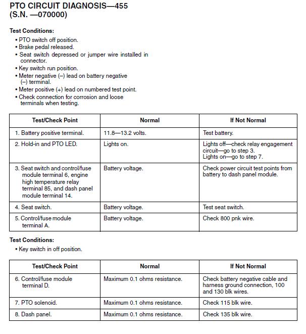

Dec 22, 2011 / 455 pto #2 B beenthere Super Star Member Joined Aug 16, 2001 Messages 18,687 Location Southern Wisconsin, USA Tractor JD_4x2_Gator, JD_4300, JD_425, JD_455 AWS, added JD_455, JD_110, JD_X485(sold) :welcome: Here is PTO circuit diag for early 455. Attachments 455_PTO_diag.JPG 73.3 KB · Views: 234
