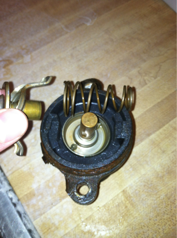

I have a 461 that slowly overheats when bush hogging grass. Takes about 15 minutes to do so. 6ft cutter, radiator is clean and full. New water pump supposedly installed. Any ideas? I hate to take to dealer but no idea how to proceed.

Have you actually washed the fins on the radiator? Just blowing through with compressed air will get the big stuff but leave the fines. I usually wash through the radiator (with the machine cool) with a simple garden hose with my thumb over the end. If there is some oil or something mixed in I may add some simple green or another cleaner too.
Also. are you certain the thermostat is opening? That tractor shouldn't have any issues with a 6ft cutter.

Besides the other comments, make sure the air filter is not clogged, check the water pump belt for tightness, make sure you have the correct pressure cap on the radiator. Check to make sure the lower hose isn't collapsing at high rpm. look for continuous bubbles in the coolant indicating a blown headgasket.

All of the above is good advice, but have you actually checked the water flow in the radiator? Looked inside for any whitish looking buildup. Fan belt tight? Bushing requires going slow. You might try a lower gear to keep you RPM's higher to see it it keeps it cooler. High brush limits airflow thru the radiator. Poor circulation will show up under those conditions. It the tractor temp lowers in open field and moving a bit faster, then it sounds like a circulation problem. Hard water is a radiators worse enemy. If all the above checks out, if it where me I'd look into removing the radiator taking it and have it properly cleaned. DIY cleaning kits are great for moderate to low contamination. A rad shop can check for leaks, pressure and give it a like new cleaning. Then only use a premium coolant/antifreeze with distiller water mix.

I know this is a old post of mine but wanted to update it in case someone had same issue. Basically i bought this tractor used with 400 hours and at a very good price as the original owner had it overheat a couple times and didn't find the issue. I think he just got frustrated and wanted a new Mahindra to be honest. Anyway I to had some problems and even my dealer thought it just needed the radiator cleaned but to no avail. The dealer is 30 min away and i had other tractors so basically let it sit for a while. Then this weekend it was raining so I tore into it. Just as some others had mentioned it was a bad thermostat. Believe it or not it was totally destroyed. Apparently MF got the bright idea to save money and make it out of plastic. Well the plastic had broken and the metal valve section fell down into the top of the engine. I fished all the pieces out and put a new in place. Apparently MF figured out the issue as the new one was ALL metal. At this point I'm surprised that no one, including the original owner, checked for this. Oh well she runs great now and is back in production.

Just got through mowing a few acres and man she is running good. Running cool to. Actually barely gets into the middle "green zone". Did i get a cold thermostat or should it run this way? I was running a 6ft BH 286 in high grass too.
