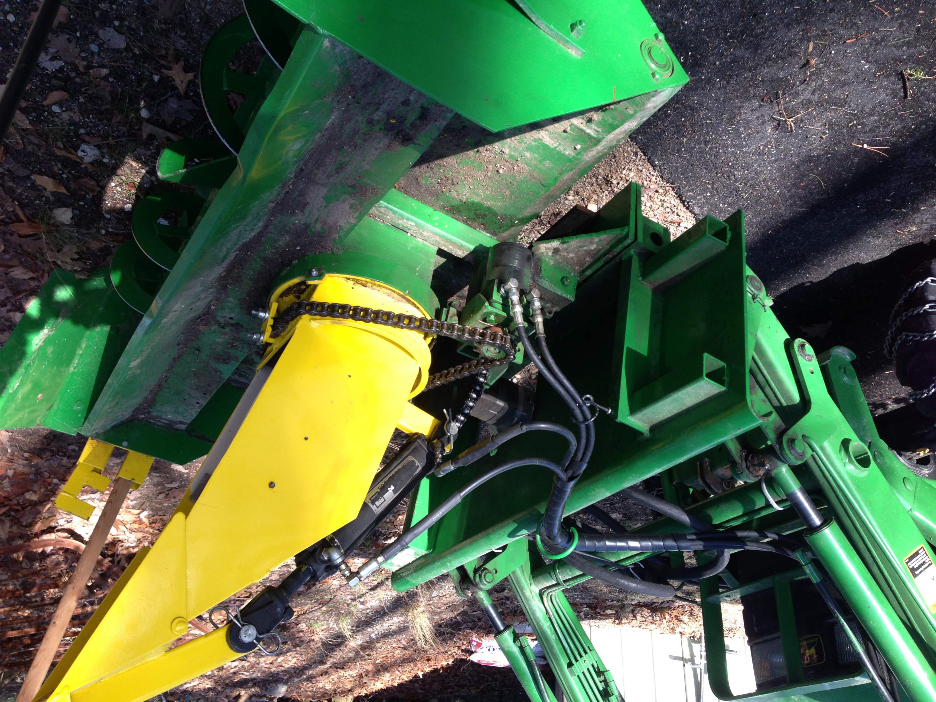

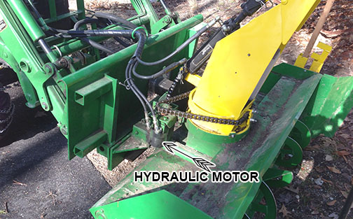

HYDRAULIC CHUTE TURN
this is how I did it
