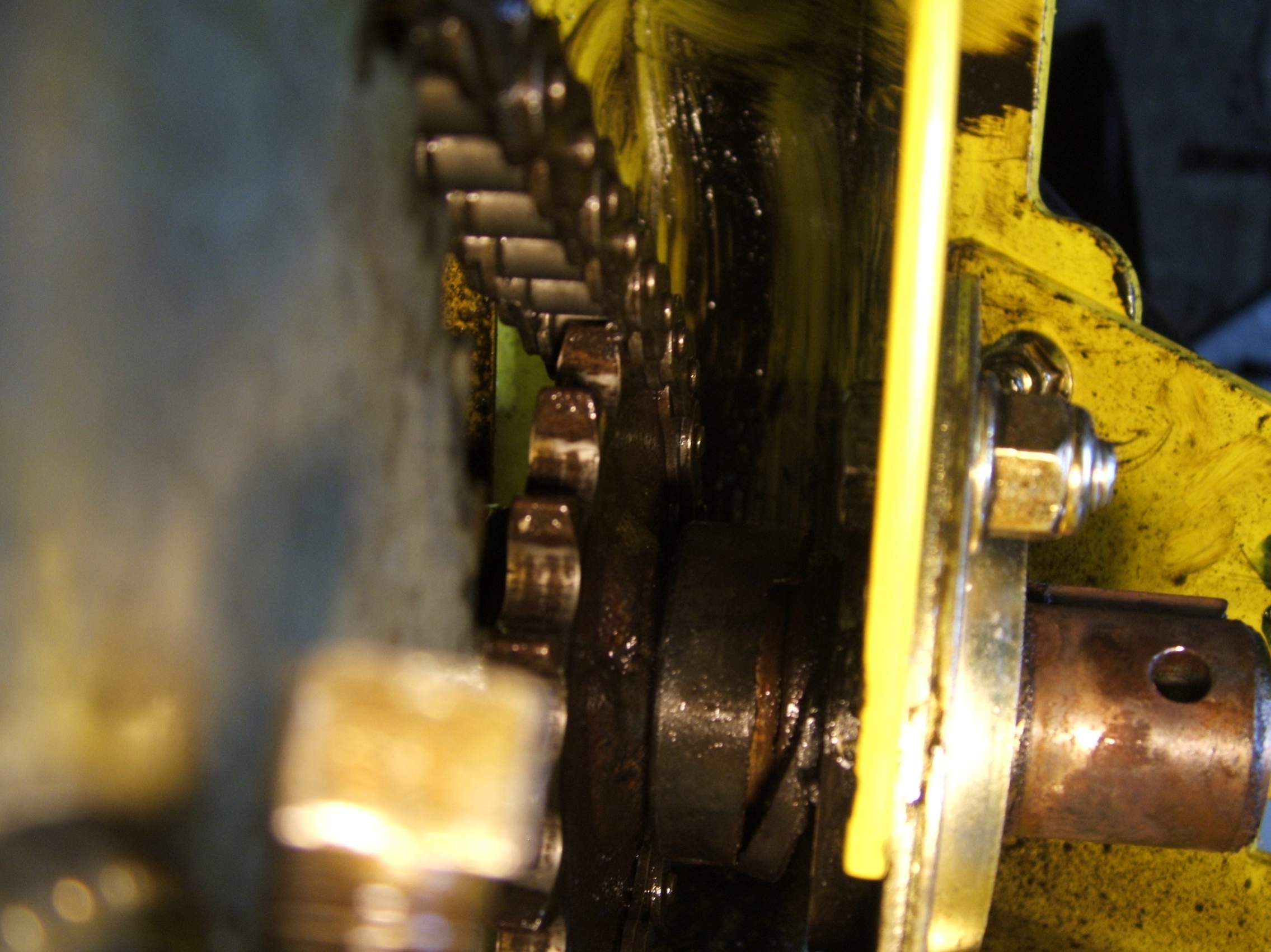

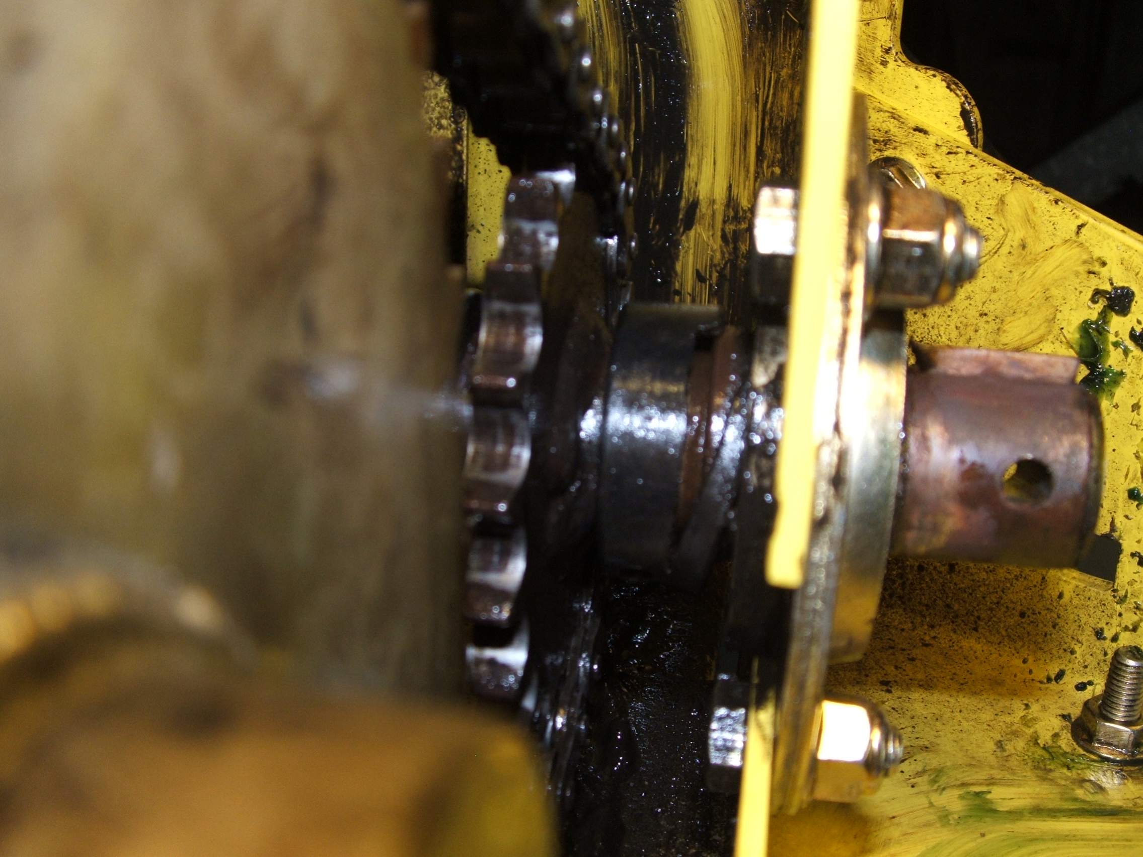

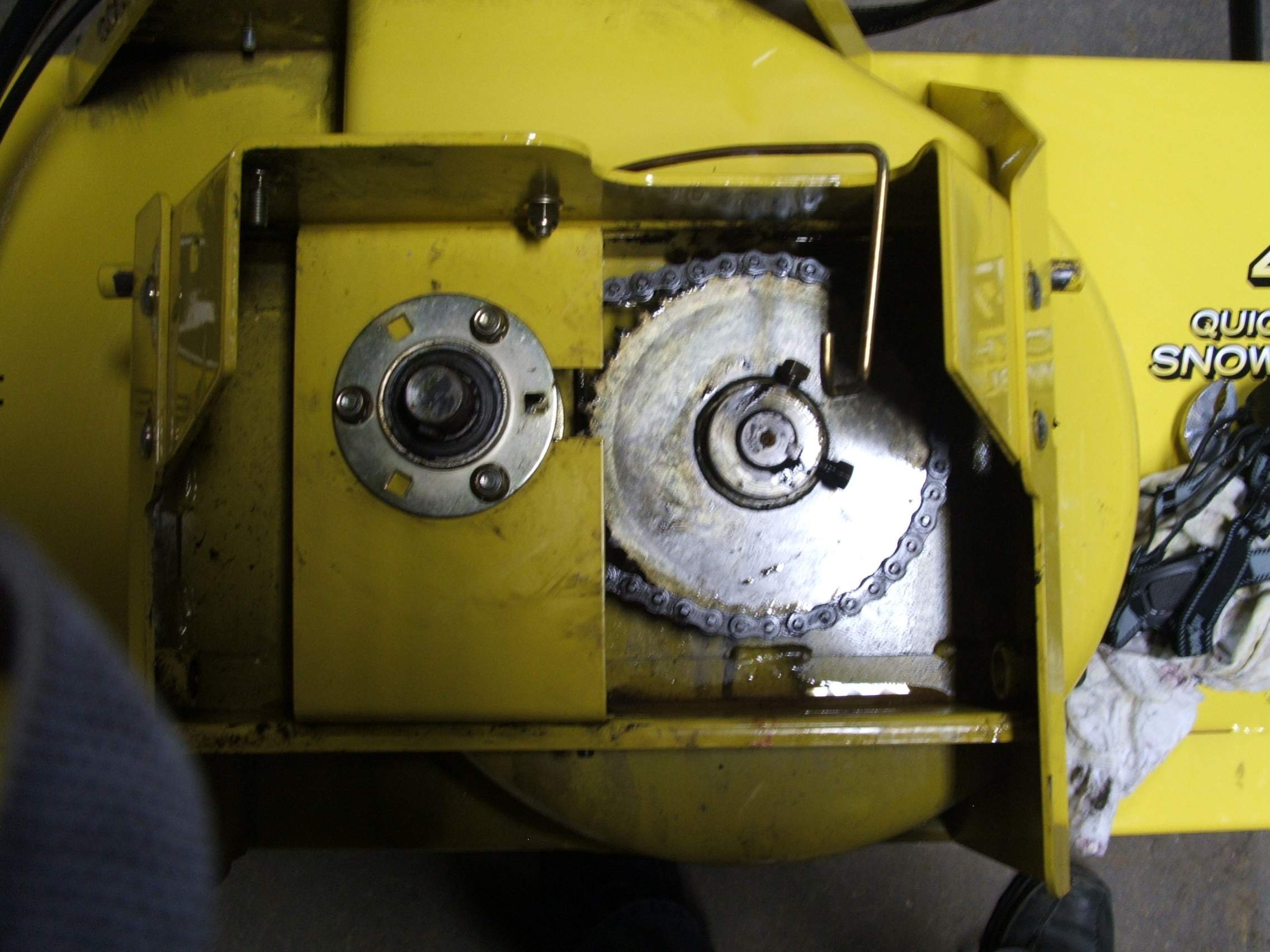

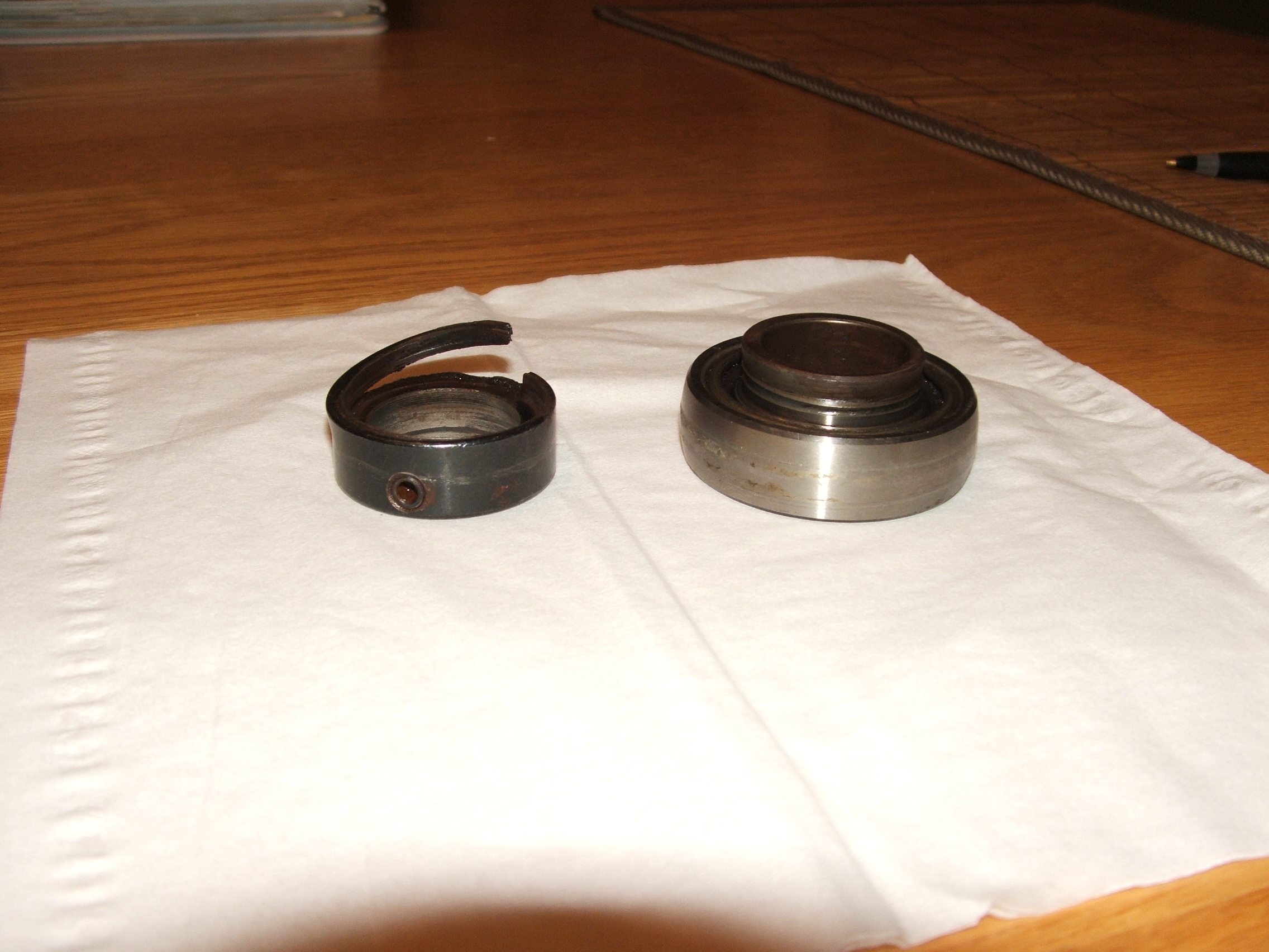

Have any one seen this problem before? I read on another post to check the sprocket for loose set screw which make the sprocket slide on the shaft and cause a misalignment. Well to my surprise I notice that the locking collar inside the small sprocket, was loose and split.:mad: It is fairly hard to see or get to it but I manage to get a few pictures. I also notice that one of the two locking collar at each end of the auger was also loose. I bought this blower new last year. What could have cause the collar to split like that?:confused: Any idea?

If the locking collar is locked the wrong way thats what will happen. Some times the lip on the bearing will break also.

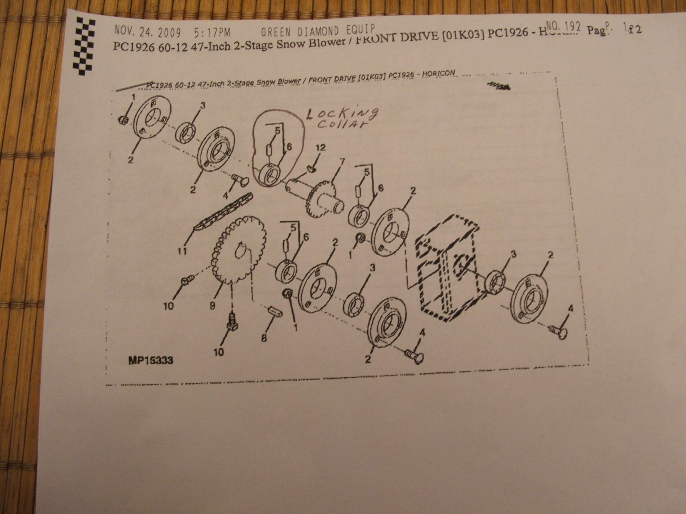

while you go thru the process can you get part numbers and $$$ on bolt #10???
have them triple, doubledog check alignment and the torque on all set screws and bolt #10
In the second picture, the collar seems to be install the right way, but can't be sure. I will look at it tomorrow. Can't wait to find out what cause this to break.:confused: mfreund, your absolutely right, dealers problem.

tkoza, I will try to get that info. for bolts #10. As for the set screws, that what I was doing went I found the problem. I will follow your advice and mention it to the dealer. I have to call them first to find out if they have the parts before I bring it there, they are located 200 miles from here.:( But hey, I wanted a jd.:rolleyes:
Todd, here's what they gave me ''parts # 22h817 set screw 3/8''x 3/4'' $1.76 a piece Can.$$''

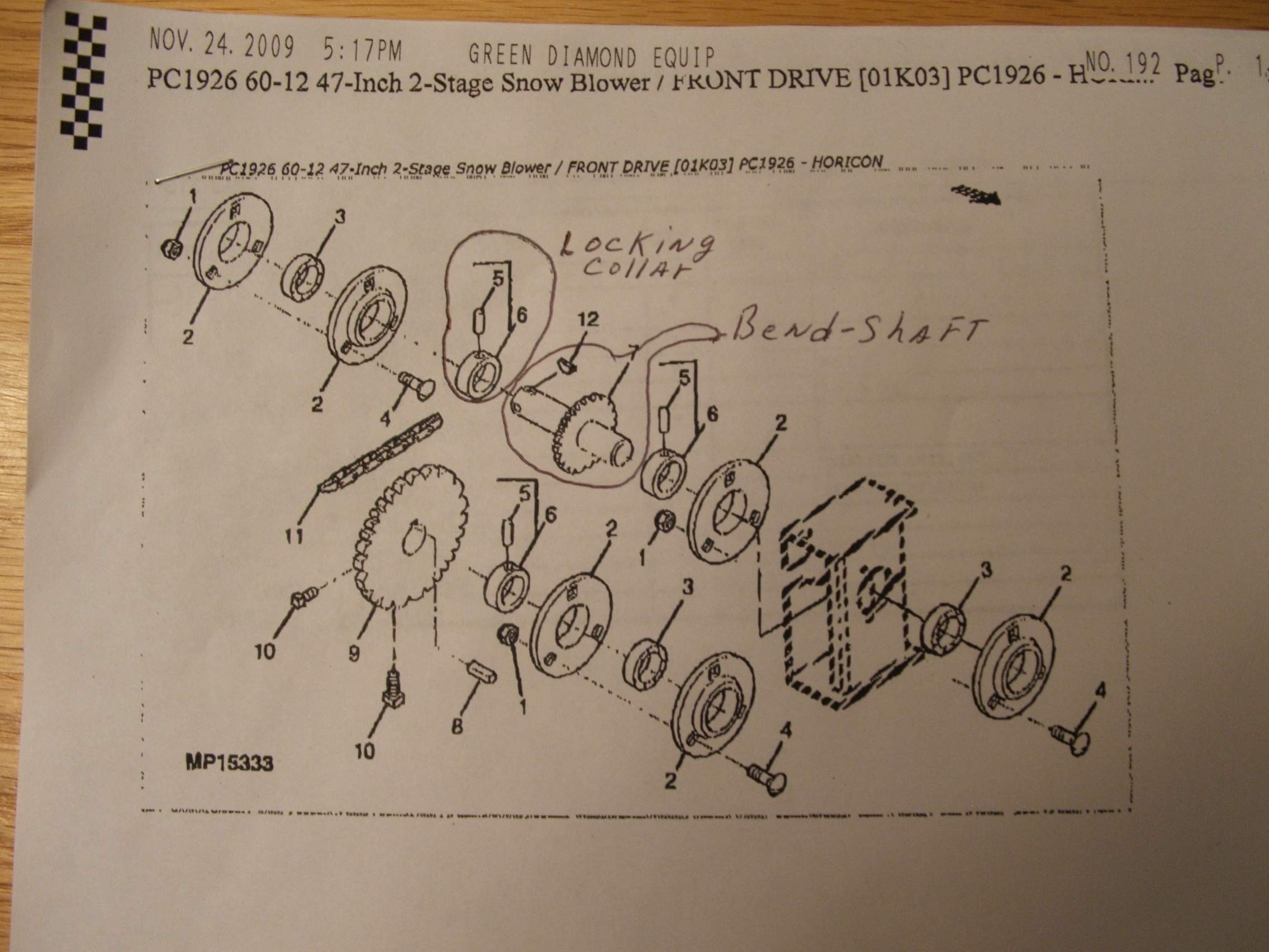

Well, I'm back from the dealer with good news and bad news. The good news is, the broken collar was not cause by a flaws in the design of the blower, ''which I am not surprise since these blowers have been around for a while''. The bad news is ''not that you would really care'' I'm back home without my snowblower.:( The culprit for the broken collar is a bend shaft, the one for the small sprocket. Had to be a defect from the mf cause it is almost impossible to bend it without doing serious damage to the blower. So now I have to wait for the shaft to arrive next week. Hopefully, the retrofit for the pto drive-shaft will have arrived also. It is due for next Friday. I will put pictures as soon as I receive it. Also a quick explanation on how to install the locking collar for peoples like myself that never had to deal with those before:eek: as it was explained to me. The collar actually twist ''screw'' on the bearing. If it is loose, you have to twist it as tight as possible on the end of the bearing, and then using locktite,tight the set screw to lock it in place. Simple, but like I said, I never had to deal with one before. If I missed anything, please, fill in the blanks.:)
More good news... Sounds like a warrenty issue.
