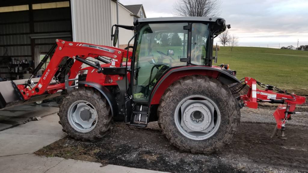

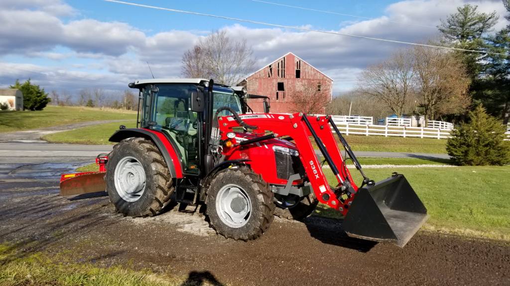

a successful day and fit ok in the barn.
Came with very little fuel, thought I was going to suck my diesel tank dry filling it...;)
No time to fiddle with it, was getting dark.
Sure did ride nice even with filled tires.

Set the auto rpm to 1200. Tire pressure recommended is 23 by my MF dealer on the Trellborgs. Low range shifting on the fly isn't necessary. Shifting on the fly in high range is very smooth
@daugen-
Nice looking machine. I see you have the 931X loader, I'm assuming that's not the self-leveling one, is that correct? Can I ask why you went with that over the self-leveler? And what size bucket is on that? The picture you posted of the front of the machine makes it look smaller than I suspect it is. And finally do you mind sharing what you paid for it? I know Bigpuddie got a great deal on his. If I'd known they could be had for what he paid I would have given it a long hard look. I'm curious about the going rate these days.
Best of luck with the new machine. It's a beauty! Enjoy.
@daugen-
I got the 936x, self leveling, and it was an additional $900 over the 931x

Congratulations, great looking machine...
thanks guys. I intentionally bought the non self leveling loader because it has a higher lift rating, and I do not do hay.
What I do is raise a man lift up high for trimming trees with a 16 foot power pole and there I really could have used the self leveling.
Kind of shakes the poor guy in the bucket as I try to be smooth, which I'm not. New tractor has much faster hydraulics, need to practice going slowly.

Looking at the tires, the rears look good 2 1/2 to 3 bars on the ground a small amount of sidewall bulge,
the fronts could maybe use a bit more especially when using the loader.
One thing I would think about is a Bolt on cutting edge added to the bucket, the factory edge looks a bit light
for the weight and hp you have. Some of those cutting edges are pretty light duty.

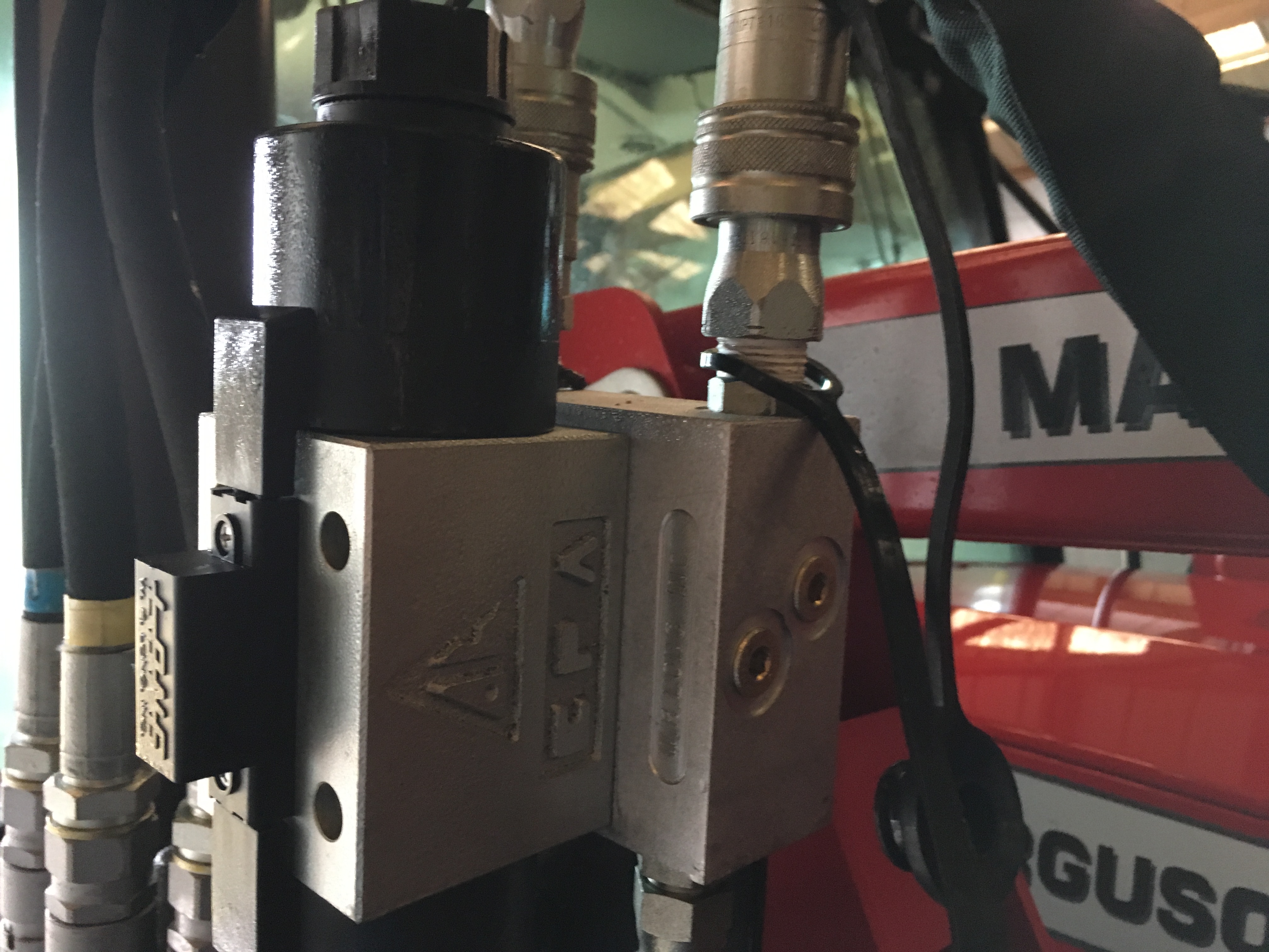

I admit hydraulic ignorance. Could someone explain just what I'm looking at here?
This is the forward hydraulic package, possibly sourced or specified for WR Long, though I don't know why the brand
should make a difference. Of course it meant a new knob on the top of my joystick too. With the rocker button.
It almost looks like there is a motor in there, what are the black parts and what are the silver parts, other than ports?

But first a little more air in the front tires.
I asked dealer to check out recall on my steering and they are.
