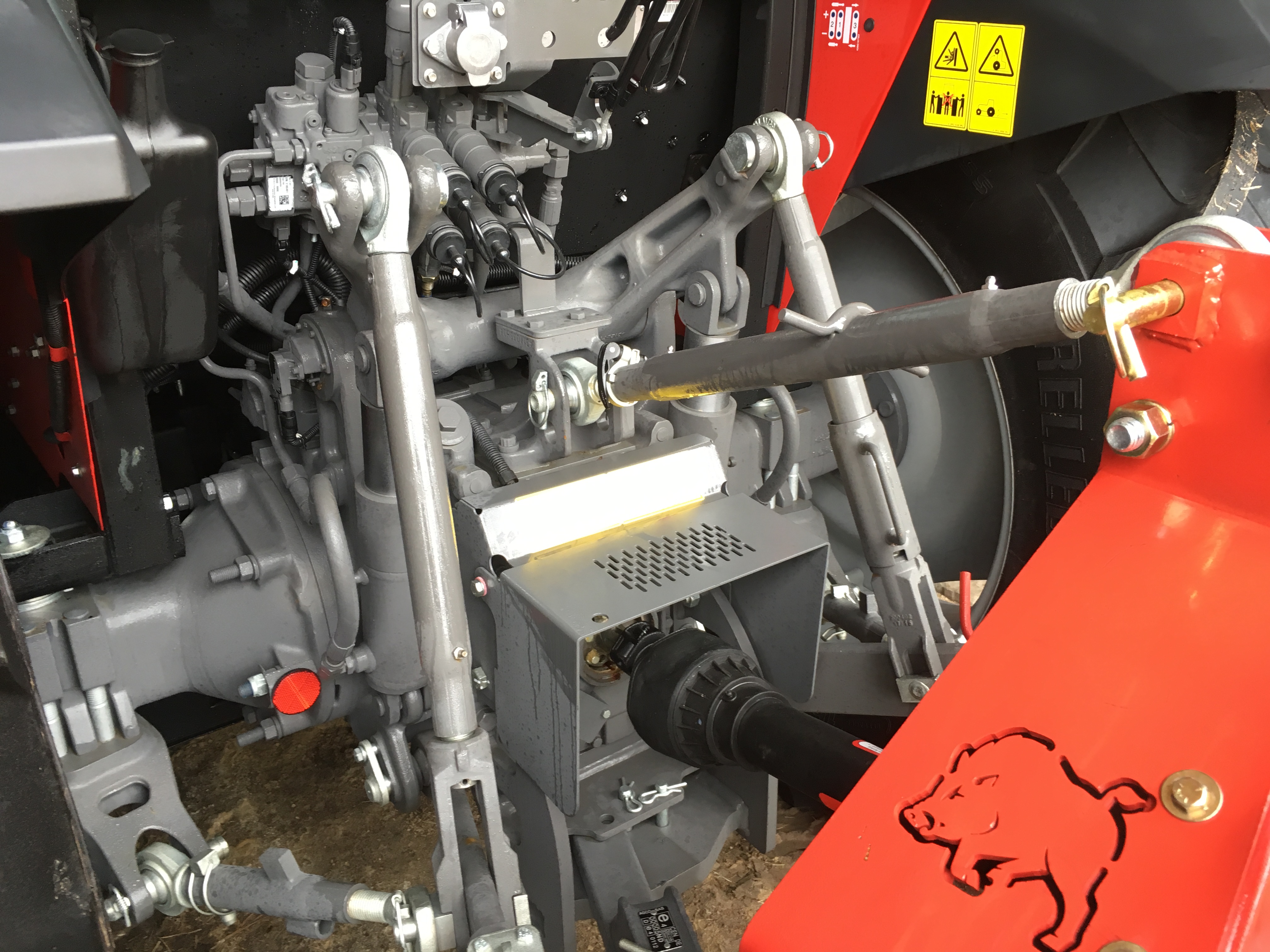

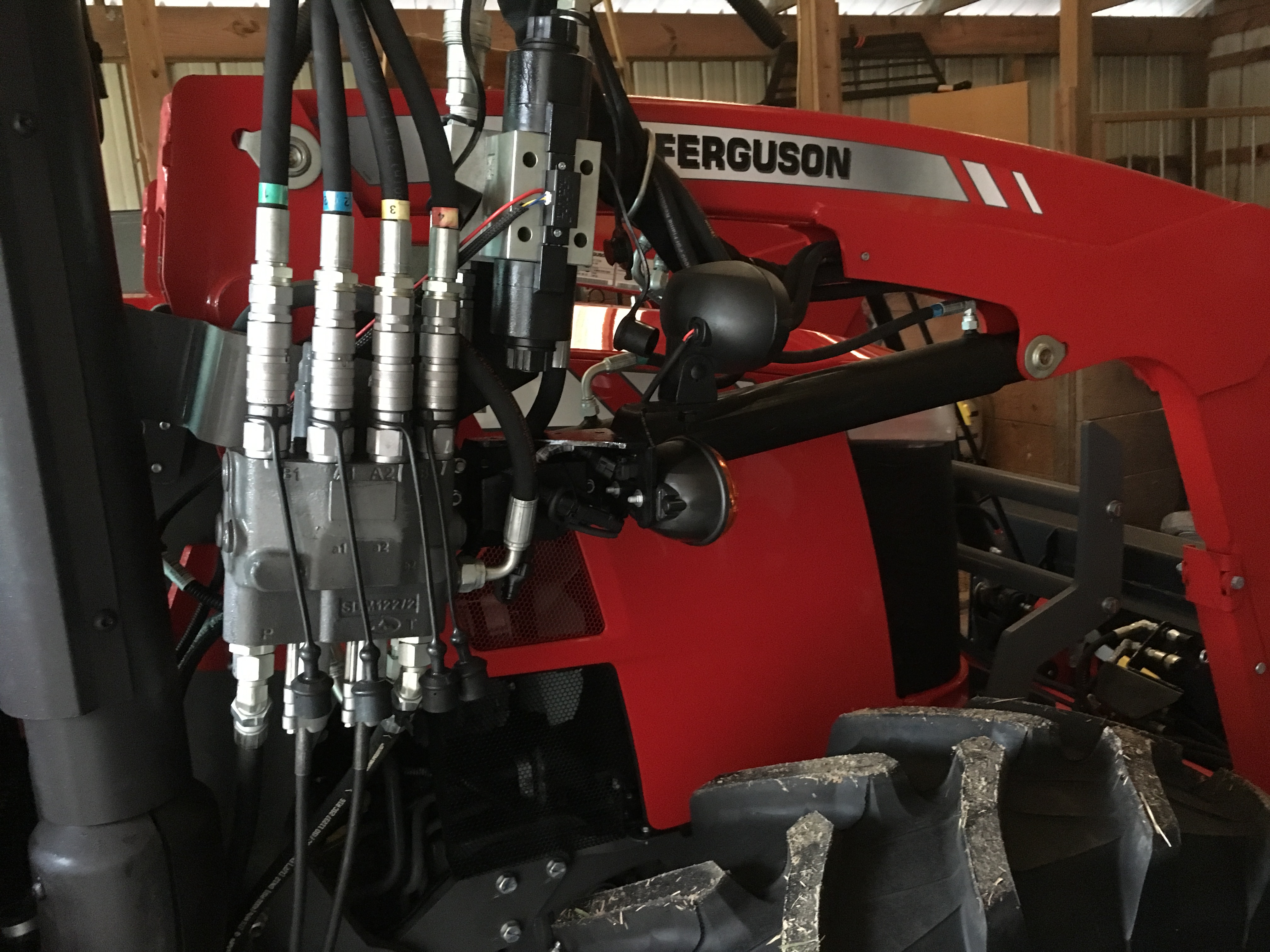

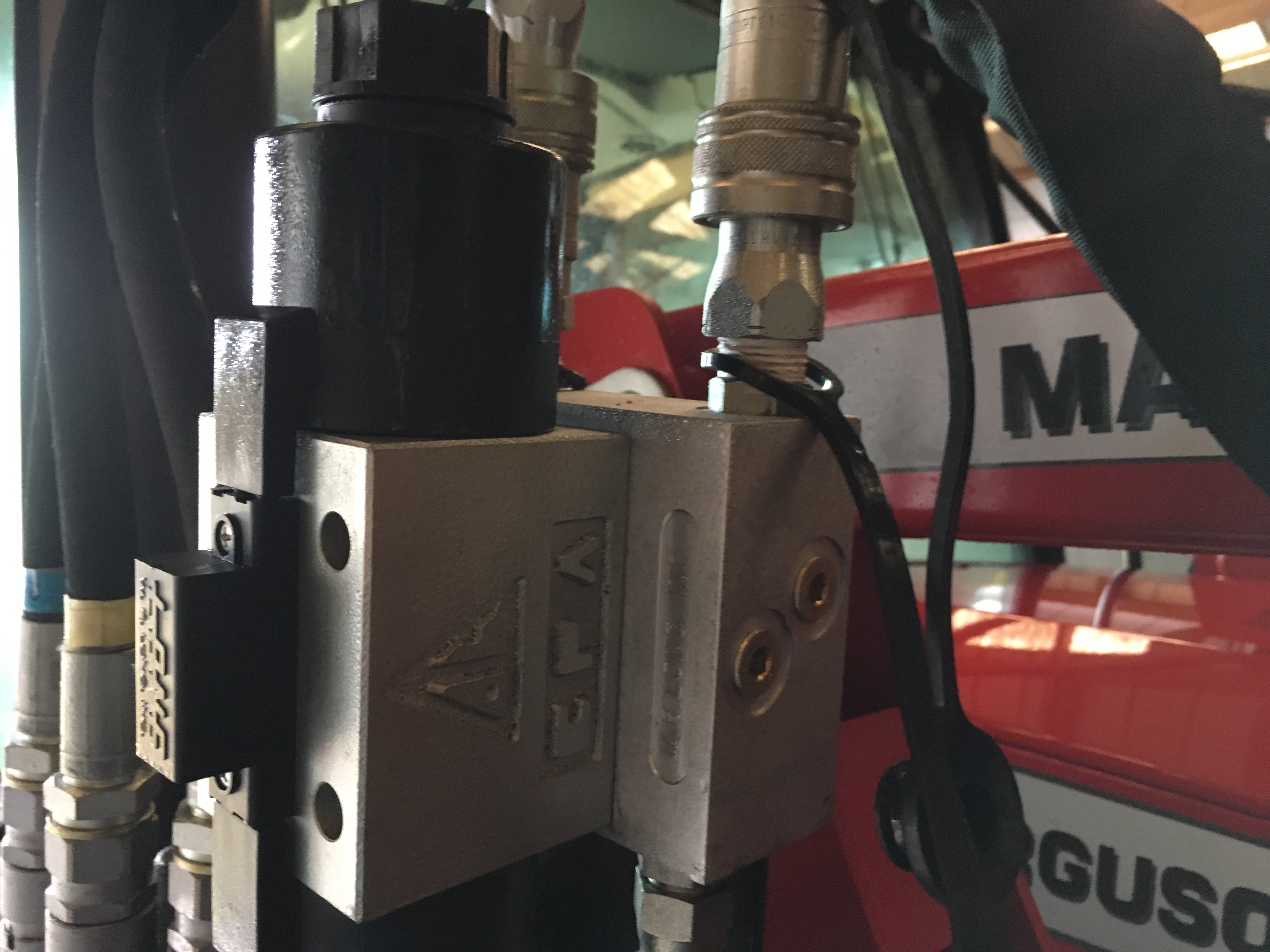

got my tractor back yesterday before the storms come today.
hydraulic top link installed plus rear camera system. Glad they put camera on super strong magnets, not sure why putting the camera off to one side makes sense, I'm moving back to the middle. Thankfully they said they left lots of extra cable inside. This is the least expensive of Agco's three approved camera system. Which I'm sure means I paid twice too much for it, but then they waived the install labor on it so I'm sure not going to complain. They also installed the camera lower in the cab than I would have liked. I have to fuss with it to get it dialed in. Camera comes with useless remote control with tons of functions that aren't even used. I adjusted one setting, to make it brighter, gosh nice I can do that with a remote control but talk about answering a question no one asked. Completely unnecessary complexity. Maybe it's a guy and his remotes thing...;)

Just curious how easy it is to adjust the hydro top link when hooking up different implements..or do you only use it with certain implements like a box scrape.
this is my second one and I really like having it, particularly with a mix of Cat 1 and 2 implements.
Seems like every implement I would get would need the link adjusted all the way the other way...now I just push a lever.
I haven't gotten the bill on this yet, will be interesting to see what that cylinder costs.
